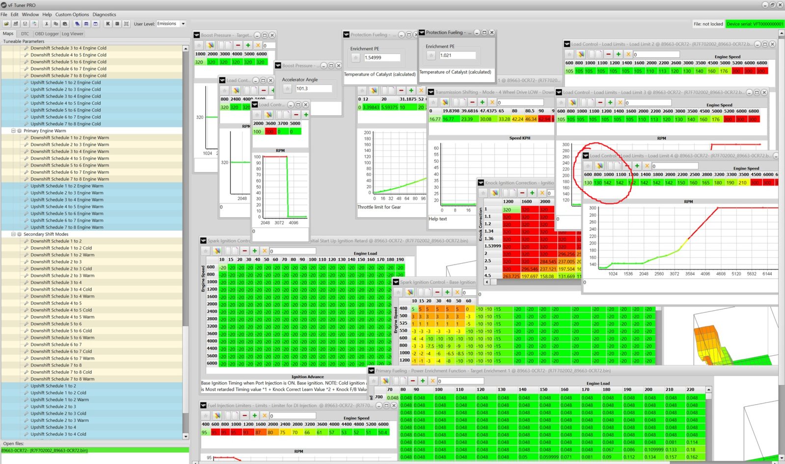

    290
    Northeast PA
    VFTuner seems to be able to look at the Tables for the tundra's now so Hopefully there will be some insights as to what might be going on.
    Some early observations seem to be the logic is VERY complex. Also Its been confirmed that there are MANY cases where throttle/power is severely limited, especially under 3500 RPM.

    Northeast PA
    These "Load Control Tables" caught my eyes on the leaked info. You can see load is limited below 950RPM, which happens to be the rpm's were I see the most throttle limiting, noting also that RPM's getting above 900 RPM or so does seem like an "exit condition" in my data logs. The other load limit tables have very low numbers through mid rpm's as well. But I have no idea what each one represents yet.

    895
    Where did you get this? Load means mass air flow and is represented as a percentage of theoretical max NA flow at sea level from my understanding. So 100% means NA and over 100% means boosted. It’s not surprising to see ~100 at low rpm. I would love to see the other maps.

    Northeast PA
    This was on a vftuner Facebook post. I'm not really a tuner and I don't ever mess with the fueling and timing etc. I have messed a bit with the request tables, throttle limit per gear and shift maps on 3rd gen Tacoma.
    I have a vftuner license so I'm interested in at least looking though all the tables to see if there is any explanation of what might be going on. I did hear from a source that throttle is severely limited in many conditions including downshifts. It could be a simple as making a slight adjustment to the 1st gear downshift to a point that is a better match for my particular diving habit.
    Unfortunately It looks like flashing will require a direct to ECU cable from what I can gather so I'm not sure if DYI tuning of this platform is going to be affordable.

    Northeast PA
    I figured I'd start or add to a different thread when the VFtuner stuff became available to dig into things more. I'm going to try to get the new update next week and then do some new testing to verify if there is any change.
    Mostly I'm pretty happy with the factory calibration except the uneasiness of not knowing if its going to respond consistently at rolling stops.
