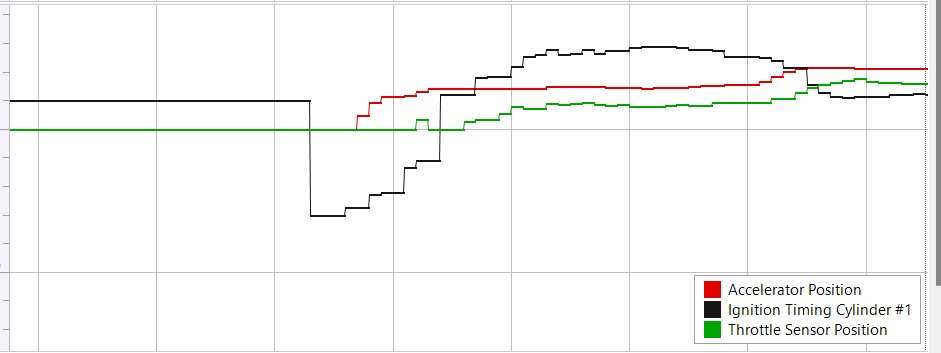

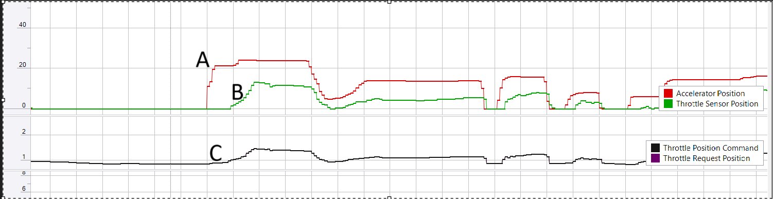

    A little Brain dump:
    I have a good idea of the data pids that are worth while looking at after going though several Toyota and Lexus Tech Tips for various models. They all ask for a similar set of data pids.
    Some other tech info about the PIDS:
    NT Speed Sensor and Output Speed sensor are in 50 rpm increments, its unknow if the ECM/TCM have a more precise rpm reading.
    Vehicle Speed PID is 2 seconds behind actual speed/ speedometer speed. Confirmed in tech doc
    Transmission Solenoid Actuation Pids are only available when doing the test commands only, so its hard to see how its shifting gears.
    The strongest correlation between having the delay and the conditions are as follows:
    Pressing the accelerator less than 1.4 Seconds after a commanded downshift to 1st and the NT speed sensor is 150 rpm and the output speed sensor is 50 rpm. (Its harder than you think to achieve this timing especially with out high speed scan tool)
    According to the tech data I found when a downshift happens the NT speed should increase by 50rpm or more and I don't see that happen when there is delay, however the tech note on the PID said that changes at very low speeds might not show up.
    Pressing the accelerator quickly after a downshift to 1st always yields some delay but it’s usually short and we may be stuck with that.
    The reason for the very log delay vs short delay isn't clear but it may be a few things interacting.
    I have had no such luck determining any conditions that cause the "exit" of the delay besides time elapsing.
    I am not sure if the 2 second delay in vehicle speed to the ECU is a factor or if the deceleration speed is a factor.
    I haven’t looked trans temp as a factor because I didn’t log that consistently in the beginning and I don’t go on many long drives to get it up to temp.
    Its worth testing if you experience the lag in 4H. So far I have not noted it with the snow on the ground but I also didn’t do specific tests with the scan tool to confirm.

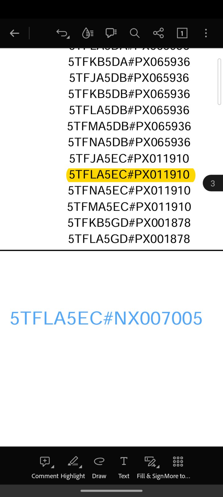

    Sure there happens to be a pretty straight forward process for you:
    Review T-SB-0111-22 here: https://static.nhtsa.gov/odi/tsbs/2022/MC-10230373-9999.pdf
    Compare your vin number is lower than the vin numbers listed there you know you did not have the update.
    Specifically Mention the TSB to the service department and request they give you a Health Check Printout. The Health check will list all the calibrations and if there are any updates. The thing make it easy for the tech, they can even click on the update and it tells them what is fixed.
    Unfortunately Toyota has some outdated polices on calibration updates, and confusing documentation. There isn't a lot of value because the warranty claim is peanuts for the dealership so for some reasons a portion of them are stubborn and wont update stuff by request.

    Correct "N" is 2022 MY and "P" is 2023 MY
    Also if you have a very early 2022 there was an ECU recall, if you got that update you might have inadvertently got the newer calibration with that. Again the Dealer can just check by hooking up GTS and doing a health check.
    Some cheaper scan tools can read the CAL ID's you could try to check there, I think its under mode $9.
