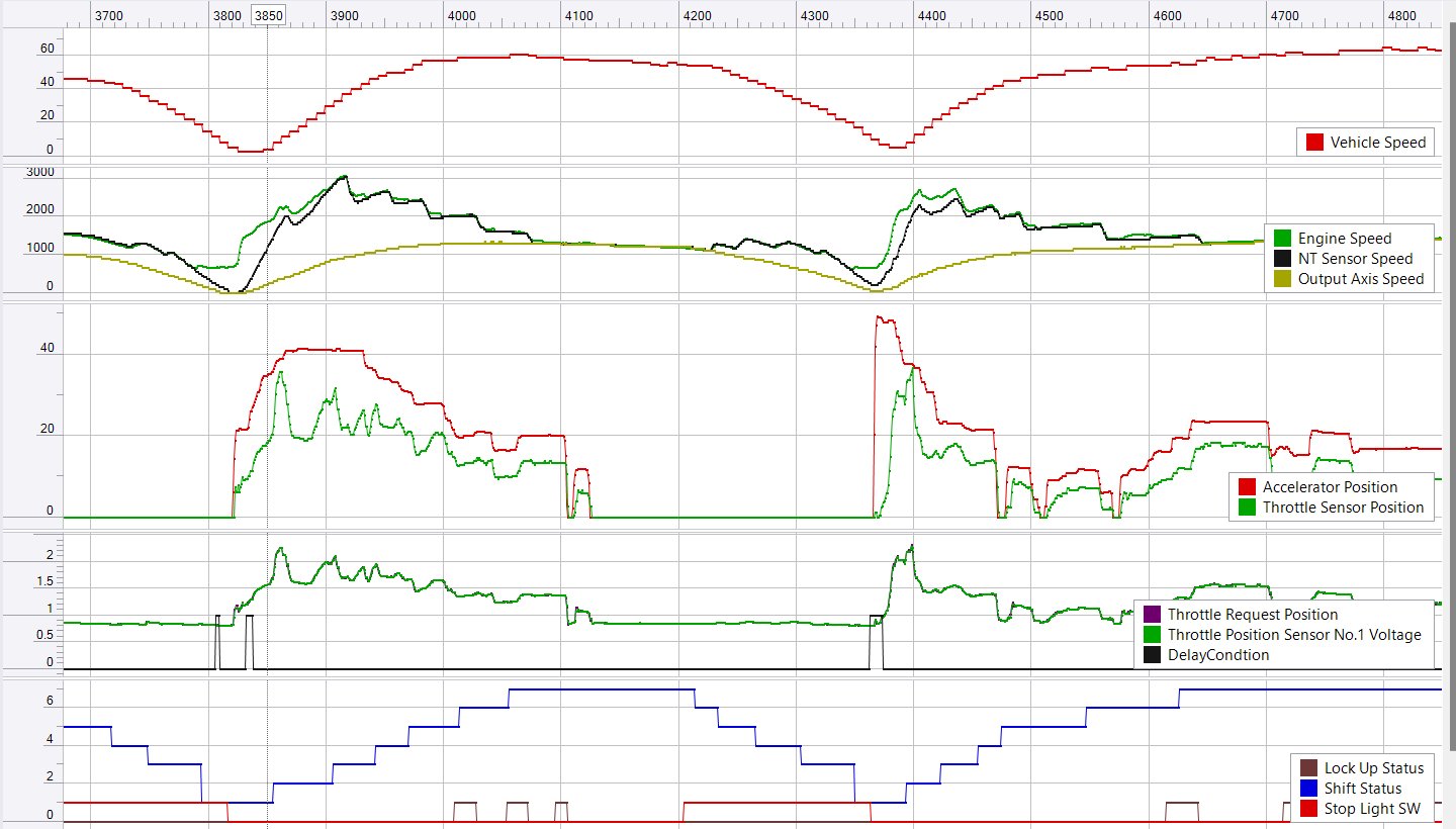

    rlc177 Data Logger
    Jan 2, 2023
    #89650
    290
    Northeast PA
    I ordered a more affordable J2534 interface for testing that should work similar to the tatrix openport 2.0. If that works out I will write a guide on how to do your own logging in a new thread. Probably be a week or two.
    Jthawks, Mattedfred and Kap1 like this.

    rlc177
    rlc177 Data Logger
    Jan 2, 2023
    #89650
    290
    Northeast PA
    Hi a few updates:
    Low cost J2534 adapter dead end. The Cheap Mini VCI cables have 2 issues, the software is really shady, i think because they include a techstream key generator that sets off the virus programs. Even using a air gapped pc though the VCI interface seems to slow to properly work with the new vehicles. Taxtrix Open Port 2.0 is about 10 times faster. For logging stuff like this you really need multiple samples per second.
    Narrowing in on some theory's.
    I believe the issue is related to a downshift to first gear that happens when slowing down. It seems like the shift is always too early, but regardless it seems to take a lot of time to complete the downshift. There seems to be a window where the shift might be in progress. Its also possible this downshift time improves as the transmission warms up.
    What I see in my data:
    Downshift 3 -> 1 there is about a 1.2-1.4 second time to complete this shift
    Downshift 2 -> 1 there is about a 1.5-1.9 second time to complete this shift
    In both cases I say the shift is early, because the NT speed is too low relative to the output shaft speed to match 1st gear 4.92 ratio. It should wait for the output speed to get lower so that it can match the speed better.
    Since the 2 to 1 has a much longer time than 3 to 1 for some reason, its more likely to see a big delay doing low speed maneuvers.
    I think most users probably won't notice the delay due to cadence. The timing of the downshift isn't something the user will feel or know happened.
    Also at least one drive I wound up pressing the accelerator very shortly after the downshift and it looks like from the data, the downshift actually got "cancelled" and there was no lag.
    Also in my "tale of two stops" below the stop that had no lag, the accelerator was pressed about 1.7 seconds after the 3-1 downshift occurred, but the one that had a delay the accelerator was pressed about 1.2 seconds after the downshift occurred. Just looking at the graphs is hard to see this subtitle timing thing but when I do the calculations based on the exact sample times i see the difference in timing.
    ryanwgregg, Kap1, Mattedfred and 2 others like this.

    rlc177
    rlc177 Data Logger
    Jan 2, 2023
    #89650
    290
    Northeast PA
    In my experiences the surging is simply a byproduct of the accelerator pressed too far due to lack of response. The ECU is completely in control of throttle during shifts not the accelerator, as to why these downshifts seem to take a lot of time is unknown. I don't know if its too early or too late or if the transmission is waiting for the input and output speeds to align before shifting. Unfortunately exact shift logic is not available via the TCU or ECU data streams.
    This could be the explanation of why tow haul mode specifically feels better. I think tow haul (especially tow+) locks out skipping gears which would eliminate the more common but shorter 3-1 lag.
    Next drives I will focus more on the downshift timing as previously I did not look for that but was focusing on input/output speeds.
    How thread the needle this is, I do the logs on the exact same drive every week and some weeks I never experience a 2-1 downshift because I was driving a bit faster, or had to make complete stops or waited the .2 more seconds before pressing the pedal.
    alex17117, ryanwgregg and Mattedfred like this.

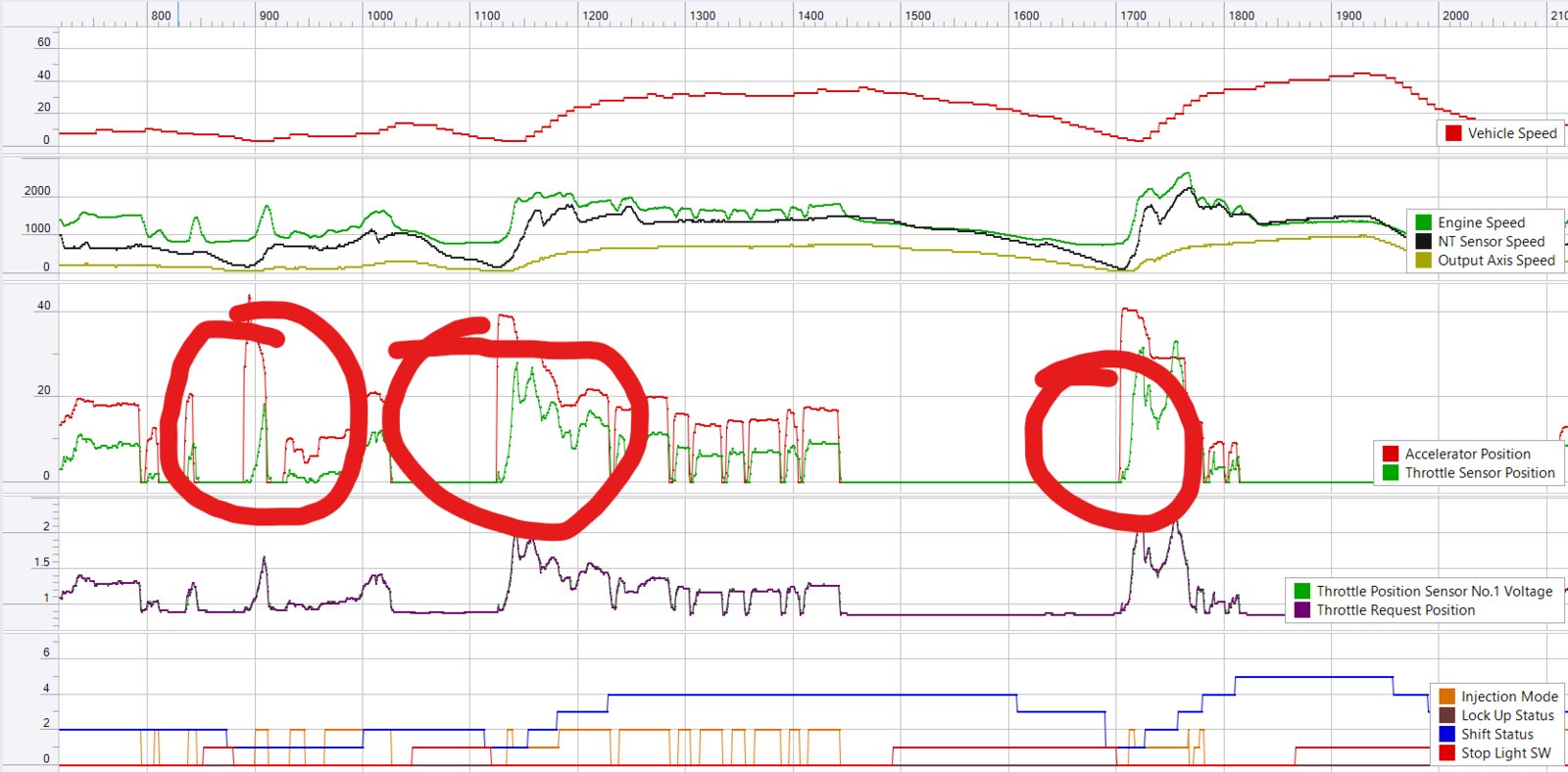

    rlc177
    rlc177 Data Logger
    Jan 2, 2023
    #89650
    290
    Northeast PA
    Got it to do the short delay 3 times in a row by watching for the downshift, but my reaction time was really slow still something like a full second before I press the accelerator due to trying to look at the laptop and drive at the same time. As far as the "long" delay it might have to be a really specific speed (Input/output/vehicle) to make that happen. I was not able to match those exact speeds where the long one happened on a previous drive.
    So it may be possible to replicate on demand if you have shift status in front of your face.
    Mattedfred likes this.

    rlc177
    rlc177 Data Logger
    Jan 2, 2023
    #89650
    290
    Northeast PA
    Not directly, but I can get the TAS Case updated when I go back for service but I didn't want to run down just for this and I'm trying to line it up with other work (key fob+recall) work.
  11. Oct 14, 2023 at 6:48 AM
