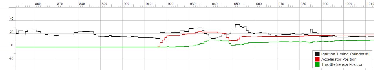

    I've looked over data from about 25 different drives with the condition happening in several of them.
    I've not narrowed down a magic formula but I see a similar delay in throttle response happen in other conditions while moving but it not being noticeable by me.
    What I do typically see is that the next sample after pressing the accelerator the Throttle is commanded a little bit then goes back to zero for several samples usually 250 to 750 ms and then responds normally.
    What I can say it doesn't look like a lack of response but looks like the ECU is severely limiting power because throughout the delay portion the RPM's rise very slowly.
    I think I found that anyone should be able to see the delay by bringing up the "ECO Coach" (Green Eco Bar thingy)
    If those that have the lag occur can see if they see a similar behavior on the ECO coach bar where when pressing the accelerator the eco bar doesn't respond then suddenly jumps up to where you would expect. When it behaves normally the eco bar responds exactly in tune with your pedal input, when the problem happens it does not.
    The annoying factor is that its seems like you are stuck in a condition and you have to wait for the response to happen and hold the pedal constant otherwise you spin the tires when it finally responds.

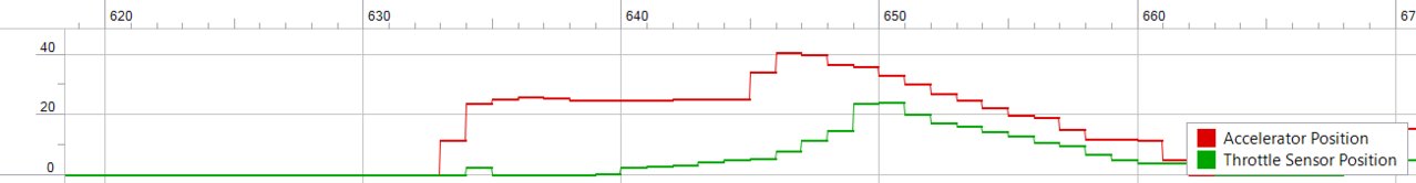

    This is a clear example of dead pedal event I captured most recently but don't have all the pids. At idle the duty ratio to the Throttle at the time was 17.2% so I subtracted that from the duty ratio pid. We can see that the ECU is commanding more throttle but its not quite moving as shown by the Throttle Sensor or the Throttle Position PID's Had the throttle moved a slight bit here there wouldn't have been a dead pedal feel. I'm missing the actual voltage sensor pid and the close and open duty pids to understand fully how the throttle is being commanded but I think its clear something weird happened here.

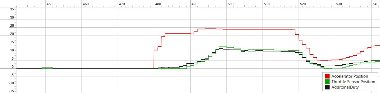

    I feel like this figure is a perfect representation of what I'm feeling.

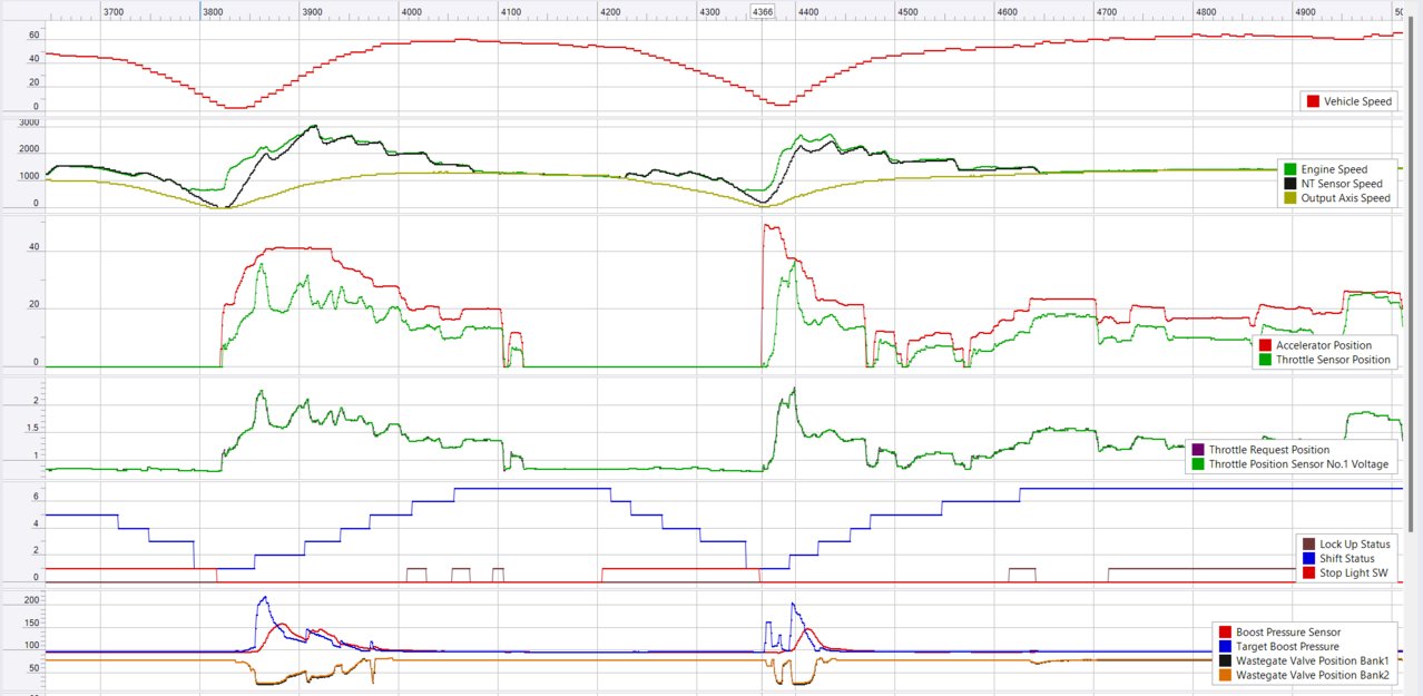

    Here is a tale of 2 stops, the 2nd one had lag but not a really long duration. I happened to punch it a little harder because i had a feeling it was going to lag. VSC and TRAC were disabled on this drive to ensure nothing with traction control was the problem. The delay measured was about 375ms, although the throttle ramp up after the delay was also slower.
    The thing that seems to be most consistent is the Input shaft speed (NT SPEED SENSOR) being 150 rpm or greater, and the output shaft speed registering 50 rpm. Just after a downshift to 1st gear happened.
    However the exact cause of the delay is not known but its probably not presented in the data pids at all but more likely some commination in the background.
    The data shows that the ECU appears to be commanding the throttle as told, but I suspect its some sort of signal from the TCU to the ECU that the transmission isn't ready yet, but I have no way to know for sure what's happening. The TCU doesn't provide any data on what's going on really besides the gear selected.
