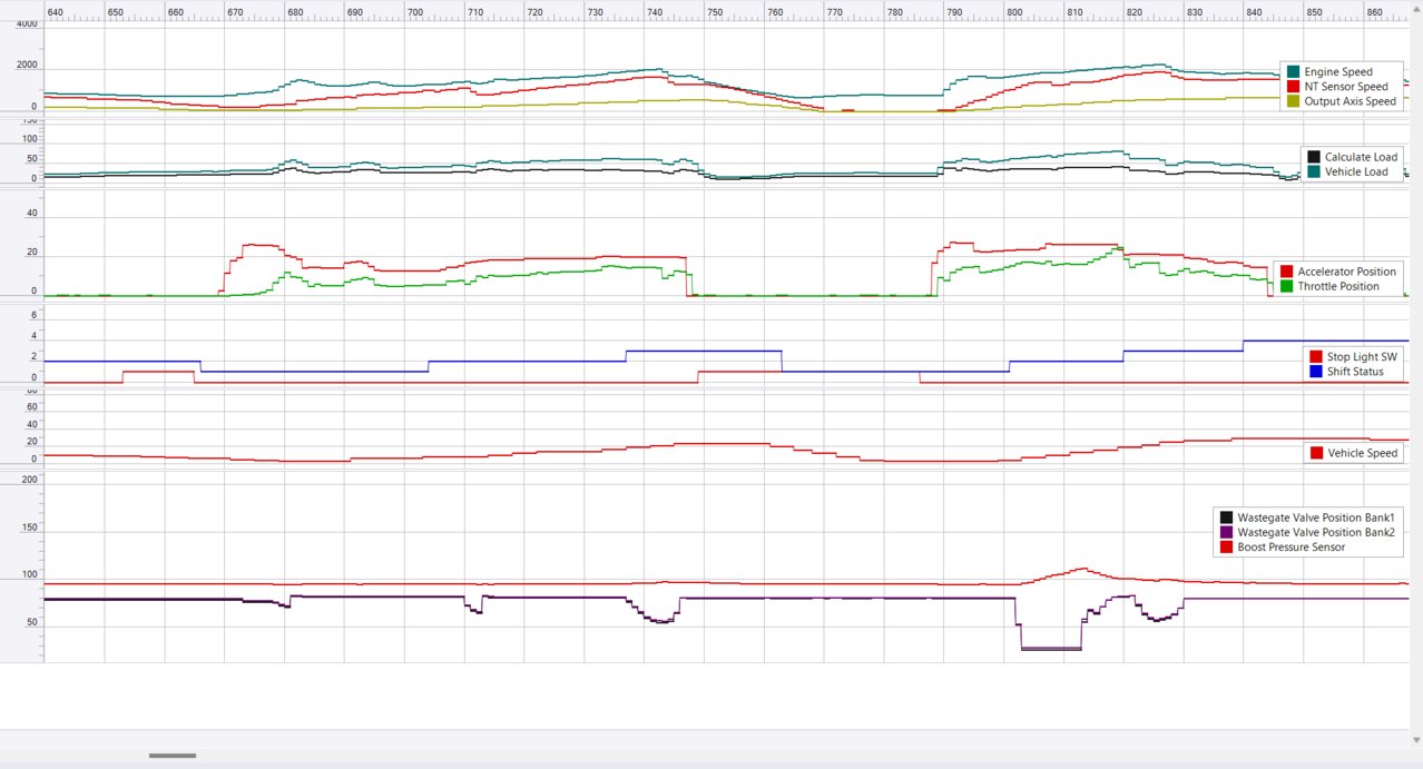

    Here is one I saw with what fell like and logged about a .5-.7 second "delay" Followed by me stopping and then going again that felt 100% normal/perfect.
    I'm noticing when there is delay, the Output speed sensor is non zero even though in both starts the vehicle speed was about 3km/ph(1-2mph)
    It also looks like in the lag situation the load vehicle load is higher also it looks like its first starting to try to close the wastegate but the rpms are two low for any boost to be generated.
    Also being in 2nd and triggering a downshift to 1st seems to be a factor as well, vs being in 1st gear already.

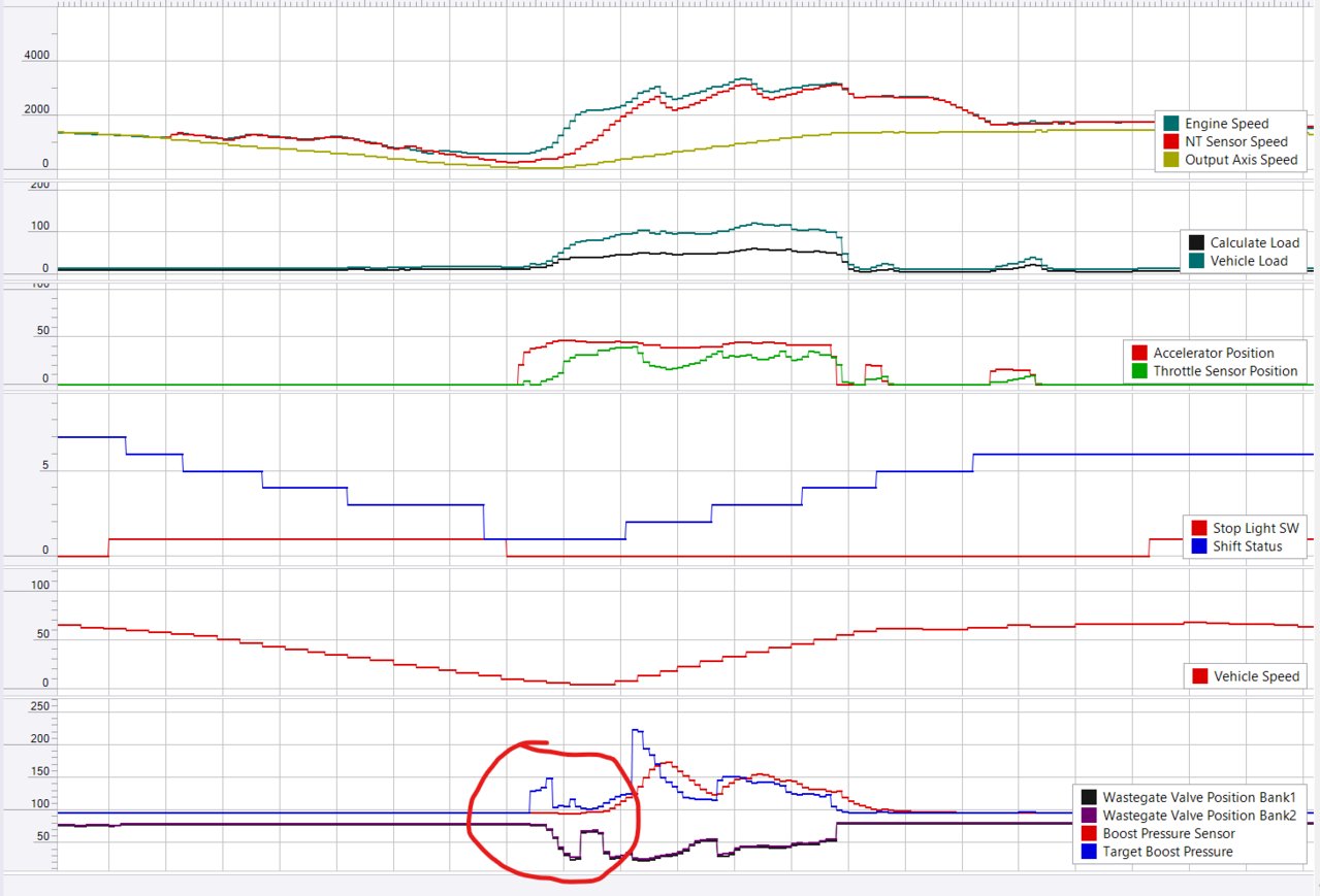

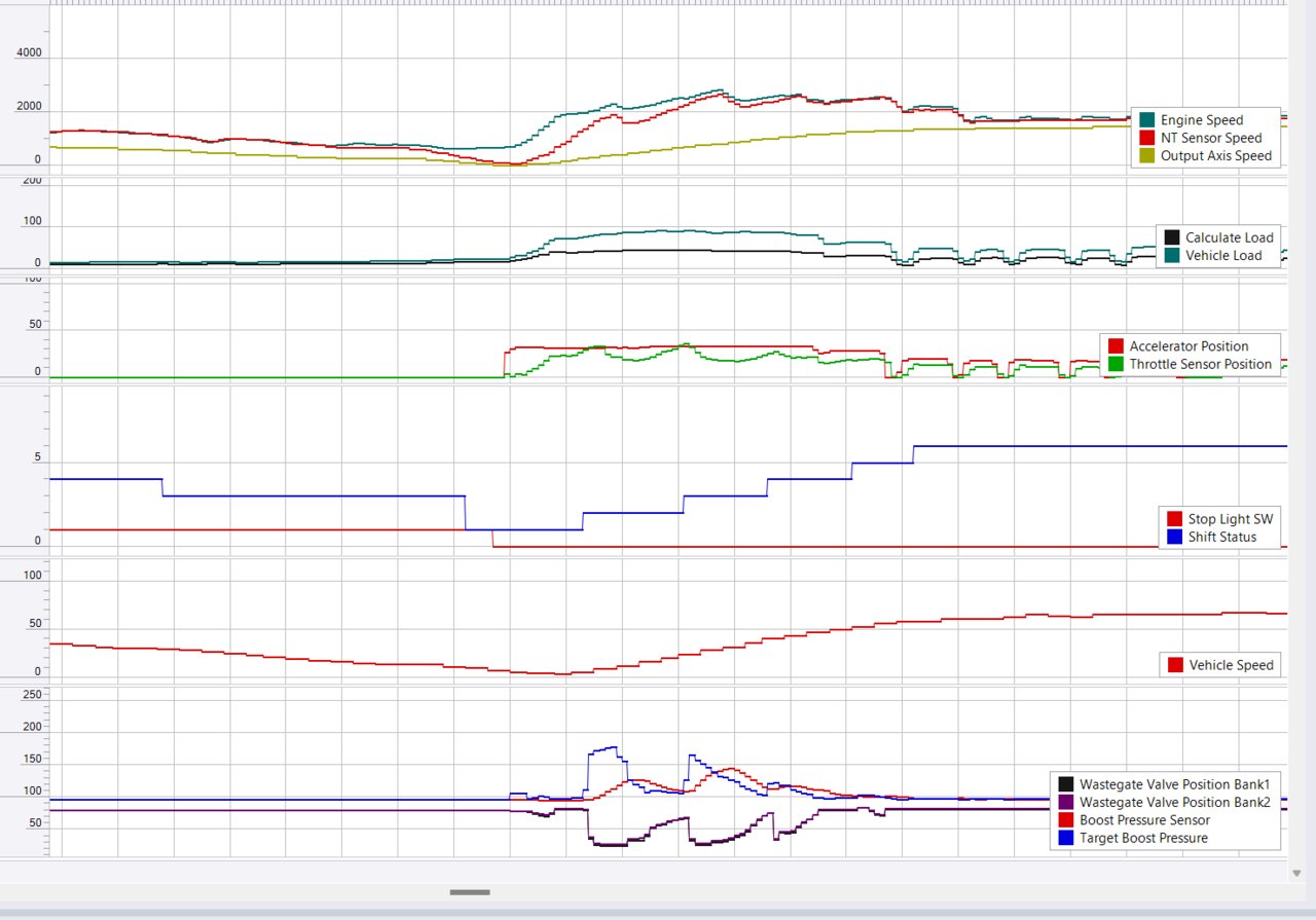

    So Far I've been finding that actually I'm in first gear when the lag happens. The main thing I've been milling though is that the accelerator/throttle data looks very similar for many stop/starts but some feel really laggy.
    I stated logging boost target data. At least the last drive I found that the one specific start that felt laggy, it appears there is a boost target being set at a very low speed. I suspect there's table(s) that define when to add boost or add throttle and there may be a specific bad value somewhere.
    I just need more drives/data now to see if there is a correlation. 2nd Screen shot shows a similar condition but very little boost is targeted initially until the rpms ramp up.

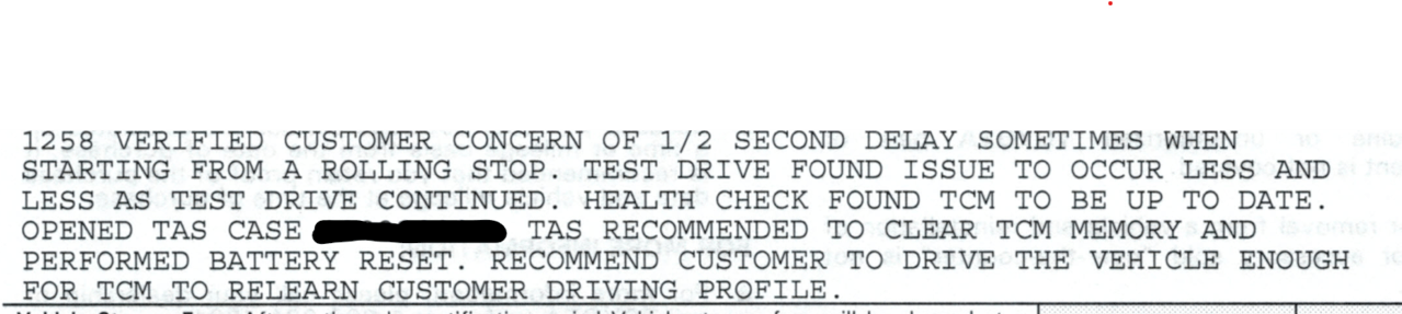

    I was in for service today and brought them all the data, the advisor and tech did spend a considerable time on it. The tech was able to confirm the lag on their test drive. They did open a TAS case. TAS did have them do a TCM reset including having the battery disconnected for 30 minutes. Now that they reset the TCM they want me to drive it for a while to re-learn driving profile
    I am not sure what the exact TCM reset procedure is. They did encourage me to continue logging data and bring more data back to them if it re-occurs to update the TAS case.

    Yeah I'm not confident that the TCM reset is a long term solution unless just something weird goes on and it learned something bad. Regardless I am going to keep logging so that if something does get better or if it gets better and changes I had the data.
    If anything if you take your trunk in for service for the recall at least ask to look at the issue or at least preform the TCM memory reset.
    Generally though this is a positive direction, tech verified the issue and the TAS case is open.

    rlc177 Data Logger
    Jan 2, 2023
    #89650
    290
    Northeast PA

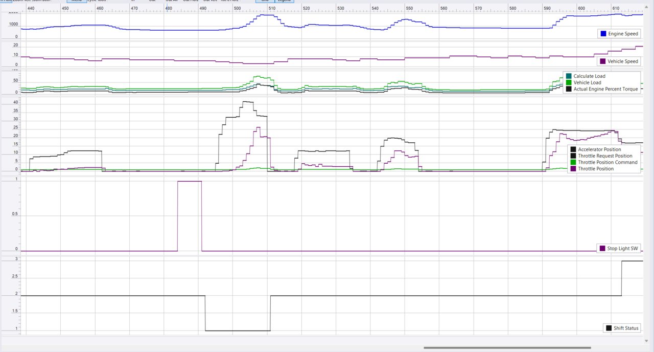

    I'm going to try to start logging data from the Transmission Computer instead of the engine computer. It still seems like the issue seems to revolve around a higher than expected NT (input speed) when applying the throttle.
    I notice that the transmission is logging a of "Large Increase In Engine Speed" Record of Behavior (RoB) events and want to see if this aligns with any lag events. Unfortunately I don't know much about the vehicle control history events, and if these events are normal random stuff or actual problems. They don't set any codes but snapshot data when something "abnormal" happens.
