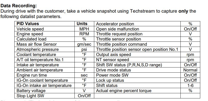

    I got these PIDS from T-TT-0615-20 which was when toyota was trying to fix the 3rd gen tacomas and other 2GR-FKS/6 speed complaints.
    So I will see about being able to log this many in a reliable way.

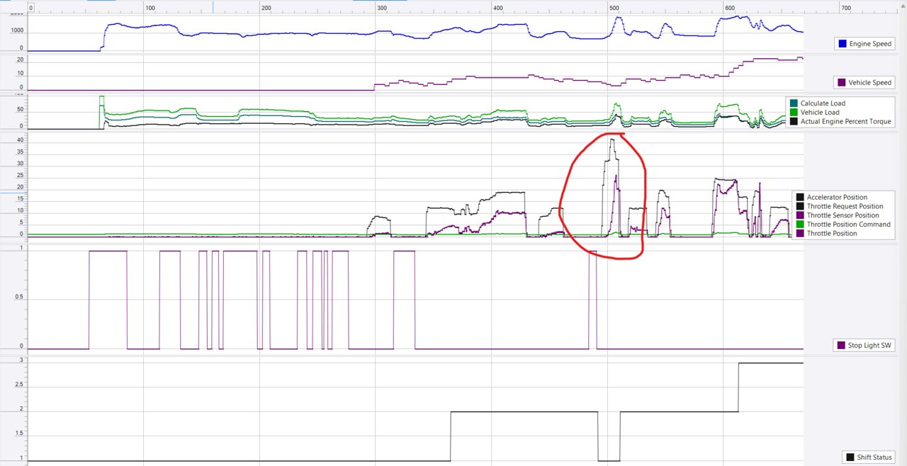

    I was able to capture one of the little hesitations pulling out of the driveway, seems to be correlated with a quick tap on the break and a downshift from 2 to 1. Unfortunately I didn't realize in the techstream logger it default to stop logging after 5 minutes so I didn't capture a full drive with many lowspeed starts to get more correlation. I will fix this on my next drive. I spent all day finding the best tool to line up all the exported data. I'm close to having the system nailed down to consistently log data.

    Here is a zoomed in one, each data point is 125ms. It looks to me typically the throttle is responding within 250ms of an input, so that's why the other one feels weird.

    Wow dude. That freaking awesome. If you don't mind could I send this to my service advisor?

    I'm fine with sharing as long as its clear the data is from my trunk and not your truck, however if it does visualize what you feel then that was one of my goals.
    The current goal is to quantify the lag (how long and what did things look like)
    Hopefully this will actually lead to being able to replicate the issue more consistently on-demand. I think once that happens its a lot easier to get it fixed.
    I actually have 100 different parameters logged though most of them seem irrelevant. I am seeing though the data the the computer is responding to input within 125 ms of a throttle input but in the lag cases its not doing anything substantial for nearly 1 second. For example in the capture lag, The pedal was pressed to a value of 32, but the engine rpm in the following full second only increases by 210 rpm, after which it seems like the truck over responds (partly to increase throttle due to lack of response) causing a quick lift off correction.
