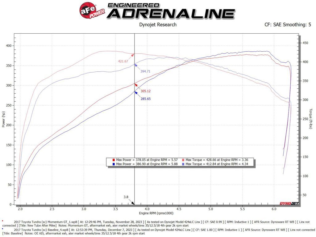

    How does the “intakes don’t do anything” crowd grapple with this:

    I see (sc) in the vehicle description. If that stands for supercharged, I believe it. There is no argument that a bigger intake won’t have benefit on a boosted truck.
    If that’s a N/A truck, I call bullshit on the numbers. Ain’t no way they’re seeing a true 380+ to the wheels, let alone with 35” tires.

    Shit. I didn’t see the “SC.” Kinda wild that these trucks only make that much power supercharged.

    That’s a very tame tune. They’re leaving a huge amount of power on the table…
    For comparison, my N/A 2018 makes about 325hp and 365tq to the wheels with 35” tires. Stock intake, stock exhaust, and HP Tuner file developed on the dyno. Those SC numbers not more than 20% better. That’s pretty poor.
    Back to the topic, an aftermarket intake is not worth it on a N/A truck. It’s all sound.

    On a base pulley I jumped from 325WHP to about 520WHP and that was on the stock fuel map before tuning was available. More like 60%.
    On an NA set up you might be able to pull 20% with the correct headers and catback. I've not seen any NA numbers accounting for intake mods like TB or runner spacers.
