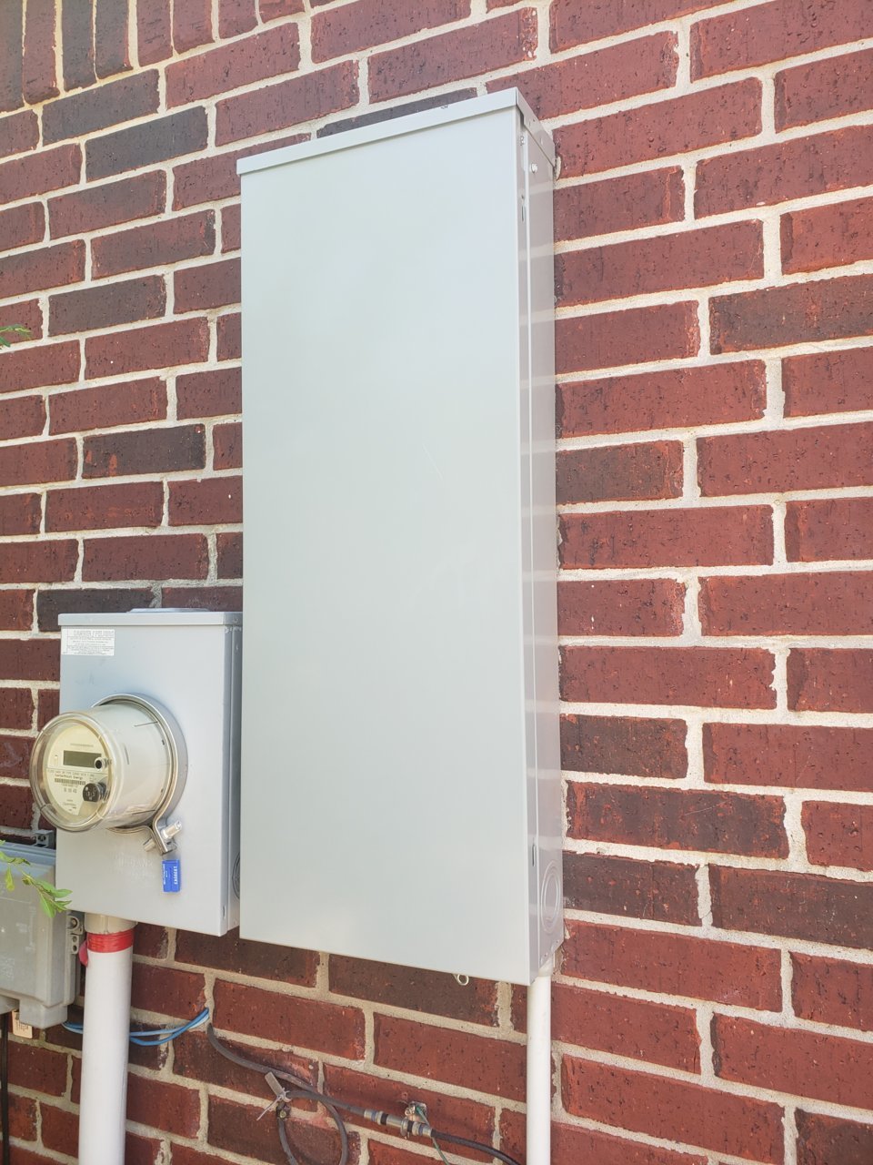

    Electrician crew at house this morning, getting new service panel. Had one circuit out, wires arcing where they entered the panel. Panel was Builder grade aluminum crap, loose breakers, and all kinds of heat evidents.
    They found three more circuits similar to the bad one.
    Sucks spending the money but will sleep better now.

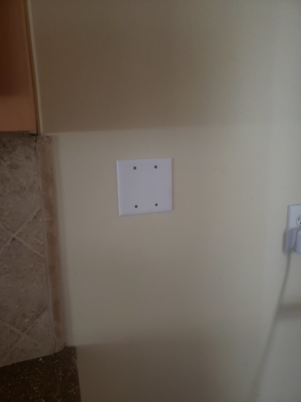

    It's a done deal!
    New copper buss panel with lifetime warranty; parts & Labor.
    New box behind the fridge (opposite side of wall from panel) where 4 circuits were repaired.
    And new copper ground rod to replace the galvanized one.

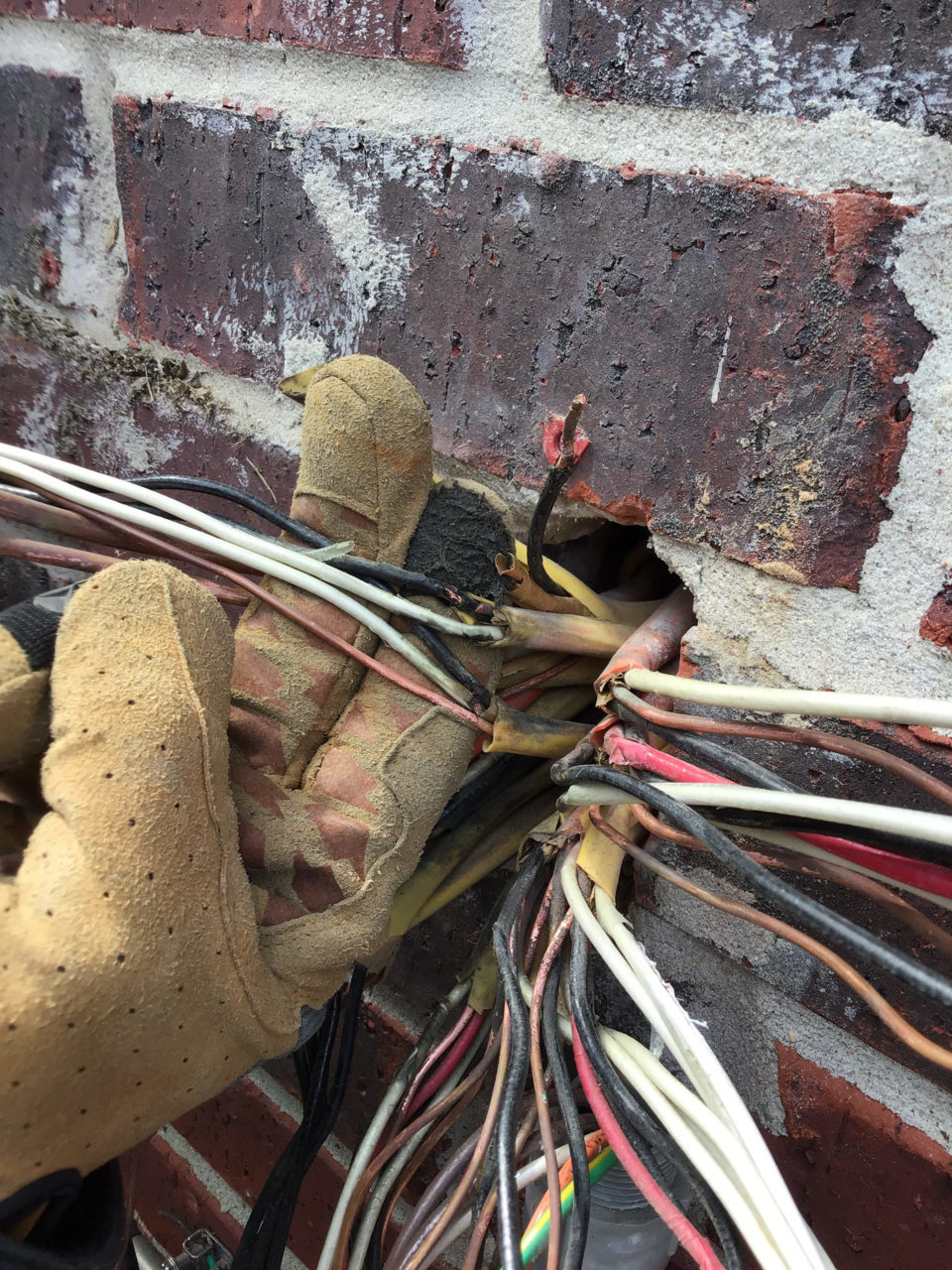

    Edit: wiring that got repaired, evidence of more arcing.

    I believe so, think it's cheaper for builders too. Have been told newer code so that firefighters can easily kill power in an emergency.

    Never seen that before. I'd be afraid of rain or moisture getting in and causing corrosion.

    They are weather rated to keep the rain out. Guessing any heat generated inside drives out any moister.
    There is a locking device on the lower left hand corner to put a lock on for the "hoodlums" out there.

    There are outdoor rated boxes. NEMA has the requirements. I've never seen a main box outside, but I have a 4 circuit box for the pool equipment and shed and a 2 circuit box for the deck outlets. Both are outside.
