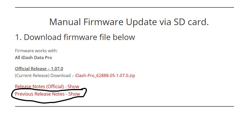

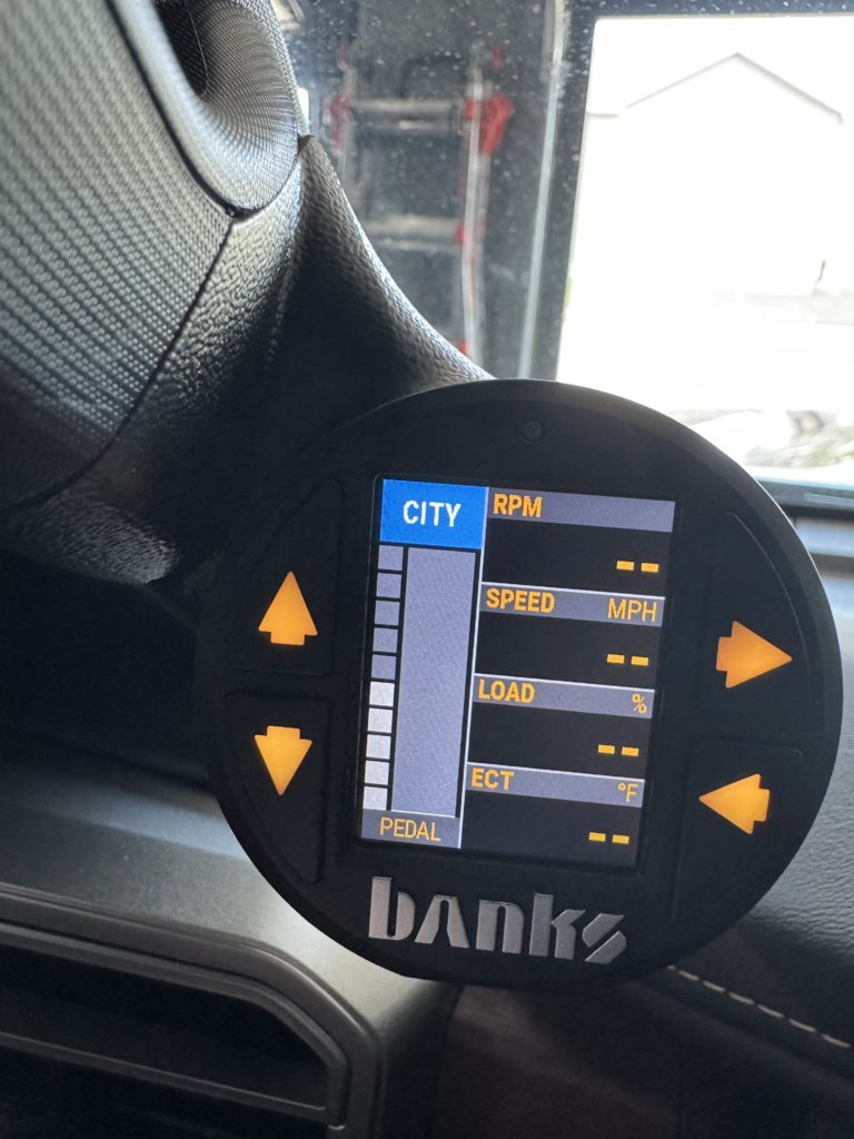

    Has anyone tried the new firmware 1.07 with their iDash Pro? I updated to 1.07 and had no data show up on the gauge, just dashes '--' ...I did remember to switch to TOYOTA. I went back to 1.06 and everything is back to normal. I tried the update via the app and also with an SD card. Couldn't get 1.07 to work.

    Yes, same for me 1.07 and Toyota selected = no data being displayed. I switched vehicle to normal or standard and have data.
    How do you roll back to 1.06?
