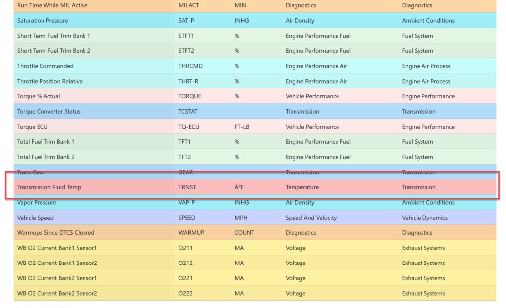

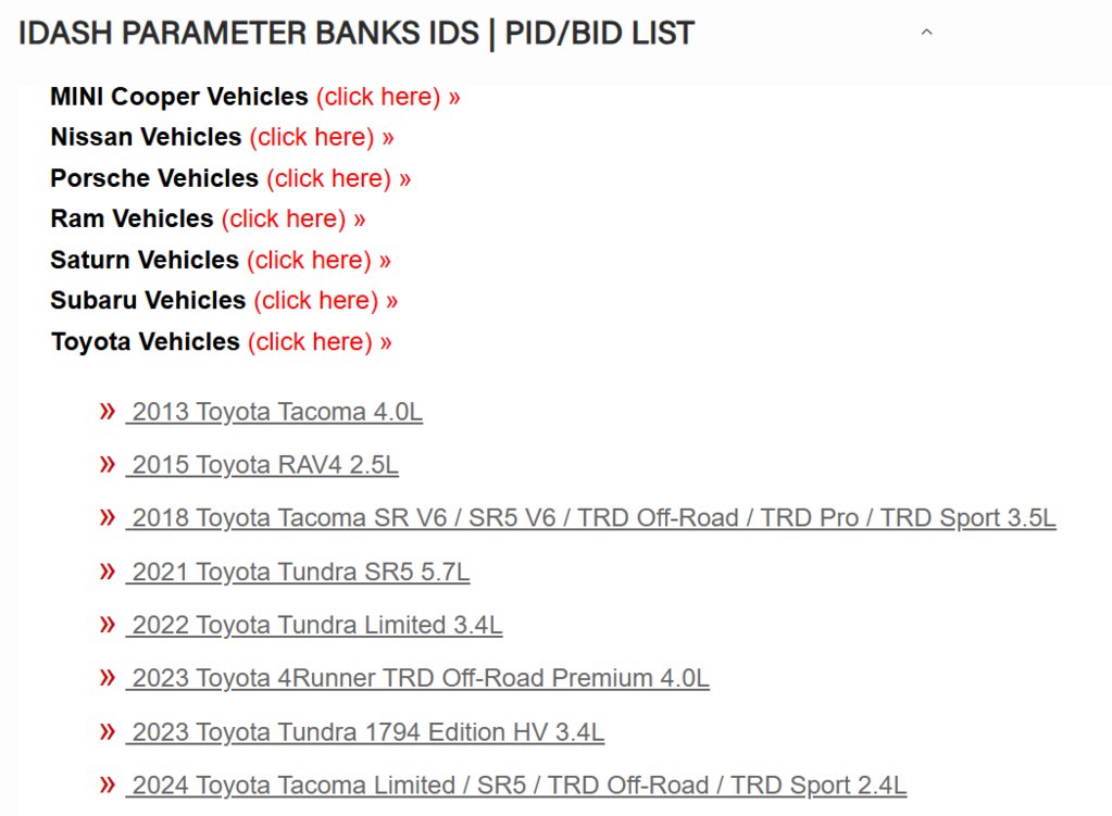

    I think so too, when I talked to Banks tech support yesterday, they stated no new parameters added for 3rd Gen Tundras with iDash Pro. Not only that, but they list different parameters for different trim levels here:
    https://docs.bankspower.com/bids/files/PID_2022_Toyota_Tundra_Limited_3_DOT_4L_V_355_E.html
    https://docs.bankspower.com/bids/files/PID_2023_Toyota_Tundra_1794_Edition_HV_3_DOT_4L_V_354_E.html

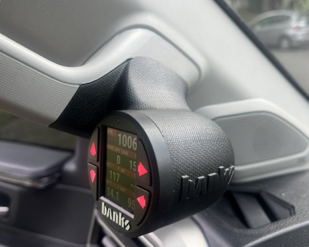

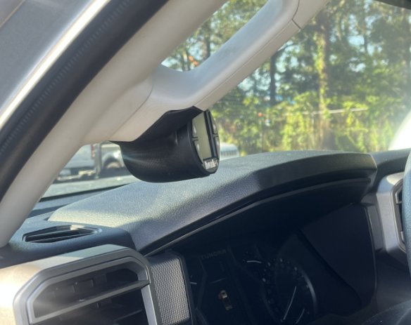

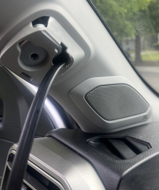

    Ordered my iDash Data Pro & Stealth Pod last Tuesday morning 6/10, and it was at my doorstep Thursday 6/12 when I got home from work. I was able to find some time on Saturday to get it installed and set it up.
    Installation was stupid simple. Overall, I think it took less than 30 minutes. I drilled out the hole a little larger than required with the bit provided in case I add another gauge and mount later.
    I decided against doing any painting of the Stealth Pod for the time being. I’m totally fine with the way it looks now. If it bothers me enough in the future, removing & reinstalling the Pod will be easy. I don’t want to worry about paint chipping or fading, then having to go back and do any touch-ups.

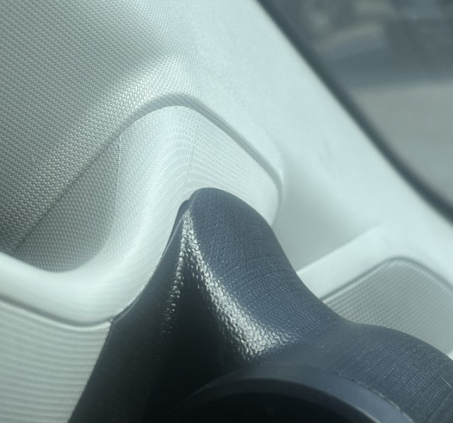

    As far as fitment of the Pod, overall I think it is a pretty good fit. A couple posts on here mentioned the fitment on the door-facing side of the grab handle being off and as you can see, mine is about the same. I thought improper drilling of the hole could be the cause, but I believe that is just how it fits. Personally, it is not enough to bother me, as I don't even notice it while sitting behind the wheel. I also think leaving the Pod black in lieu of painting it reduces visibility of any gaps, because the gap/shadow blends with the Pod.
    On the top/windshield-facing side of the Pod, there is a small flap on the Pod that somewhat extends over the handle where the Pod fits in place. I think if Banks were to incorporate this idea, extending all the way around the pod, it would cover any of the meeting points of the Pod & handle nicely.
    I purchased this so that I could monitor my transmission temperature, but I've come to find out that the iDash doesn't display them. That is my fault because I definitely assumed the device would display data like that, and I didn't ask enough questions or research far enough. I reached out to Banks to see if there are any products on the website that could help add it to the display, but haven't heard back yet.

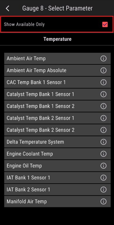

    @LowcountryDave Jay from Banks here. According to both our firmware engineer who worked on the 2022-2025 Tundra, Trans Fluid Temp is indeed displayed on the iDash (See below). Can you confirm your on the latest firmware? The current firmware version is 1.06. You will update using your mobile app or SD card and the file found here. If you are on v1.06 and cannot see Trans Fluid Temp, let me know.
    Regarding the fitment of the iDash Stealth Pod, I've overseen the development of 18 pods so far and none were as difficult as the Tundra. It was very hard to get it to overlap and also fit within the footprint of the factory A-pillar bolt cover. You'll notice some of our pod sits inside the pocket and some sits above the pocket. This is so we could cover the cable access hole. We are as particular as you when it comes to fit and finish and the lip in your photos bugs us. But there was no way around it.

    @ToyFan I see Trans Fluid Temp on mine, what about what exact gear I am in, not just the 'D'.

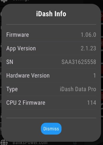

    Hey Jay - I updated the firmware before I set up any of the display:

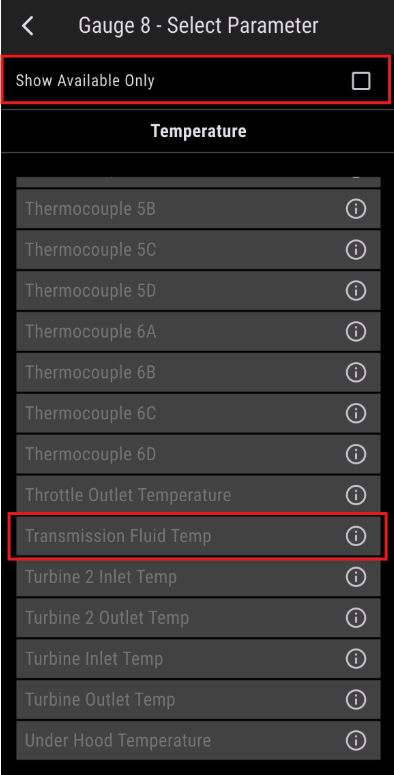

    I've got the display set to eight, maybe it requires a different configuration?

    I had to go in and select Tundra from the vehicle options for it to display trans temp.

    @LowcountryDave First, please ensure that you have selected Tundra from the Vehicle Selection Menu in the mobile app. Without the proper vehicle selection, many vehicle-specific PIDs will not display.
    The number of gauges per page should not matter. However, You can set the iDash Pro to display 2-8 gauge per page. Using the mobile app, you can re-order PIDs on the page. So, you can drag Trans Gear to the first position, second, third, wherever you want. Please see video 11 "Setting Up A Custom Layout" in this playlist of iDash tutorials.
