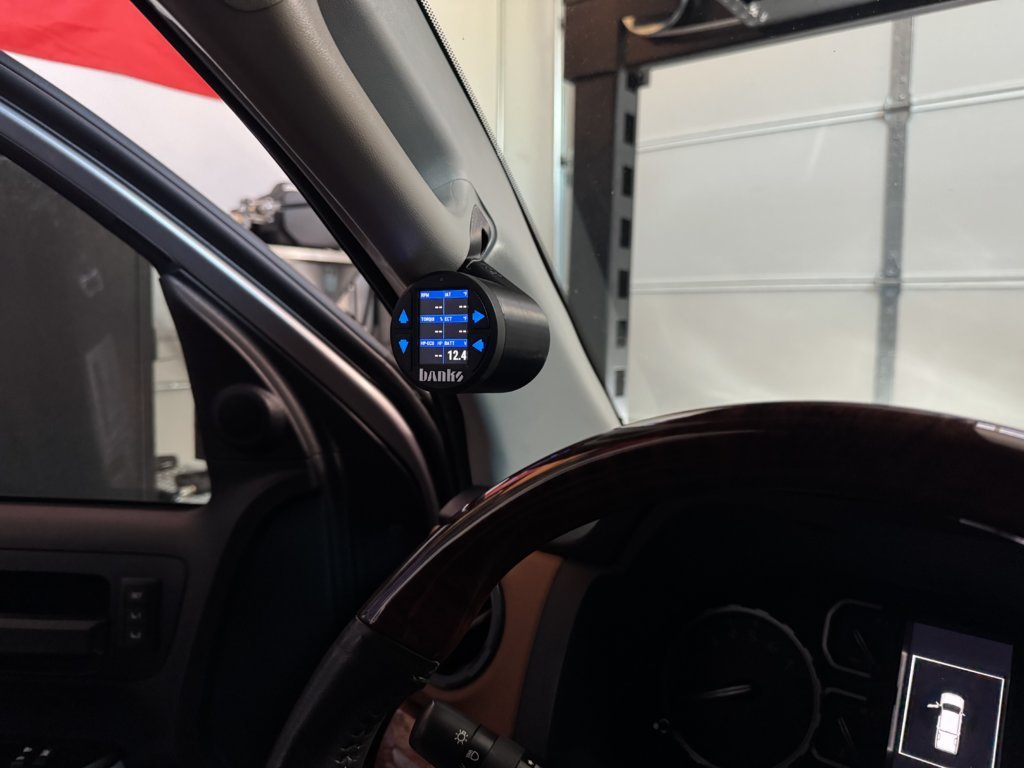

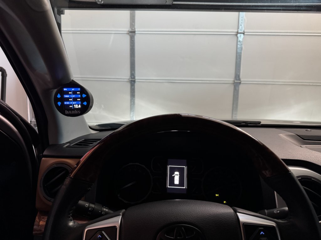

    I got my iDash Pro (w/pedal monster) installed in my 2021 1794! What a badass unit! Really happy with the computer and the custom mount I found on Etsy.
    However, the main reason I bought it was to monitor transmission temperatures when towing my camper. Unfortunately, my iDash is not pulling in the information. It’s showing up greyed out on the app, and not available at all on the iDash. I’ve updated to the latest firmware, synced the Bluetooth, fiddled with every setting (I think lol), I cannot get the transmission data to pull into the iDash. I know it can be done because of this thread. Does anyone have any ideas on what I’m missing?

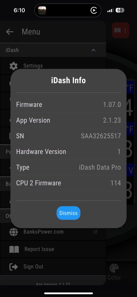

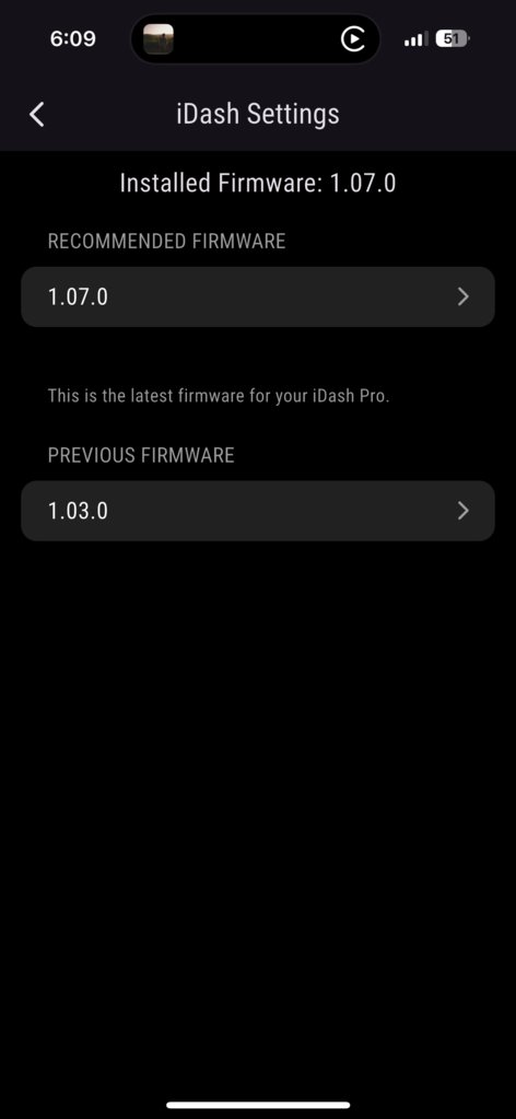

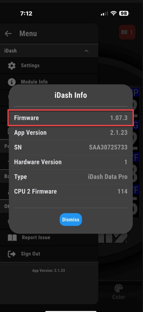

  8. Jul 28, 2025 at 6:27 PM
    #98
    ToyFan
    ToyFan [OP] New Member
    Jul 1, 2021
    #64994
    139
    Jay
    2018 Tundra
    Black Rhino Wheels
    Hey everyone! If you're on iDash Pro firmware version 1.07, I'd like you to update to beta firmware v1.07.3. We've addressed a few bugs like missing PIDs and stability. To try this beta, open the Banks mobile app, open the menu, tap on iDash Info, then long-press the Firmware version. I pop-up will appear asking if you want to update to 1.07.3. After accepting, it will take 5-6 minutes. And, a reminder to update when you have full cell reception and your engine running. You're welcome to drive as you update. Once this update is deemed stable, we'll publish it for all to use.
