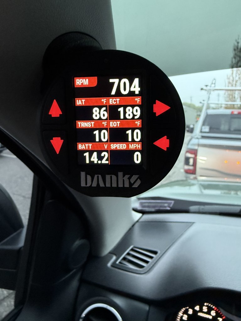

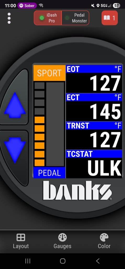

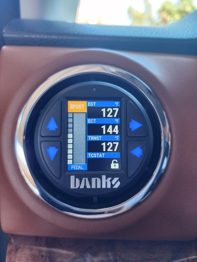

    I noticed that my trans temp(TRNST) and oil temp(EOT) are the same. I see they are as well for @Abell207 gauge as well. Is this expected behavior for these to be the same?
    Abell207[QUOTED] likes this.

    I was also wondering the same thing. Maybe @ToyFan can chime in and help us out on this.
    Fu3lC3ll[QUOTED] likes this.

    Trans temp (TRNST) and oil temp (EOT) should not be the same. Our firmware team is digging into this ASAP.

    They read the same on my unit as well.

    Thank you. We've determined that one of the two PIDs is incorrect. Our firmware team is looking into it. I'm confident we'll get it solved quickly.

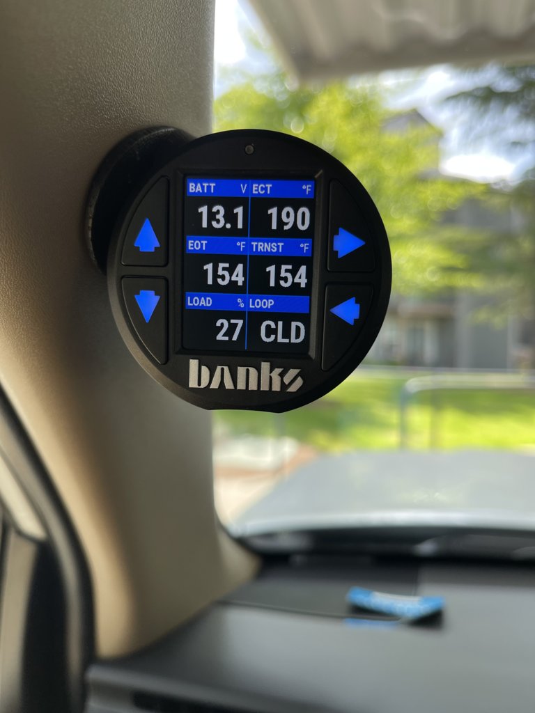

    @ToyFan
    The SuperGauge for LOOP would show OPN, CLD for loop status, the Pro shows 1, 2. Will the Pro have this text mapping in a future update?

    Cris, your timing is perfect. I saw your comment and called Gerson, one of our firmware developers. He will change the text mapping so the 1, 2 will display as OPN, CLD in the next wireless firmware update.

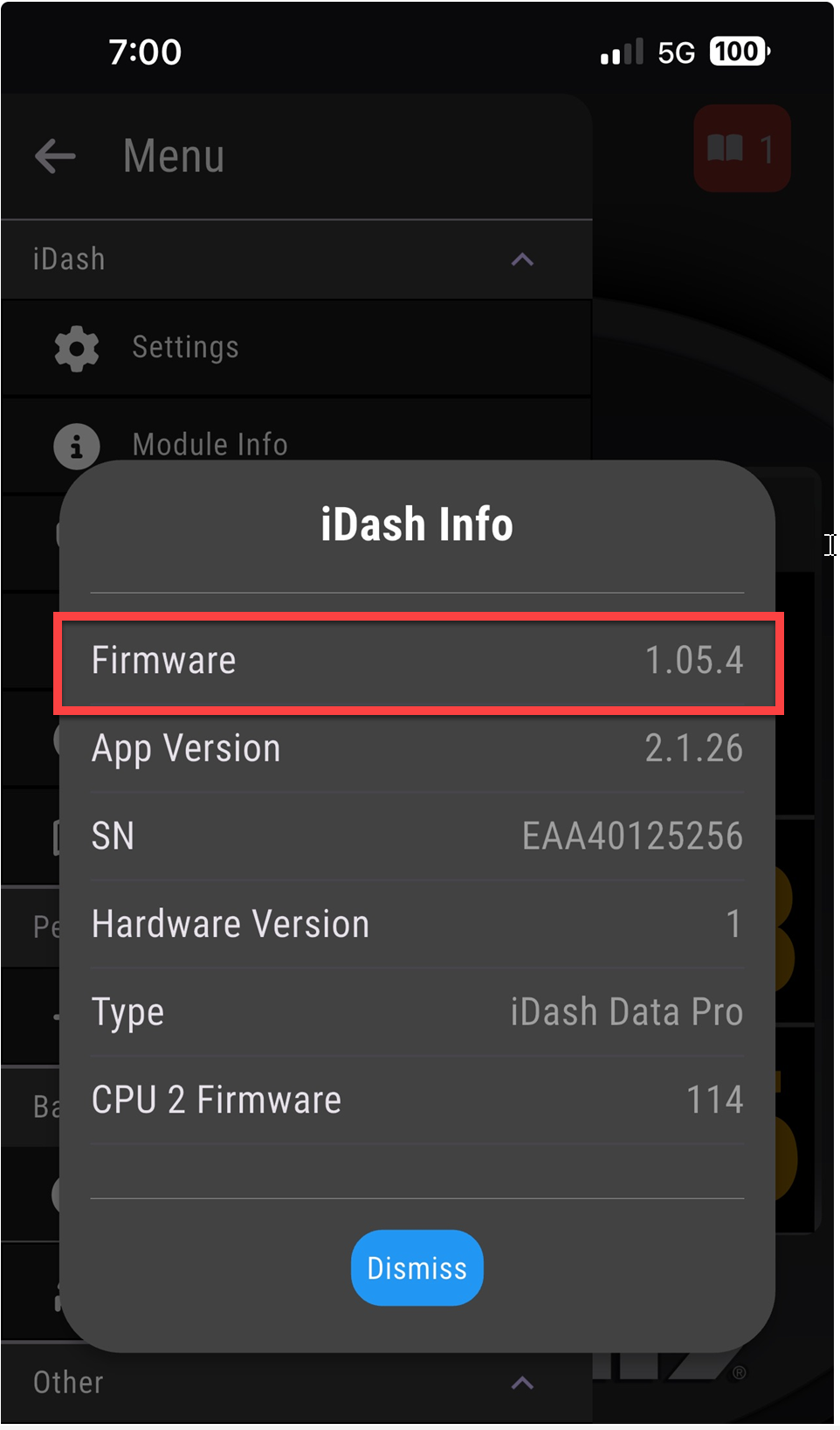

    Thank you for the follow-up. When you have a moment, please update to beta firmware 1.05.5. According to our team, the LOOP status was updated in this versions. It will become public in the next release. To update, using the Banks mobile app, enter the Menu > Module Info. On the iDash Info pop-up, press and hold "Firmware." This is a hidden button. It will prompt you to update to the latest beta firmware. Please let me know if this corrects Loop Status for you.

    I will try this later today. Thank you.

    Updated to 1.05.5 and LOOP status text mapping is working. :thumbsup:

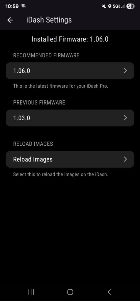

    Fu3lC3ll and JMGmanAZ like this.
  20. May 18, 2025 at 4:10 PM
    #80
    JMGmanAZ
    JMGmanAZ New Member
    Oct 12, 2023
    #105281
    1,339
    Jerry
    Belly of the Beast
    2014 1794
    Updated to 1.05.5 and mine still read the same... :(

    v1.06.0 Release Notes
    (05/15/2025):
    • Formatted PID display as text for clarity (DEF Level Low, Fuel Closed Loop Status)
    • Calculation corrections for various Toyota-specific temperature parameters
    • Independent screen and button brightness settings with auto-dimming
    • Auto button backlight off setting
    • TCC lock status symbol displayed alongside gear PID bug fix
    • Fixed (“+”,”-“) signs getting cropped on some gauge layouts
    • 4-Channel Analog Module Sensor Type bug fix
    • “Scan-Tool detected” pop-up minimization
    • Added support for 2024 GM L5P Derringer
    • User interface and Bluetooth improvements
    • Reliability and robustness improvements
    • Minor bug fixes
  22. May 26, 2025 at 2:21 PM

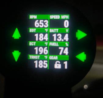

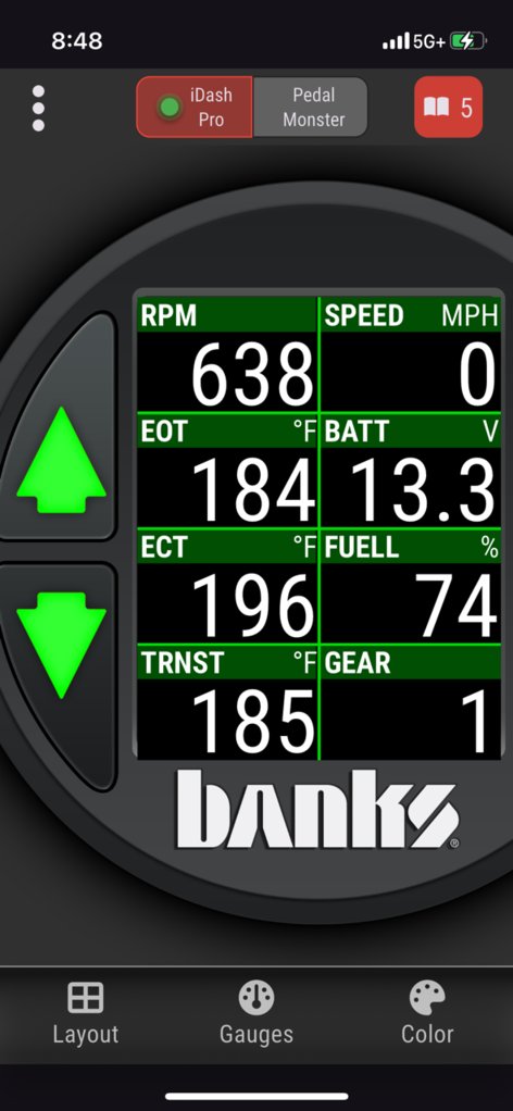

    Can't say that the TRNST/EOT issue has been resolved with 1.06.0. The two are still the same though no longer read just single/double digit values. Here is a pic after around a 30 min drive. EOT and TRNST are the same.

    Yes I also noticed that as well. And I want to say that even the trans temp is wrong, I haven’t verified with HPtuners but my transmission usually is much hotter after 30 minutes of driving.

    A bit of digging on the 4Runner forum and discovered that the 4Runner does not support engine oil temp or engine oil pressure through the OBD2 port. Trans temp is supported and the 154F reported by the iDash appears to be a reasonable value for the type of drive I did taking into consideration the mild ambient temperature.

    They do not have a dedicated trans cooler, only what's available from the radiator.

    I have noticed a 1-2 degree difference between the EOT and TRNST. Maybe they just run close to the same temperatures?
