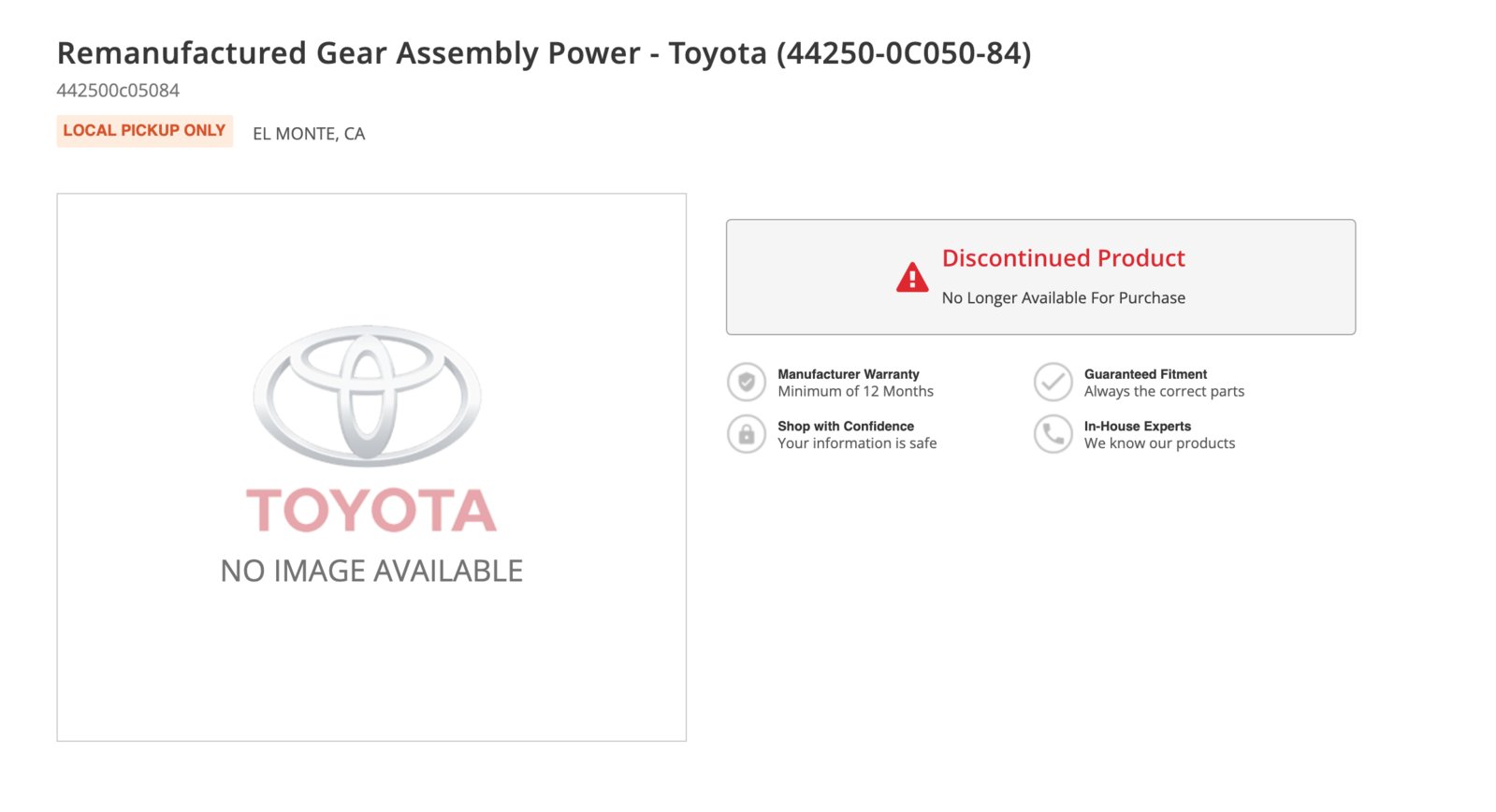

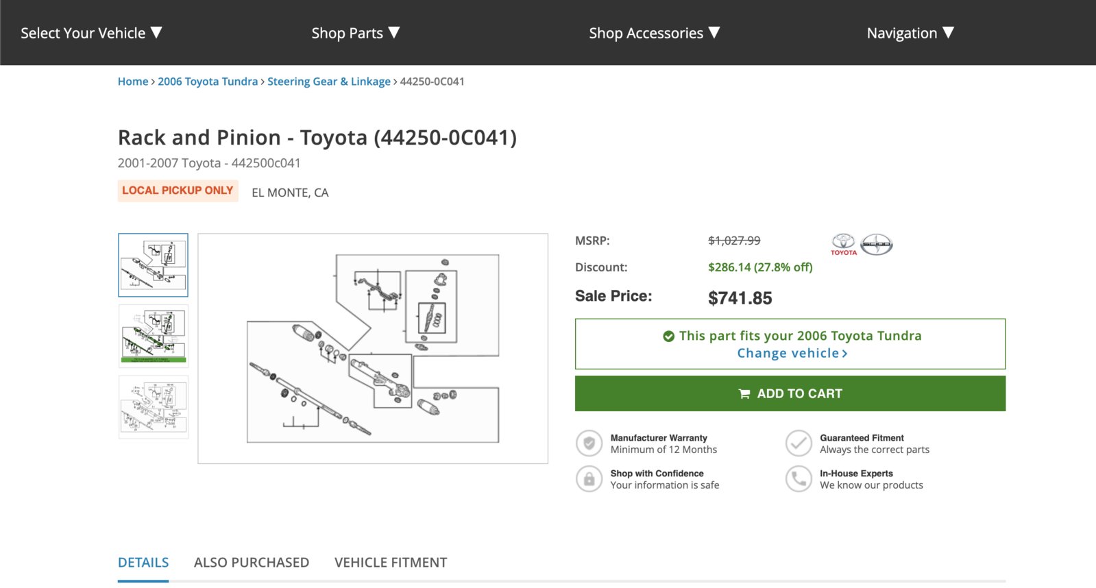

    My local dealer told me that new steering racks are on backorder with 200+ orders pending at their location. However they have reman available on-hand ready for pick up.
    But on their same website you can only buy a new one and the part number for reman is shown as being discontinued. Toyota part price for reman was $453.60 + $250 core fee.
    A local offroad/toyota shop quoted me $640 for removal, rebuild and install. The shop mentioned that some remanufactured racks are have issues, and that is was best to get your OEM rebuild or get a new one form toyota. Basically avoid reman.
    i have seen ppl on here saying the Detroit axle rack has been good, must follow the instructions to avoid leaks. I have also been looking at the Fr33lancefab rack.
    I just need a push and a shove in the right direction. I already bought new OEM outer tie rods.
