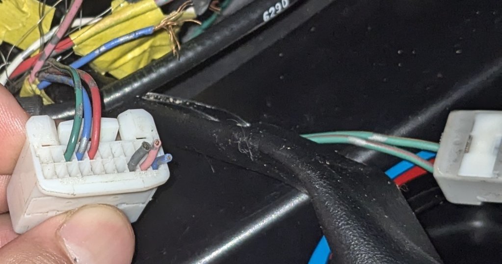

    Hope y'all are doing well today. I been trying to were can I find the wiring harness or male plugs for the OEM radio for my Toyota Tunda 2006 Access cab Sr5. I want to return it back to stuck it used to have and aftermarket radio but the privies owner splice the cables. So I'm looking for them. I look up my Vin on the Toyota website and its said it "AM/FM/CD w/4 Speakers" radio but not much more information. I attach some pics of whats left of the wiring harness.

    Best option, honestly, is to crimp new terminals onto each wire, then de-pin/re-pin into the original harness.
    You should be able to buy the correct crimper and a whole gaggle of pins on scAmazon for less than $50. Although I'm not sure which pins to use; I'd normally ask @daveeasa that kind of thing.

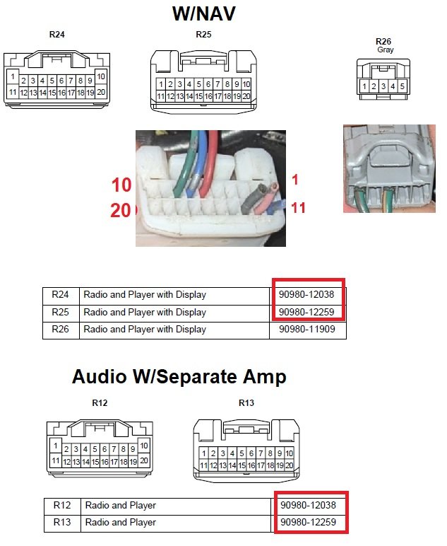

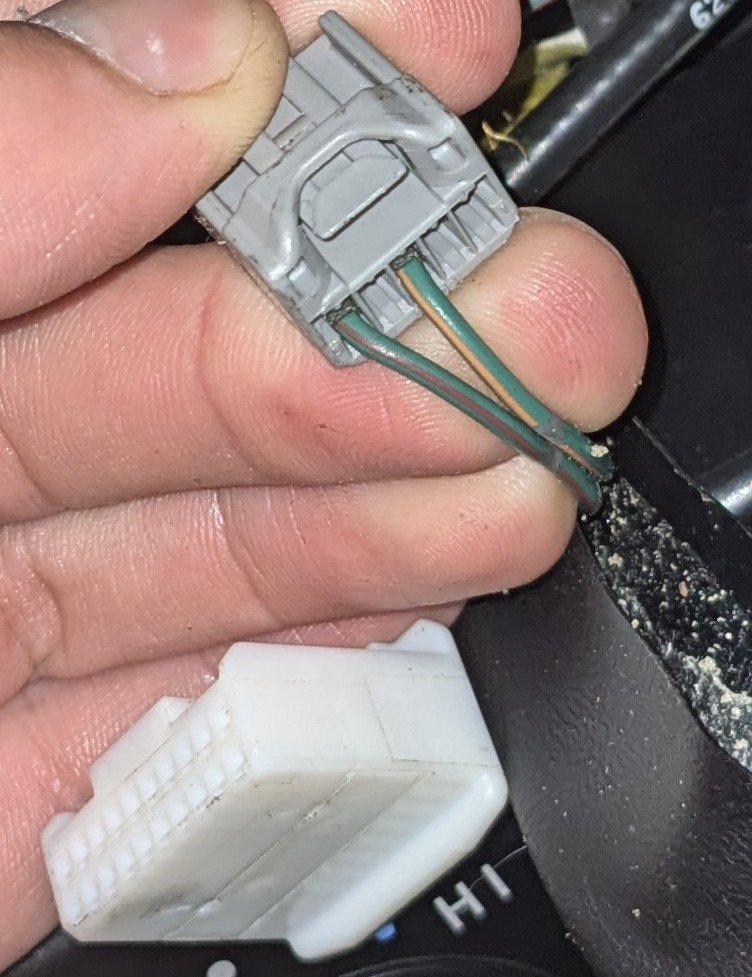

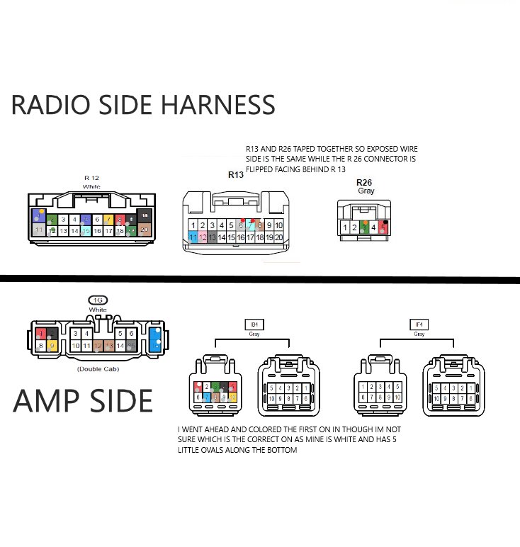

    As shifty alluded to, 3 radio choices for 06 AC SR5....Audio System w/separate amp, Audio System w/built-in amp and a Audio System w/Navigation.
    • W/separate amp can be eliminated because it did not use 20 pin connectors
    • W/built-in amp used 2 connectors(R12/R13)....both 20 pin connectors
    • W/Navigation used 3 connectors(R24,R25,R26)....1st 2 are 20 pin connectors, R26 is the grey 5 pin connector you're showing with those 2 used conductors for Reverse and Speed inputs tp NAV radio.
    All that to say, there should be another 20 pin you're not showing but regardless, the W/built-amp and W/NAV both used the same part # connectors if you choose to buy new connectors and pins.
    Perhaps @daveeasa can help with pins. In the mean time, I'll look in the 05 Wire Harness Repair Manual pdf for type pins for the 20 pin connectors.

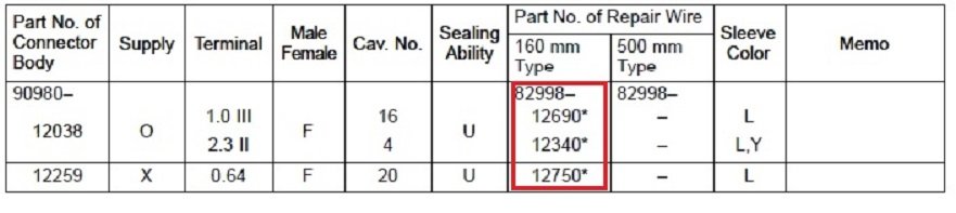

    EDIT....the pins you need for the 2 - 20 pin connectors if you choose to re-pin....

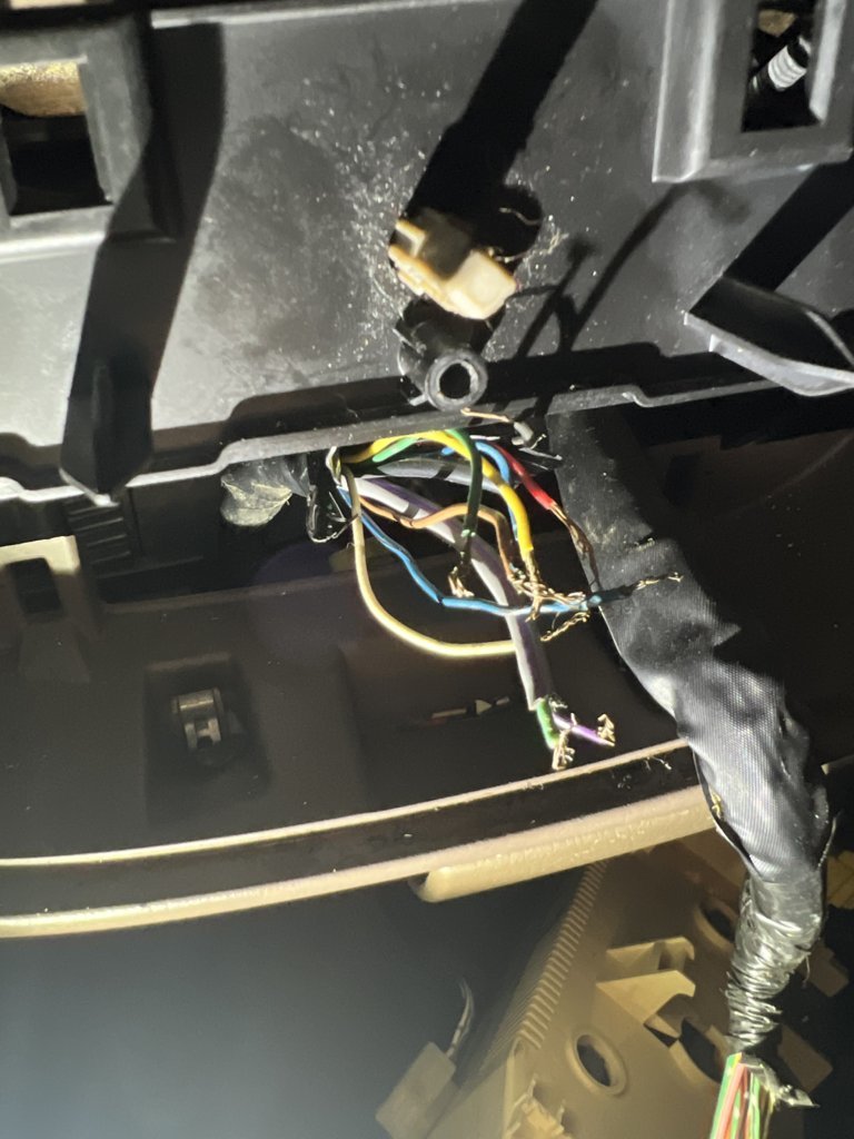

    Hey guys I recently bought a first gen Tundra and the previous owner was definitely a douche :annoyed:.
    I just finished rewiring a 6 pin connector for my ETCS I got a code for P1127 I assume due to incorrect hood release cable installation (grommet was moved out of the way so cable can go through that hole in firewall, aswell as a fender bolt that wasn’t in making water seep into the cab when it rained corroding said connector).

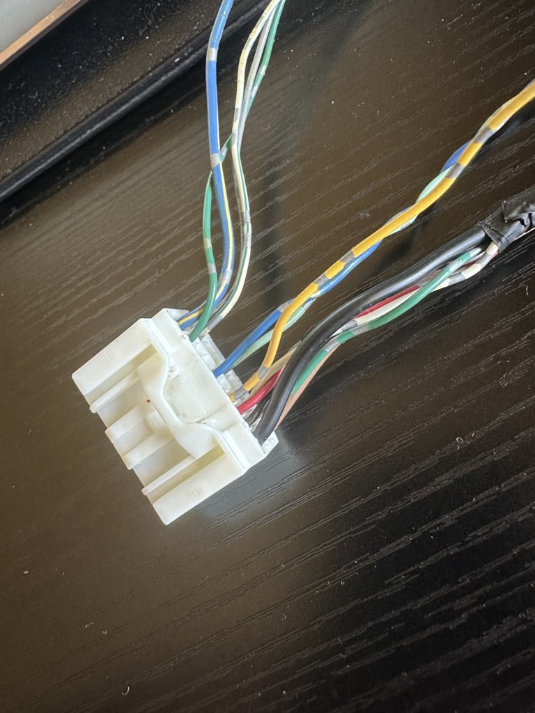

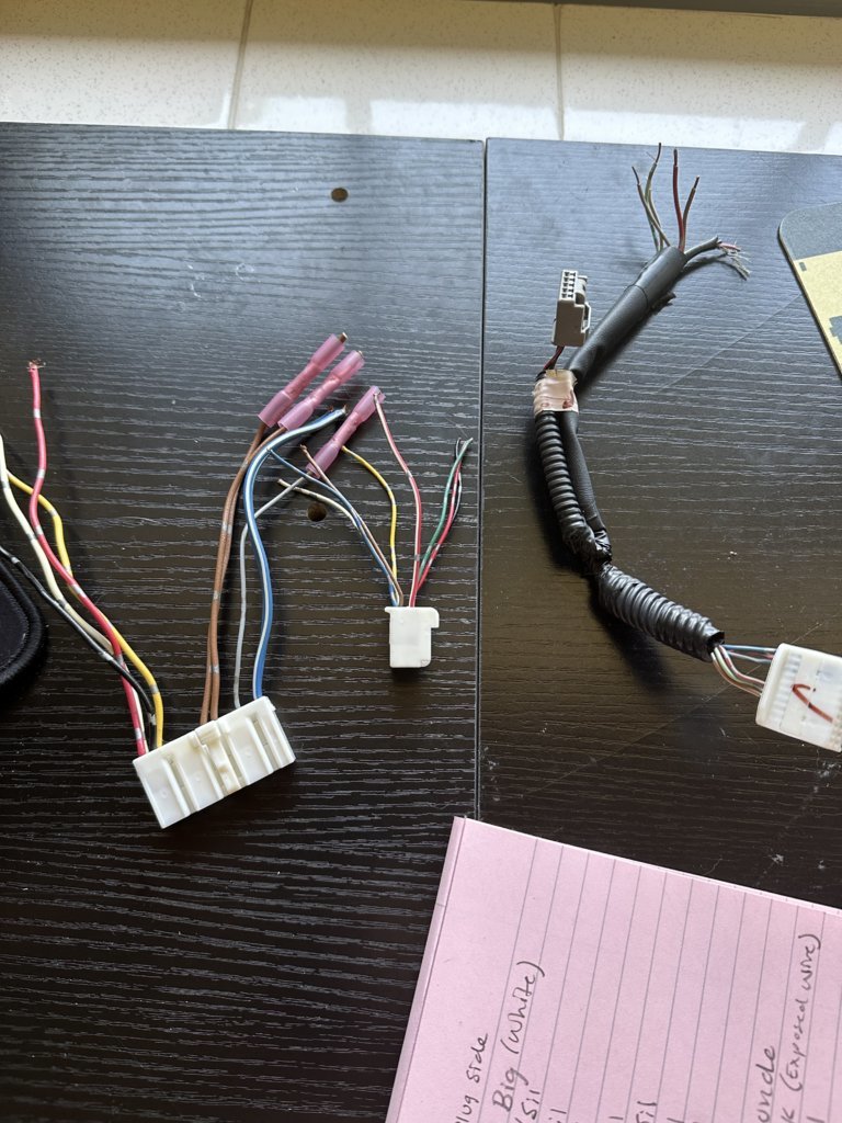

    But that’s outside of todays point, they installed a pioneer head unit but completely slaughtered the wiring… I will attach pictures of the amplifier wiring that was left just as pictured for me to find, the factory radio harness doesn’t exist as they cut it and put butt connectors directly to the pioneer harness. Hopefully someone can help me find the factory radio harness ( as if I’m going to factory radio) so I can buy the correct metra adapters and do it correctly.

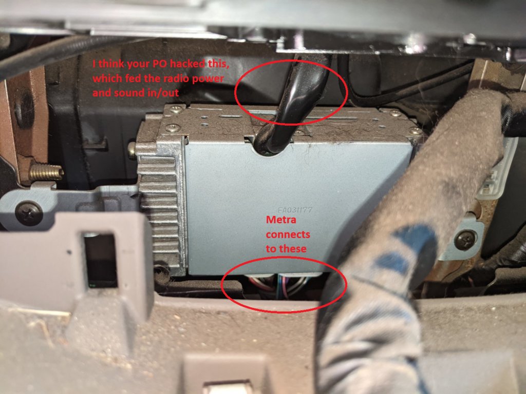

    I see the factory amp in the back of that pic.
    Normal config for your truck year/cab is for the OEM radio wiring to go into the amp, then out of the back of that up to the factory radio.
    Given I clearly see the silver fins of the amp in the back of your picture, it suggests the amp is still there. Which means there's a stark chance that - and if you'd checked out the 'Audio, audio upgrades and cameras...' help section of this thread, you may've known this - that your OEM wiring is still intact, and the asshole previous owner only hacked up the feed from the amp to the head unit.
    If the OEM (important pieces) of the harness are still intact, you'll find these plugged into the bottom of your OEM amp I see in your picture, the left is mostly power/illum leads and the right is primarily speaker leads IIRC:
    In case it's not clear, this is your full amp on the earlier models, notice the wires I just showed you at the bottom of it? That's what the Metra harness ties into. (more words after this pic)
    Notice that black bundle coming out of the top of the amp in that pic? I believe that's what your dumbfuck of a previous owner hacked into. Which, if so, you're a lucky SOB. And if not, your best bet is hitting a junkyard to cut a harness from similar cab/year truck. You may get lucky with a '00-02 and find what you need.
    But contrast on your pic is bad, so I can't tell if that bundle of black is coming up from under or above the OEM amp. Fingers crossed it's the latter.

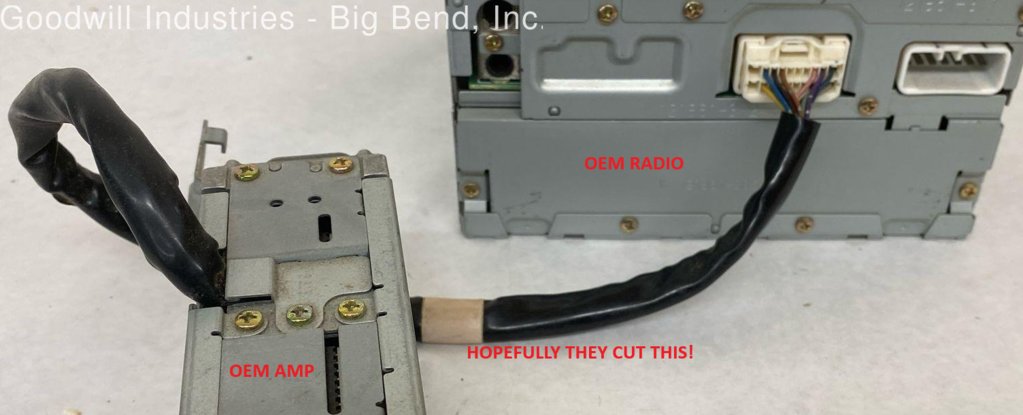

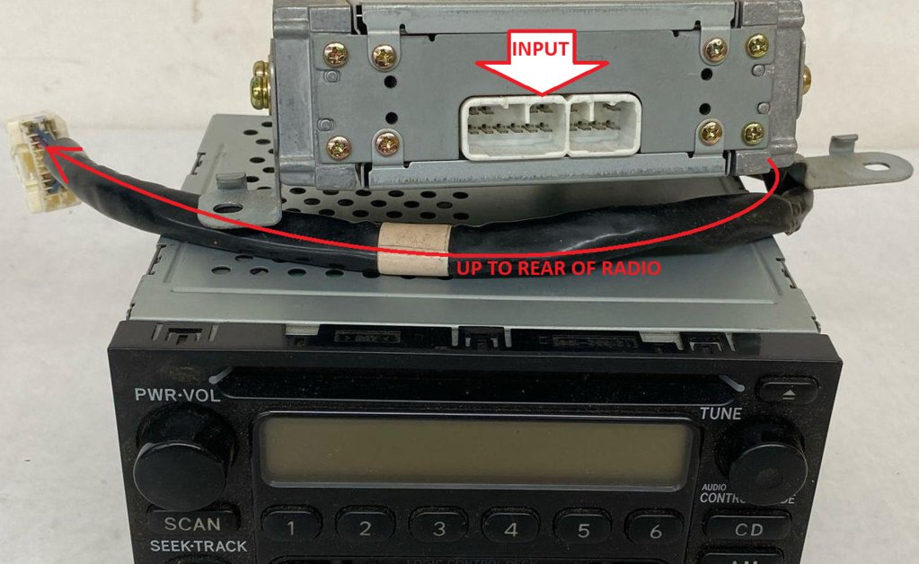

    Right on, I saw this auction today and thought about you. It shows a good example of what the OEM radio + amp setup looked like in your truck.
    Basically, two input harnesses COME from the speakers and the fusebox (connectos are seen above) plug in at this input - those are the connectors Metra usually plugs into - and from there, a pigtail of wires (which I hope is what your PO actually cut) go up to the back of the radio:
    Here's a shot from behind - again, the general hope is, your PO hacked that black throwaway wire bundle coming out of the amp, and you don't need to junkyard anything... just delete the amp, and use those the amp input plugs to link up with any aftermarket adapter harness you choose.
    I have my doubts just because I see red/white/green wires wrecked in your image, which are to your speakers, but maybe you'll get lucky and they only cut the smaller of the two plugs. I'll never understand why assholes cut up factory harnesses. Last adapter harness I bought was $8.
