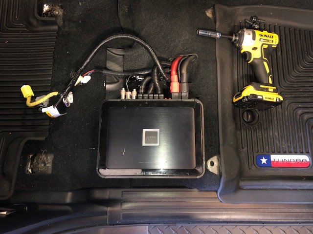

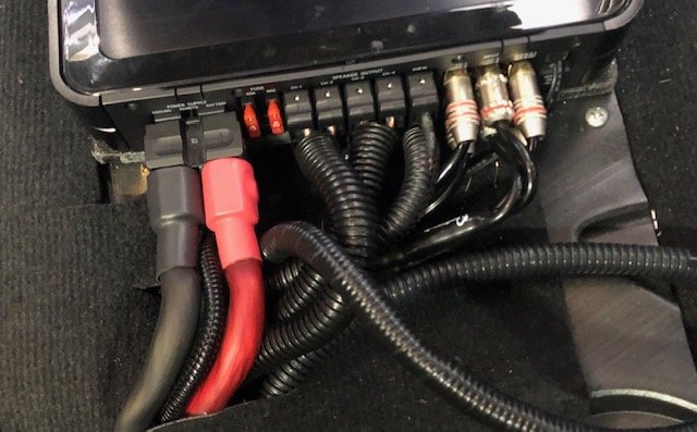

    JBL has a completely different OEM wiring harness than a non-JBL.
    Non-JBL, the dash speakers run off the shitty Entune HU, door speakers are sent a mid and low only signal thru the shit amp.
    The system uses the dash speakers as tweeters.
    On a JBL, the dash and all other speakers run off the shitty under-seat factory JBL amp.
    The JBL speakers aren't any better quality than what you have now.
    They are still shit low ohm speakers with tiny magnets.
    The JBL sub sucks.
    As a whole, the Entune HUs SUCK, be it JBL or non-JBL.
    Fortunately for you, a non-JBL is easier to upgrade.
    If you want to keep the shit Entune HU in your non-JBL;
    Get rid of the OEM underseat amp and replace it with a 5-channel, using this harness.
    It requires no cutting of the OEM wiring, just run your power line to the battery for the amp.
    Amazon.com: 2010-2019 Toyota Tundra (w/o JBL Audio) AutoHarnessHouse.com Factory Amp Upgrade Harness AHH-4438 : Electronics
    You'll need a DSP or decent LOC (Audiocontrol LC7i or equivalent) to sum the outputs of the shitty Entune HU to regain your highs as well as give you a low level RCA jack output for your amp..
    You'd be better off replacing the shit Entune and running RCA cables from your aftermarket HU to the under seat amp area for your new 5 channel amp.

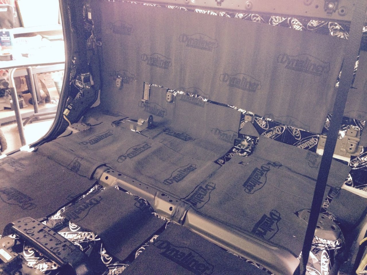

    If you have the money to sound deaden your truck to perfection, then you should have the money to buy a decent AM HU, an iDatalink Maestro for steering wheel controls, and a decent amp.
    You can add a sub to your 5-channel amp when you are able.
    You can even try running the stock speakers on the amp and see if that works before replacing them.
    All the money and time you spent on sound deadening was money wasted if you want to try to keep the shit Entune system.
    With some nice front door components, you can disconnect all 3 dash speakers and have a great front stage.
    You can put the tweeters in the existing front door sails, or purchase JBL door sails..
    You can even mount them where the side dash speakers go.
    Did I mention the Entune HUs suck balls?
    Good luck...:thumbsup:
