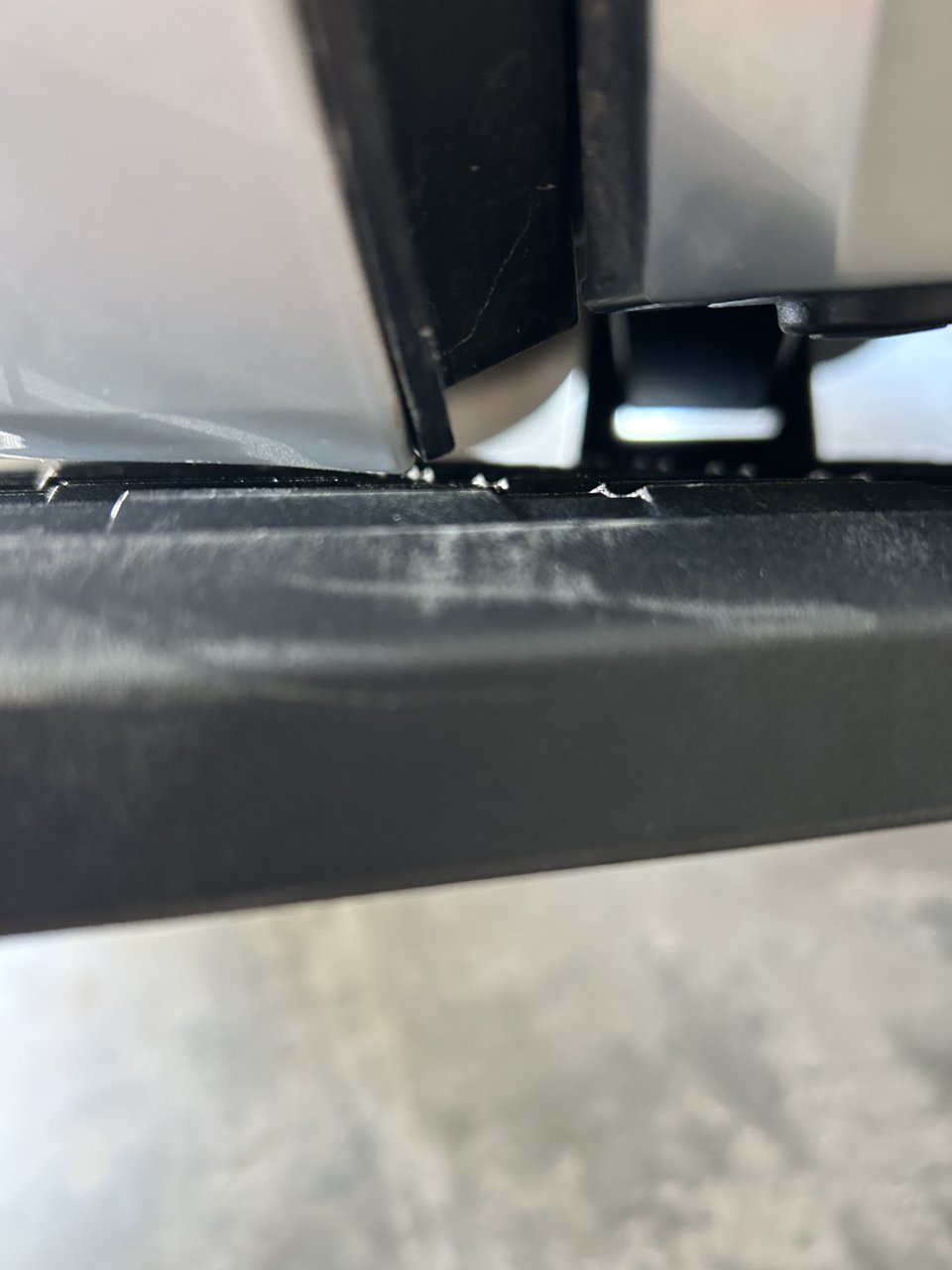

    I just had the dealership install the manual bed step for '22 Platinum trim, seems that the bed step in the retracted (up) position hits the bottom side of rear bumper, is this normal?

    It’s super close on mine but doesn’t quite touch the bumper. I installed it myself but there really isn’t any adjustment. Maybe you could tweak it a bit if it actually is hitting.

    Thank you for your reply!
    I looked at the installation to make sure it was done properly. That checks out. There is a small circular piece of rubber/neoprene bumper/cushion that used on the retractable step between two metal surfaces. Since the bed step is spring loaded, when retracted the two metal parts make contact when in the upright position with bumper/cushion between them. I am looking at replacing that rubber with a thicker piece or just adding another bumper on top of it. It is under compression all the time except when the bed step is lowered. I tried a small round rubber grommet just to see if that would help and that seems to keep the bed step from touching the bottom of the bumper. Just a 1/4" is all that is needed and looks like it will not cause any issues with it deploying on its own.
    Hopefully, this can be an easy permanent fix to make sure the bumper doesn't sustain damage over the life of the truck. I'm sure the bumper/cushion will compress over time and even yours may start to rub the bumper.

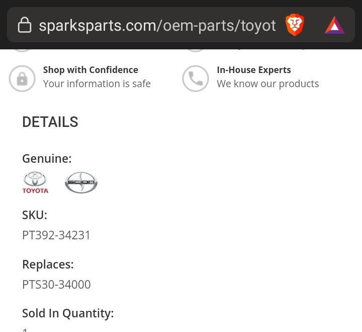

    Just a heads up, Toyota replaced the part sku to (PT392-34231)

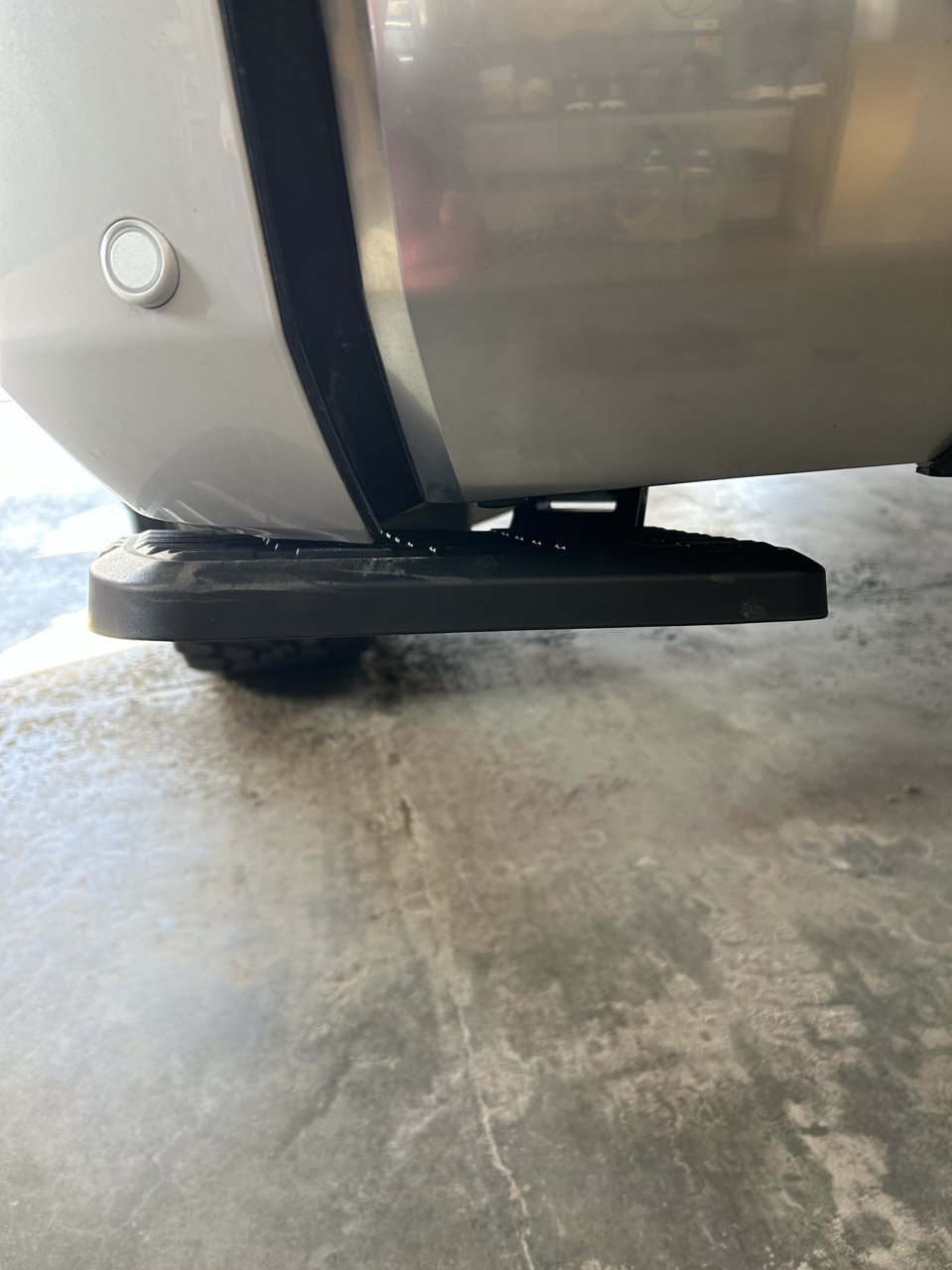

    Thanks for the tips / yes I did both. I found the hardest part was installing the very top purple bolt.
    the step is extremely close to the paint. I’m going to have that part of the bumper PPF wrapped.

    Looks good. Also looks a little closer to the bumper than mine. PPF is a good idea.

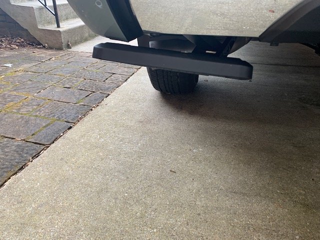

    Here is mine. I definitely have more clearance.
