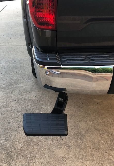

  2. May 1, 2022 at 4:39 PM
    #62
    Carpentercarguy
    Carpentercarguy New Member
    May 1, 2022
    #77834
    2021 Tundra Crewmax

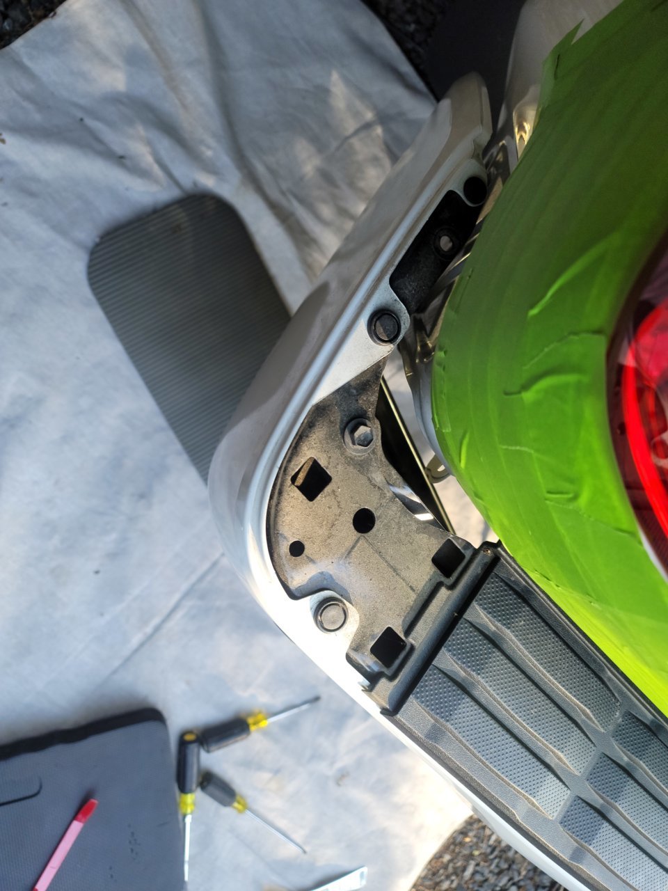

    I just did a bedstep for 2021. It took about 3 hours taking my time. I swapped the bracket out for the new one. I wanted it done how the dealership is "supposed to do it". If you dont want to be cutting on your take your time with the bumper retaining clips. A long set of double hindged needle nose did the trick no problem. The bumper cover only needed to be disengaged from driver side to hitch. That gives you enough room to get the bolts out. It turned out nice. I was happy i didnt cut any corners. To each his own on there truck. One last thing i need two different size torque wrenches. Its close quarters in there. This is how it turned out in case anyone wanted to do this way.

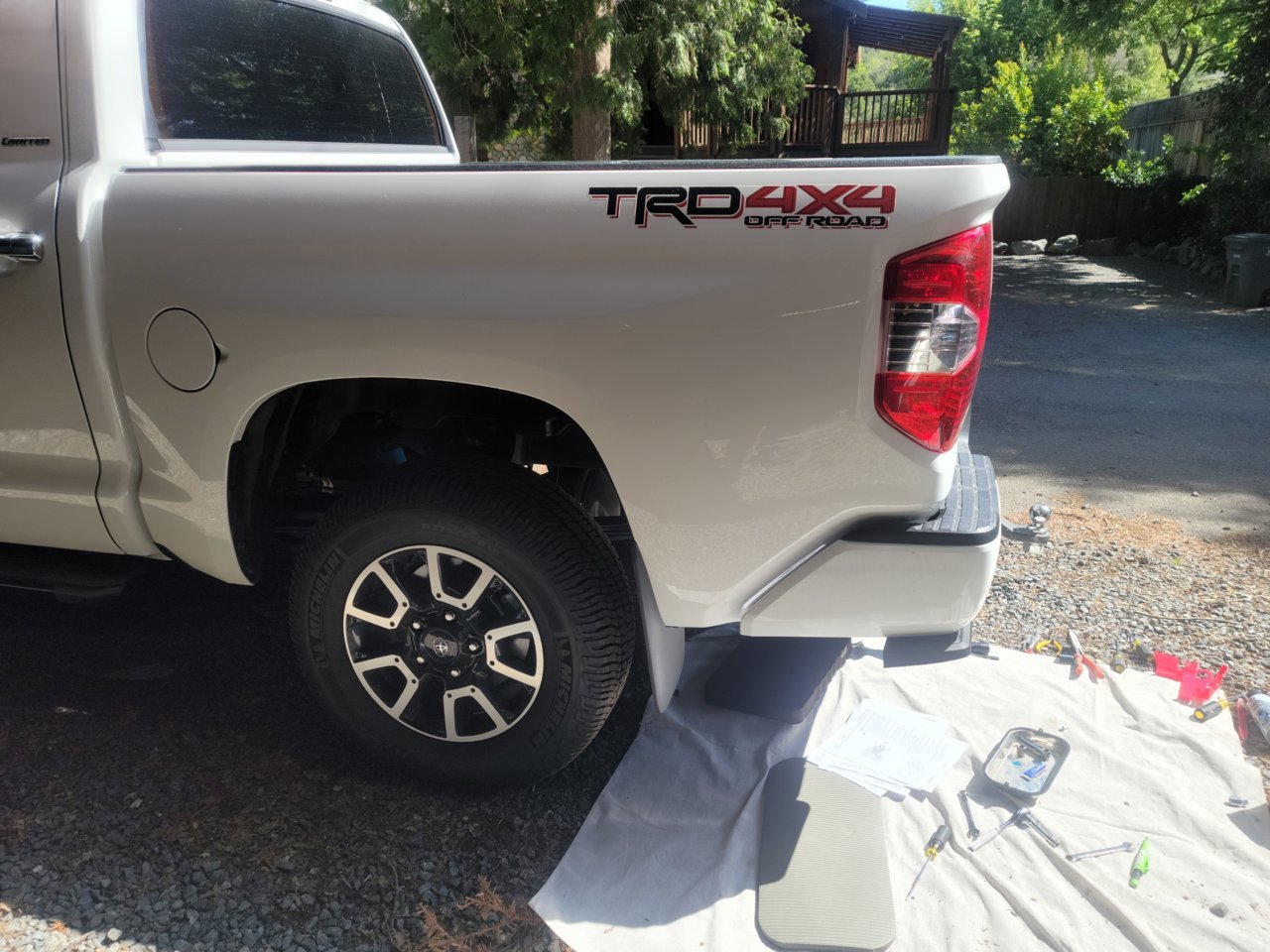

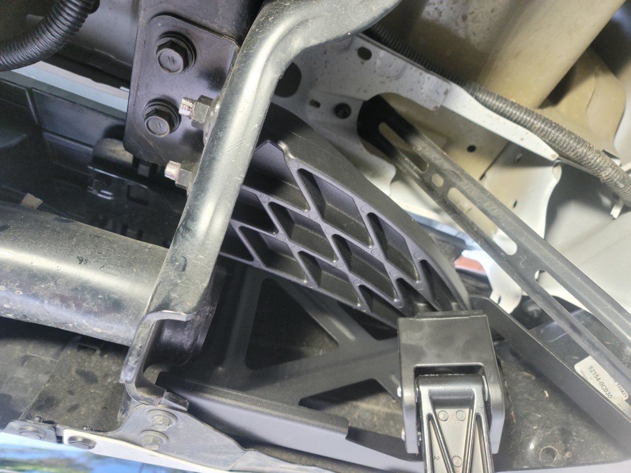

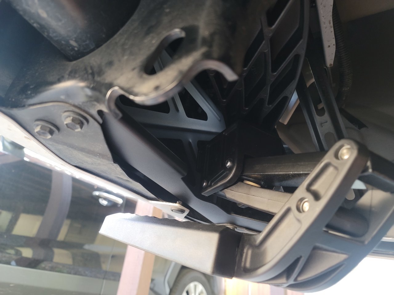

  4. Jun 2, 2022 at 3:57 PM
    #64
    Old.Ski.Bum
    Old.Ski.Bum New Member
    Oct 19, 2020
    #53773
    40
    Paul
    2021 Luna Rock TRD PRO
    Installed mine today by cutting the existing bracket. I figured if I didn’t like it that way I could always install the bracket that came with the kit. Being really anal, my step isn’t perfectly parallel to the ground; a little crooked. But I haven’t torqued anything yet, so I’ll loosen the bolts on the frame and readjust it. I think there’s a little play there to straighten it a bit! At the end of the day, pulling the bumper apart would have been a bitch. My truck is coated in crude underneath since I had NH Oil treatment sprayed the last two falls. What a mess; may skip it this year!

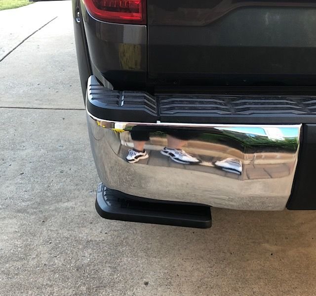

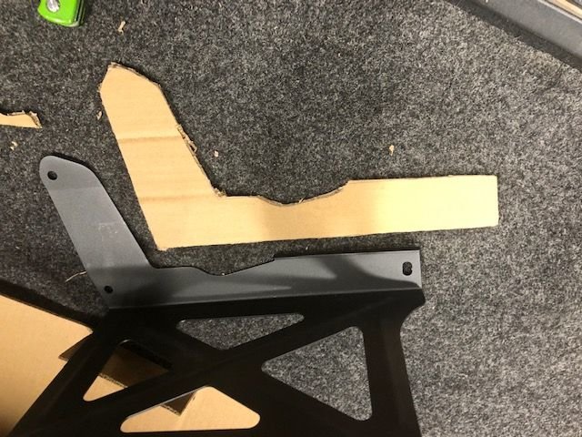

    I installed my Amp bed step yesterday.
    I got it for Xmas, but Toyota had my truck from November to July.
    Having my casual OCD issues, my first thought would be to use the bumper part that came with the step.
    But being I've taken all that off before, I can't remember why, I decided to do the "cut the existing bracket" method.
    Thanks to @lehminh for starting this thread.
    OEM bed step install without changing out the bracket | Toyota Tundra Forum (tundras.com)
    I laid out and made a pattern of what the Amp bracket looked like.
    Compared that to the existing one so I knew what to cut.
    I first tried my jigsaw, epic fail, and then the Sawzall.
    Dulled the sharp cut edges with my Dremel and painted the cut.
    It saved A LOT of time not taking the rear bumper apart.
    I would have liked the step to be more even/level with the angle of the bumper, but oh well..
    It certainly does make getting in and out of the bed easier, especially with bone-on-bone knees.

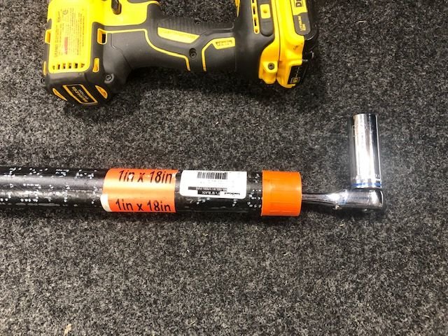

    And whoever mentioned needing a breaker bar to get the 19MM bolts out, thank you.
    I picked up an iron pipe just in case, and I did need it..
