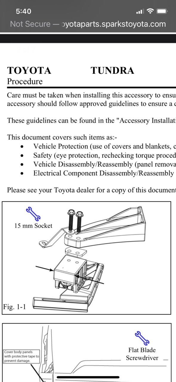

    Yes, you use two existing factory bolts to mount the bracket.

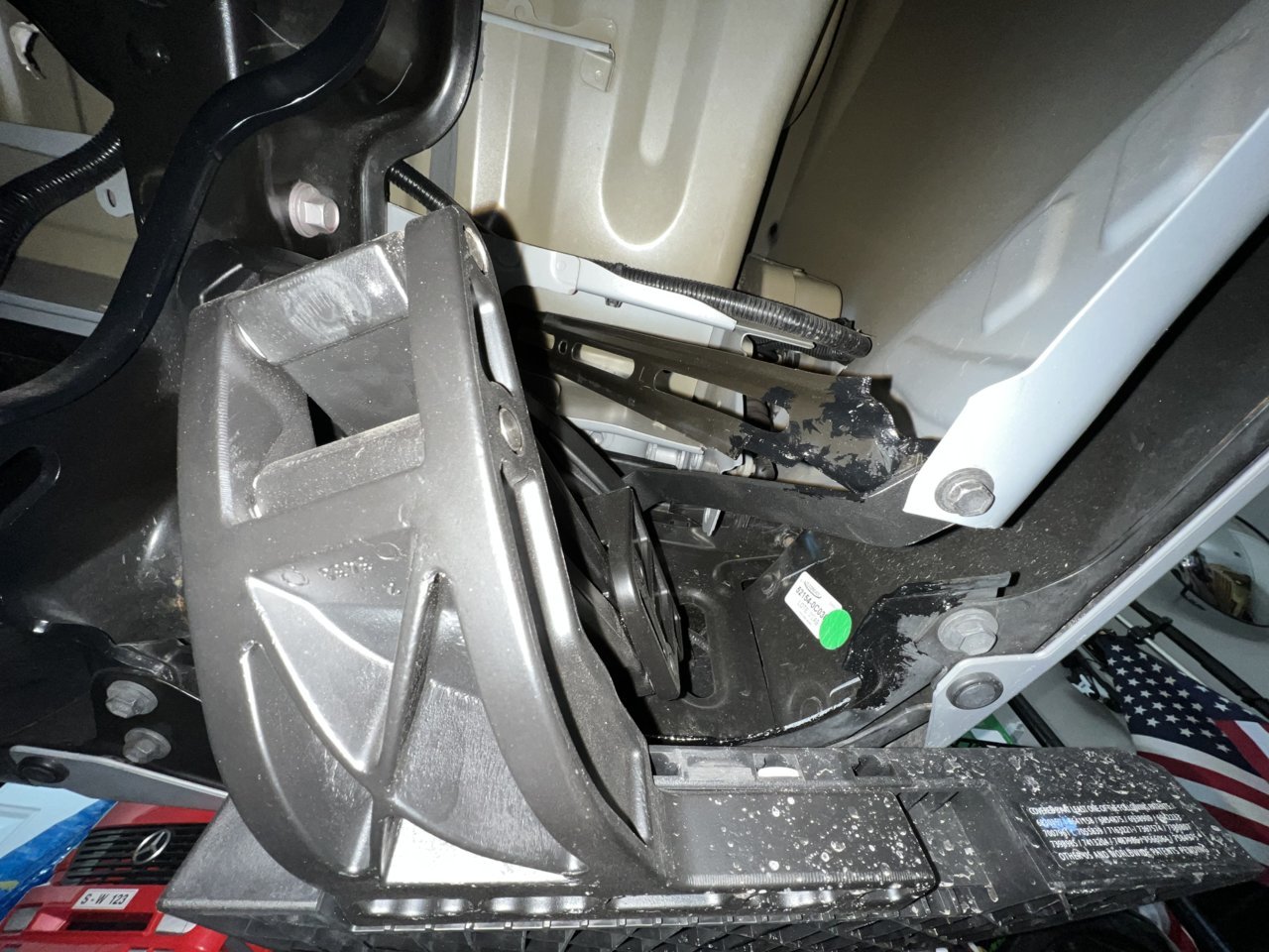

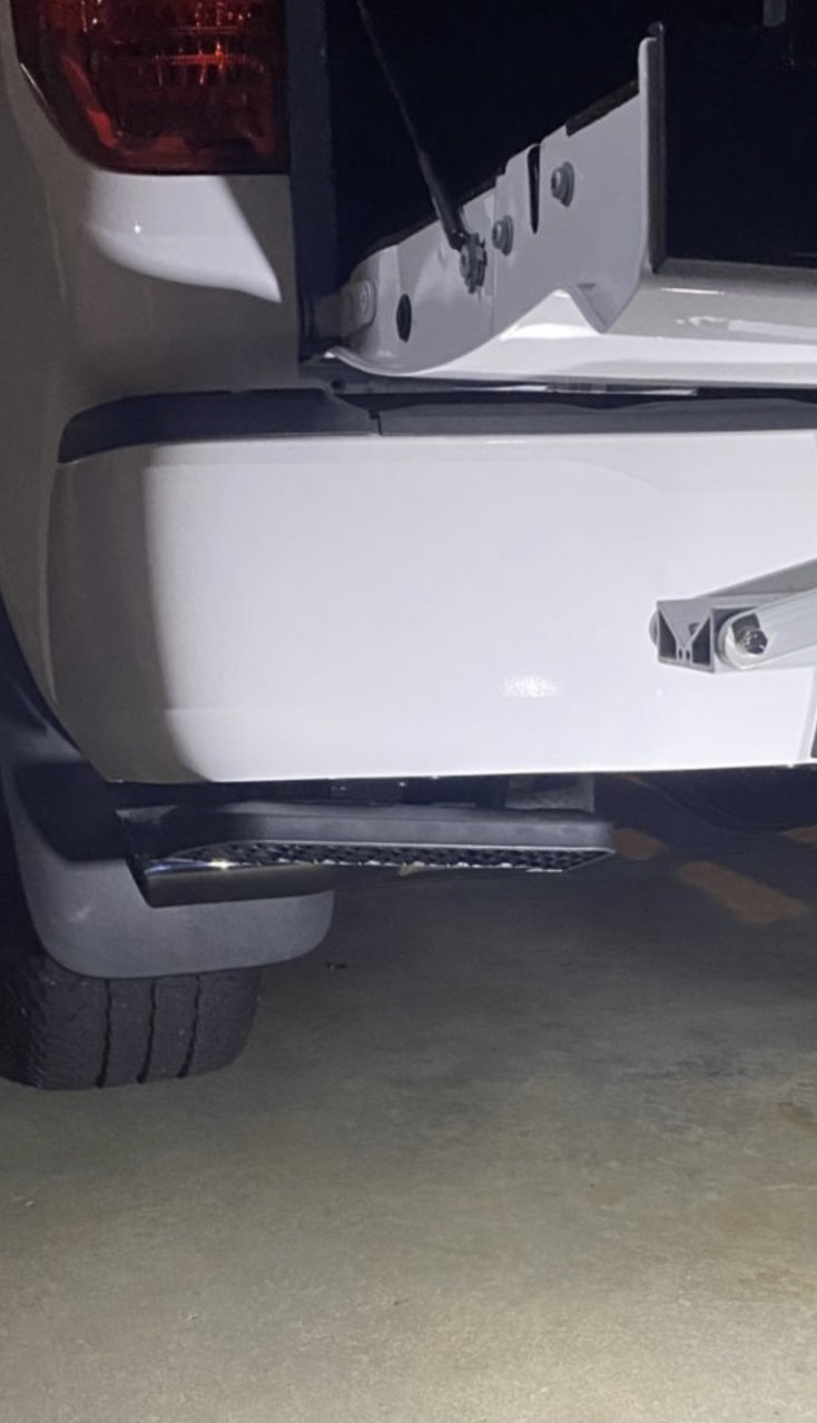

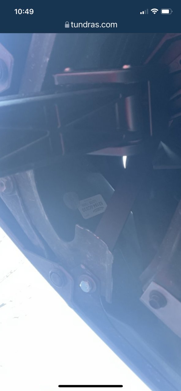

    I just received my oem bed step. Just confirming - I have the color matched resin bumper. I can still just cut the existing support and not use the supplied bracket correct?
    Just finished installing. Cut the stock bracket and had no issues with install.

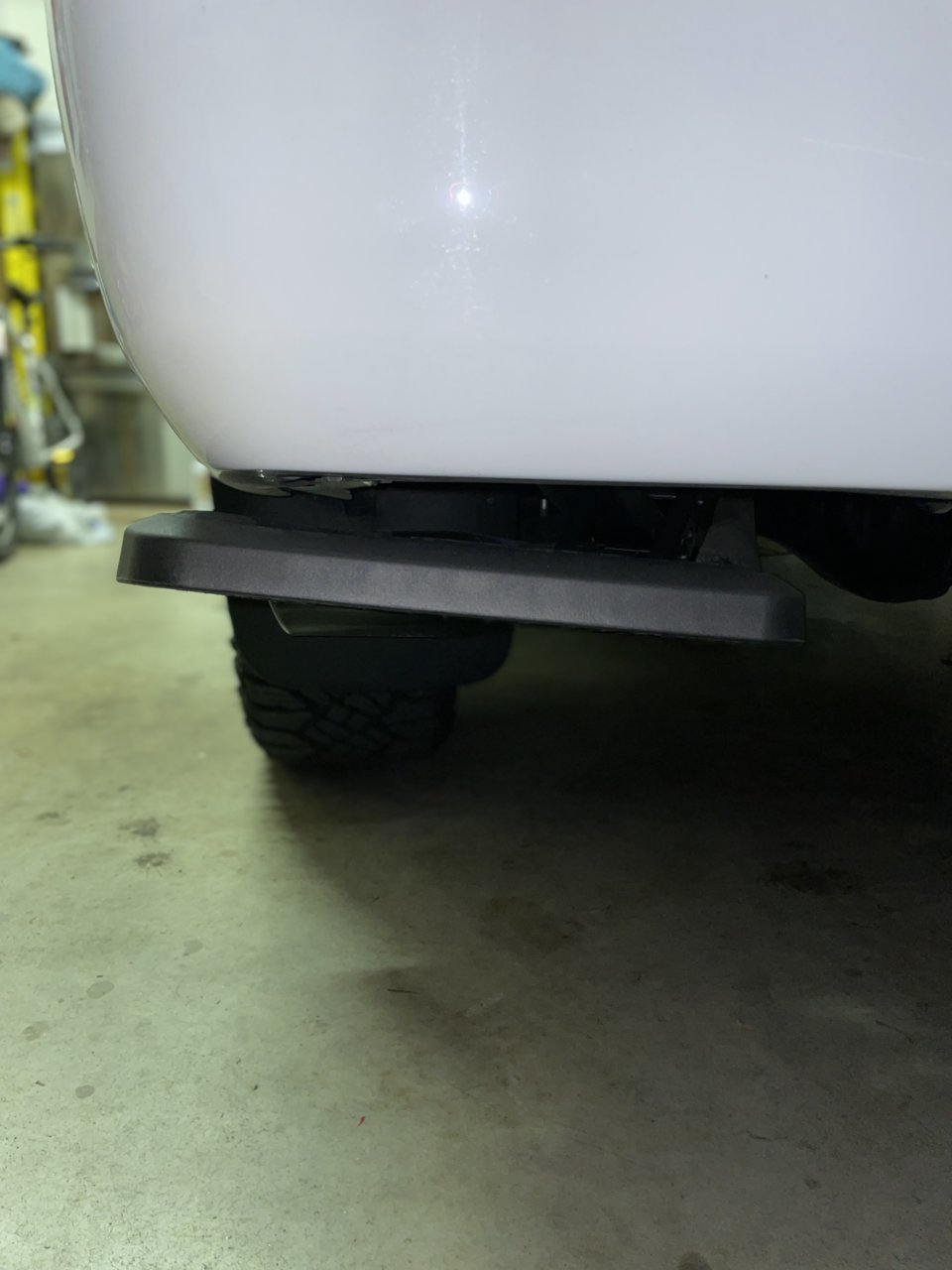

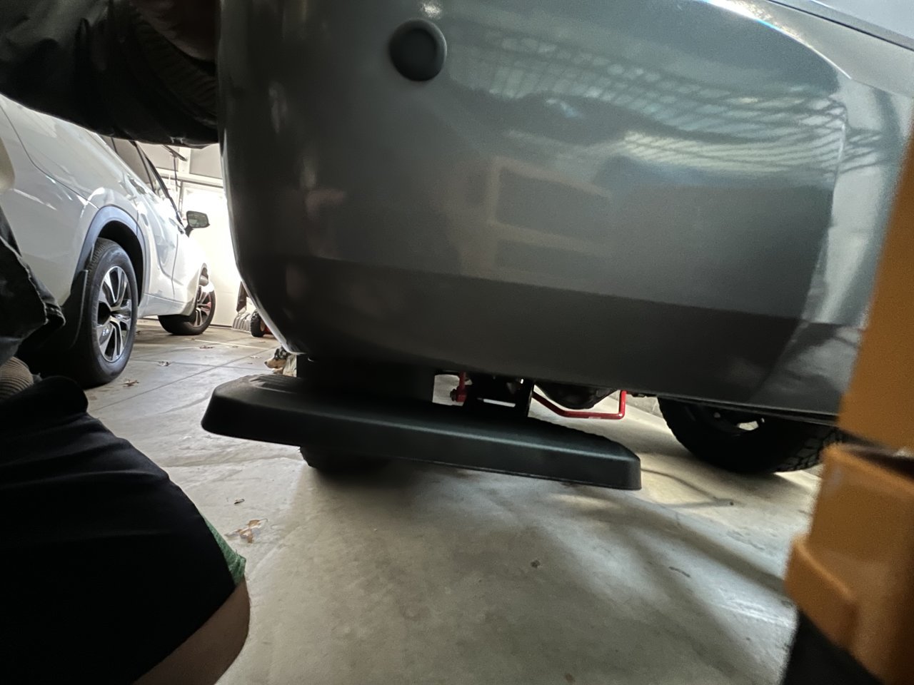

    Does it sit level when In close position? Mine looks like this
  18. Feb 20, 2022 at 2:42 AM
    #48
    shawn474
    shawn474 Lego connoisseur
    Jul 23, 2019
    #33569
    2,847
    MoCo, Maryland
    Mine sits level; are you sure you have the shim installed correctly? And make sure you have the hex head screws cinched down and in the correct holes.

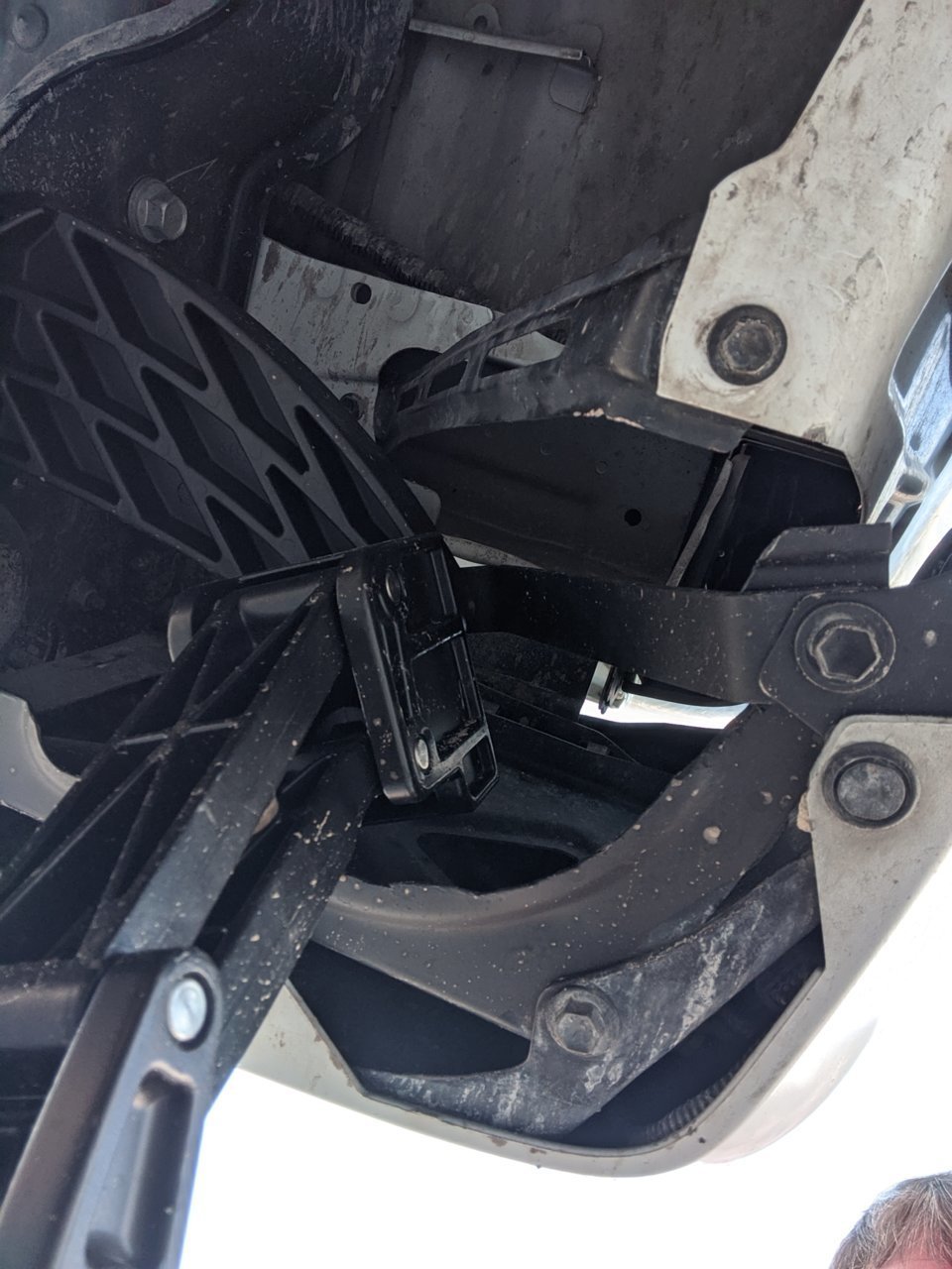

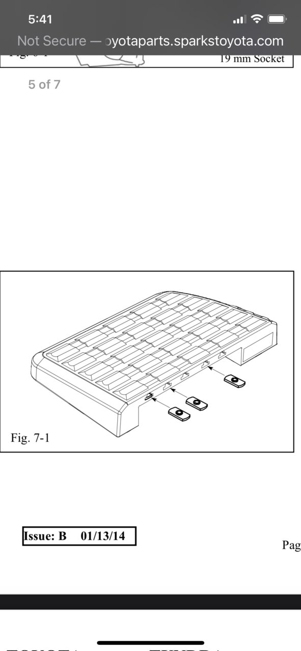

    One thing to note…..I noticed that a lot of people are not using the support bracket for the step. When you use the stock bracket it had a welded threaded nut. You cannot tuck the support bracket under it due to the angle. But you can get a thinner bolt to put through the existing hole and bolt down the support. Pictures below.

    Joe
    2019 cement tundra crewmax

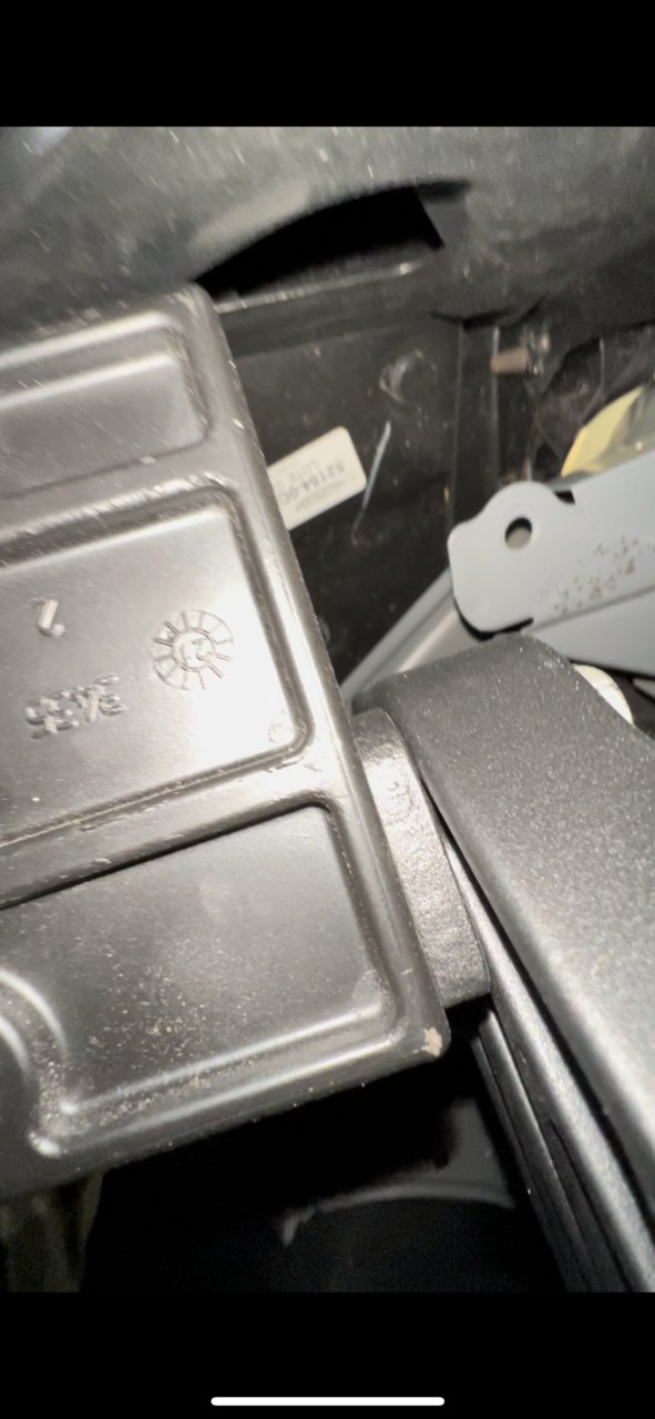

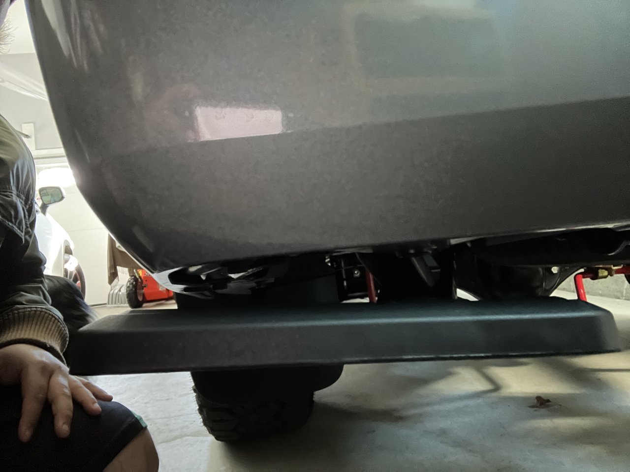

    Thank you , I noticed it yesterday since I don’t drive the truck a lot and installed it like a month ago.
    The pic I posted was from one of the forums.
    I took couple of pictures today from my truck and mine doesn’t look as bad , still a little tilt but not that pronounced.
    Everything is installed properly from what I can see . only thing is the support bracket is joined with the factory support bracket (which I had to trim)

    The only thing you might want to try……connect the support bracket to the screw behind that in your picture. There is the support bracket where you have it installed and then the screw behind it (before the plastic clip). I installed the step support bracket onto that screw if that makes sense. It’s much sturdier there…….

    May have to try that . Did the screw fit in the bracket hole ?

    No I used a smaller bolt and nut that fit through the hole and just tightened it down that way.
    you can see the silver bolt here. You could probably notch the stock bracket but the way it is will not allow you to tuck the support bracket under to use the existing bolt…..

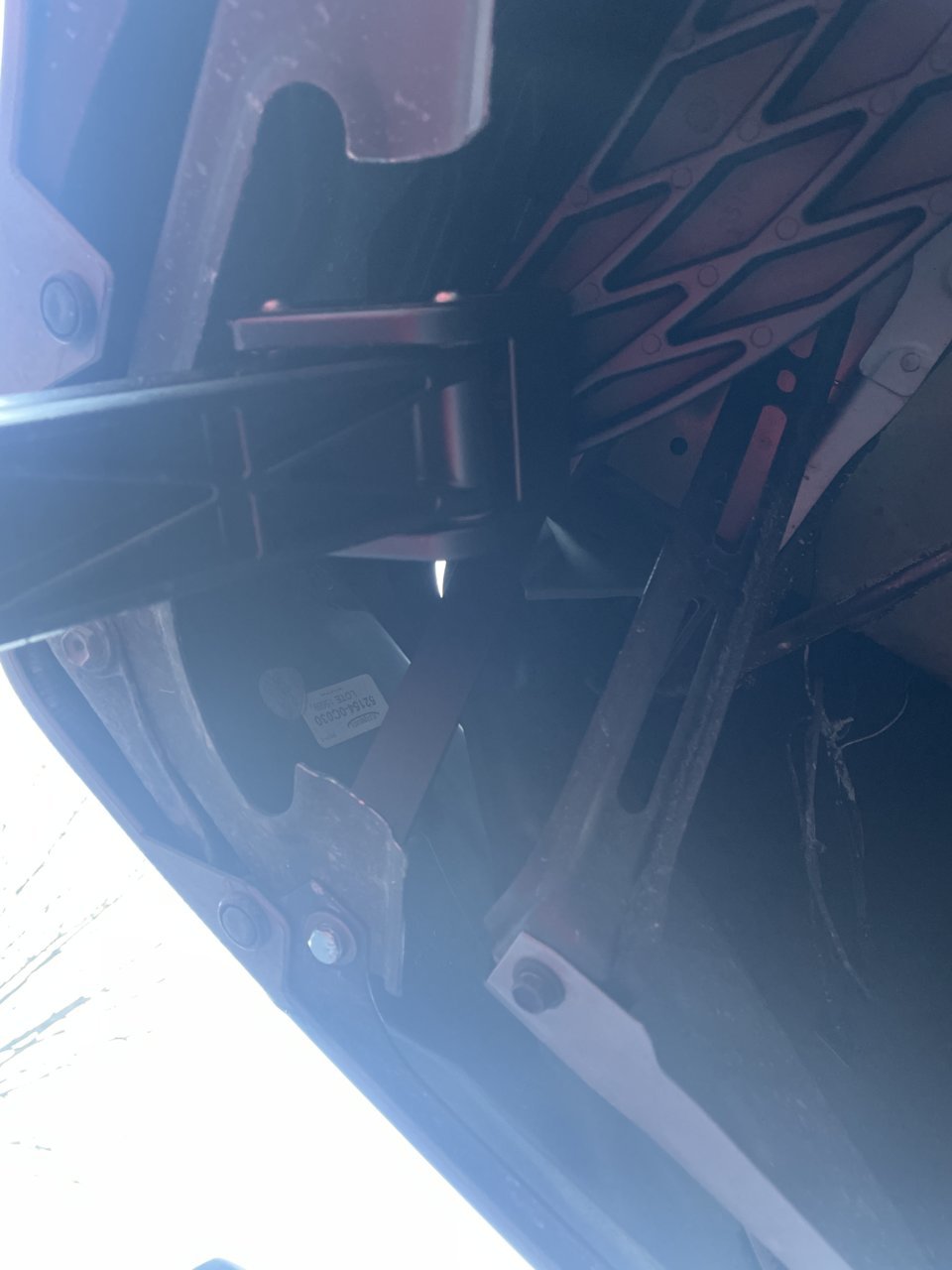

    I took closer look and I don’t like how it is sitting , definitely not right , I double checked the shim and it seems to be properly installed , only thing is the support bracket but you would think it wouldn’t cause it to tilt like that …

    Maybe try to take the shim out?

    Sucks man , sent email to sparks parts to see if they had similar question before and if they have any recommendations.
    On one of the other threads , one guy had to trim the shim 45 degree angle to get it straightened out .

    Mine attached to the location you suggested, and the OEM bolt worked.
