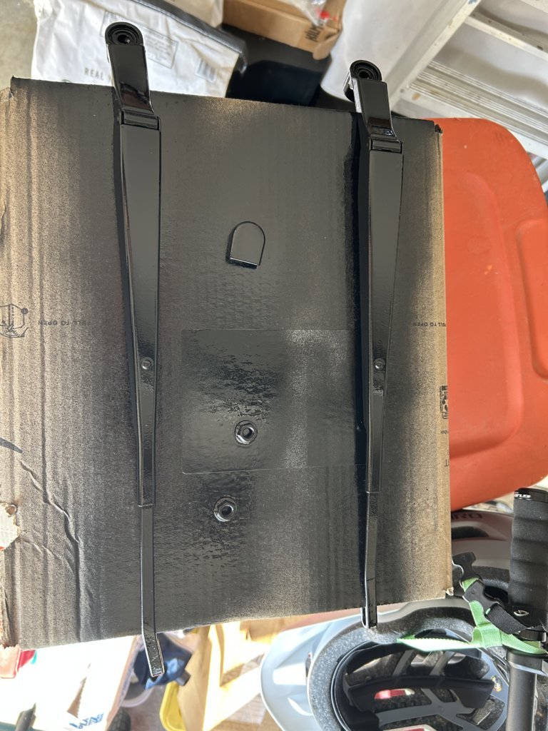

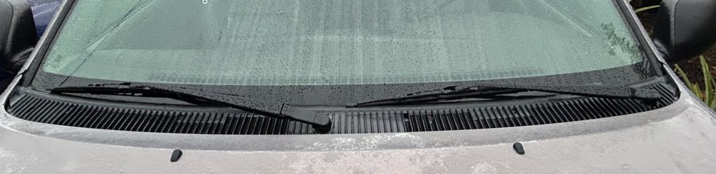

    The once every 5 years or so windshield wiper paint refresh. Usually go satin, but gloss is what I got. Needed some new wipers, so figured I would just spruce em up now. Pic of part number for wiper arm nut cap in case anyone is missing one, appears to be 85192-12800. Will confirm.

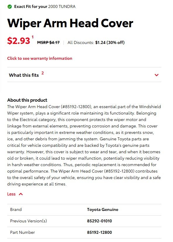

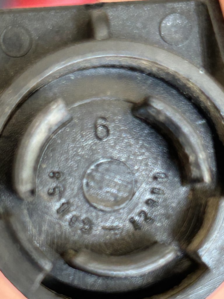

    Part number confirmed, just ordered a pair as the tabs are broken on the only remaining one.

    Wiper caps came in, final product, complete with authentic rain.

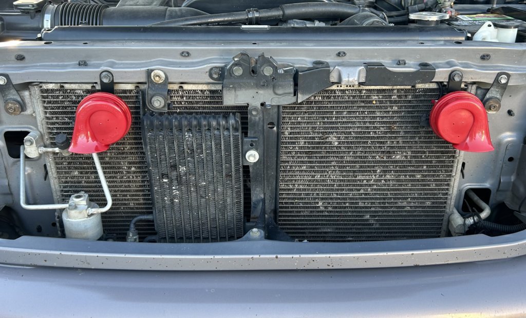

    New horns came in. These were my second choice behind the Hella horns that have more of an exposed speaker with grill look that are well reviewed.
    Install was easy, removed the factory horns from the 12mm bolt holding the bracket on and bolted these up. Plugged the factory harness into the horns positive post, made a ground wire with a female spade for the negative post and grounded to the 12mm bolt holding the horn bracket on.

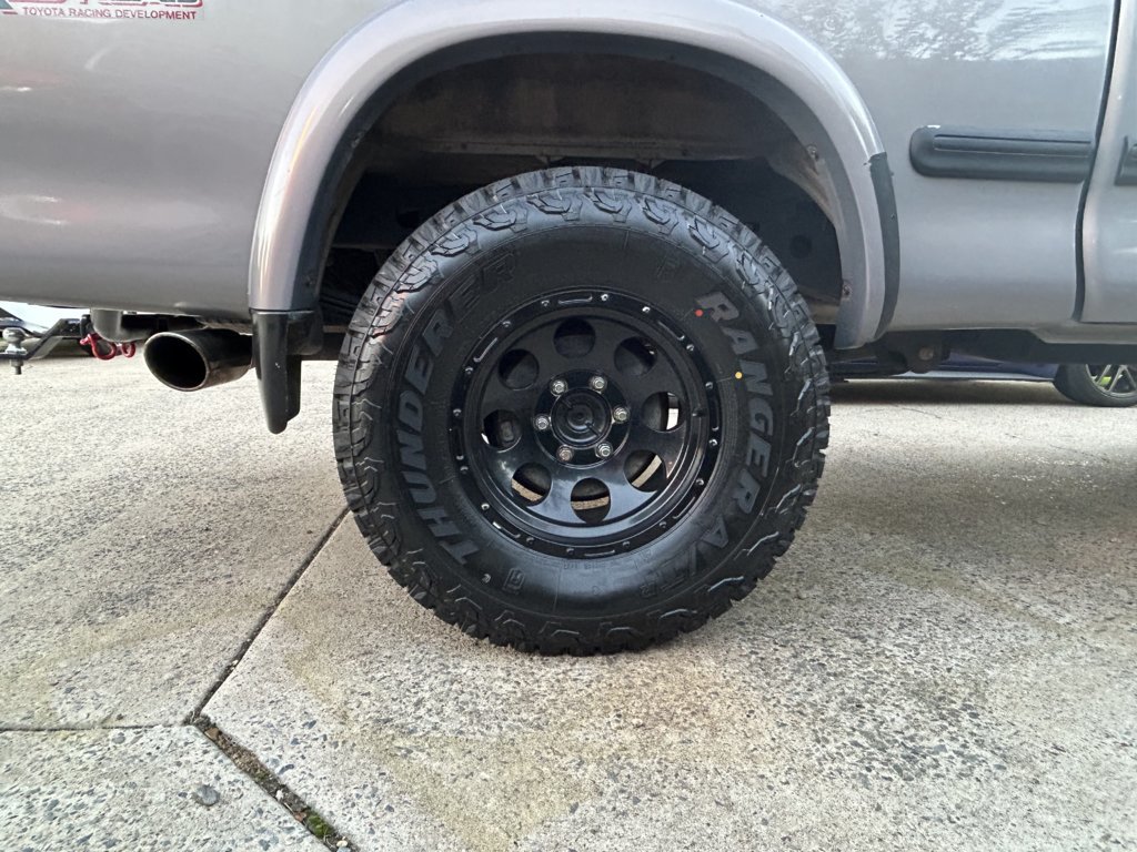

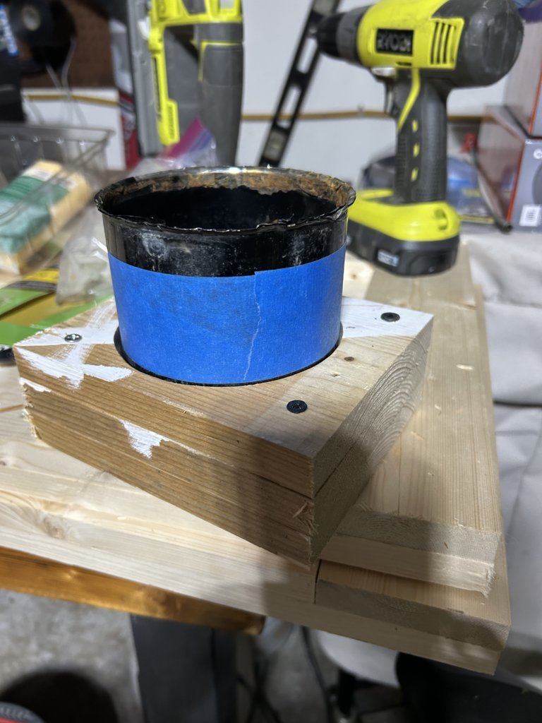

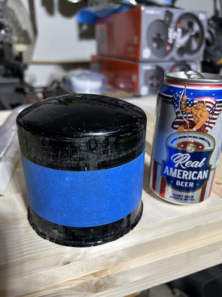

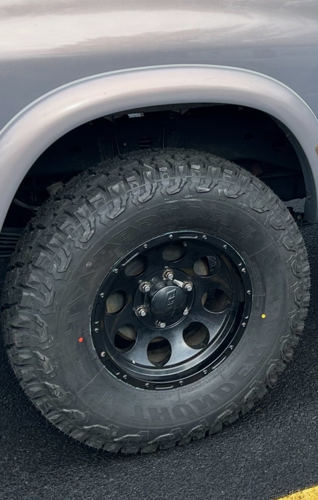

    After my flat tire / valve stem failure issue, I discovered my spacer and center cap setup did not allow fitment of my spare in case of emergency. So after receiving my replacement tire (other was ruined running flat on the freeway unbeknownst to me) I decided to change up the centercap arrangement. Really dig the more flush look. I have the centercap mounted behind the spacer to reduce the amount it sticks out of the wheel hub. These things are like 4.5” long.
    Marked for trimming to be more of a flush centercap that does not have to mount behind the spacer. I built a jig to hold the cap and trimming tool in a steady position out of some stacked 1by.
    Trimmed with my multitool
    Reinstalled on the truck. Bent a couple of small tabs into the freshly cut flange to seat in the back of the wheel groove. Once seated, used a hammer to flatten the flange into the groove. Worked decent, ball peen would have been better than the framer I was using.
    Before:
    After:

    1,118
    Jack
    Chicago Suburbs/Milwaukee
    Flush look is way better. Jig was a good idea.

    Well done! Can’t beat a jig and a multi tool.

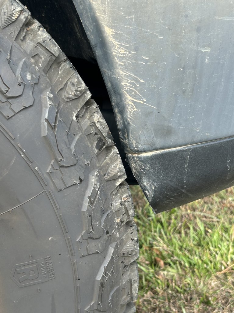

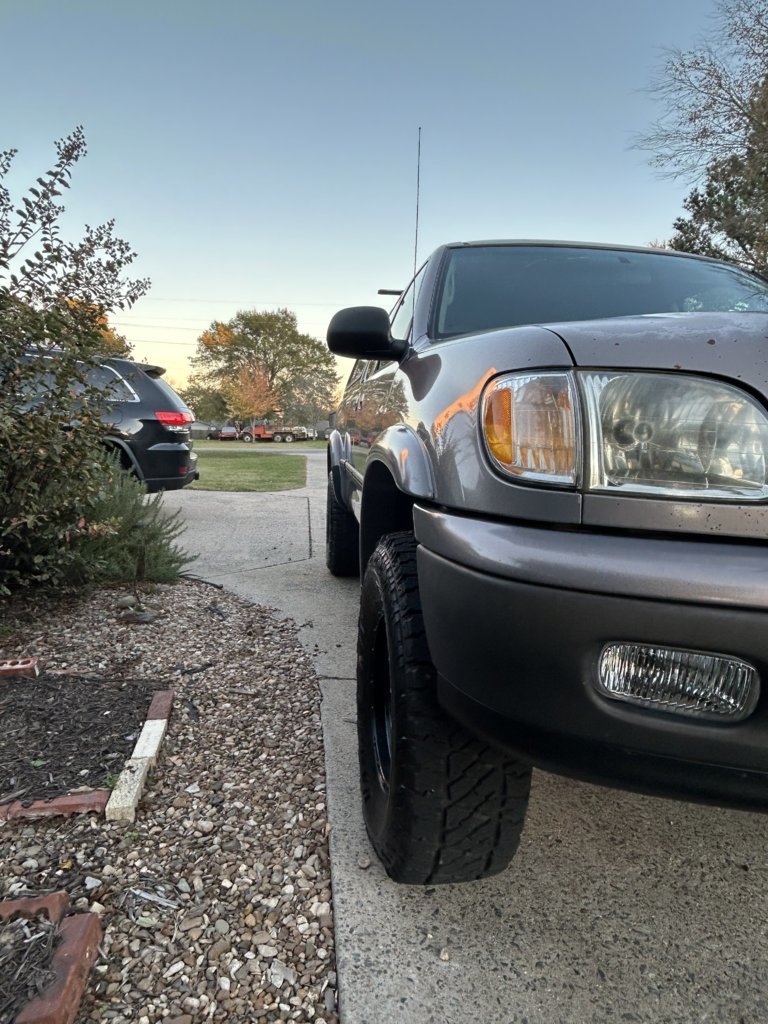

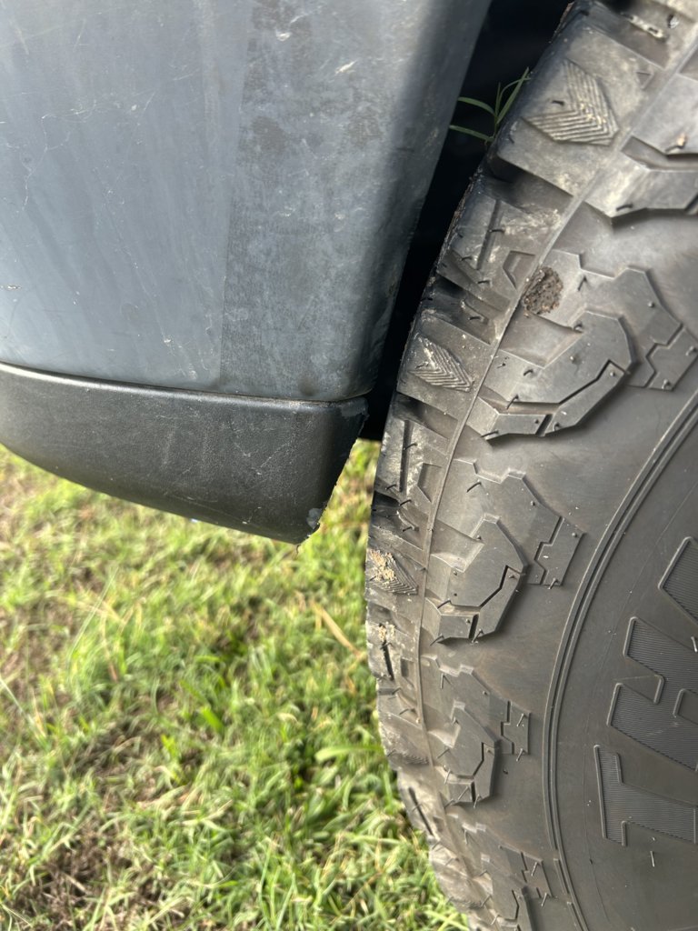

    Posted in the today thread as well, here for record keeping and anyone following along. Needed a little trimming for tire clearance. Pics at close to max static compression, wheel turned for maximum contact. A little off the airdam, a little off the fender liner, a couple solid whacks with a hammer on each bumper edge to deflare.

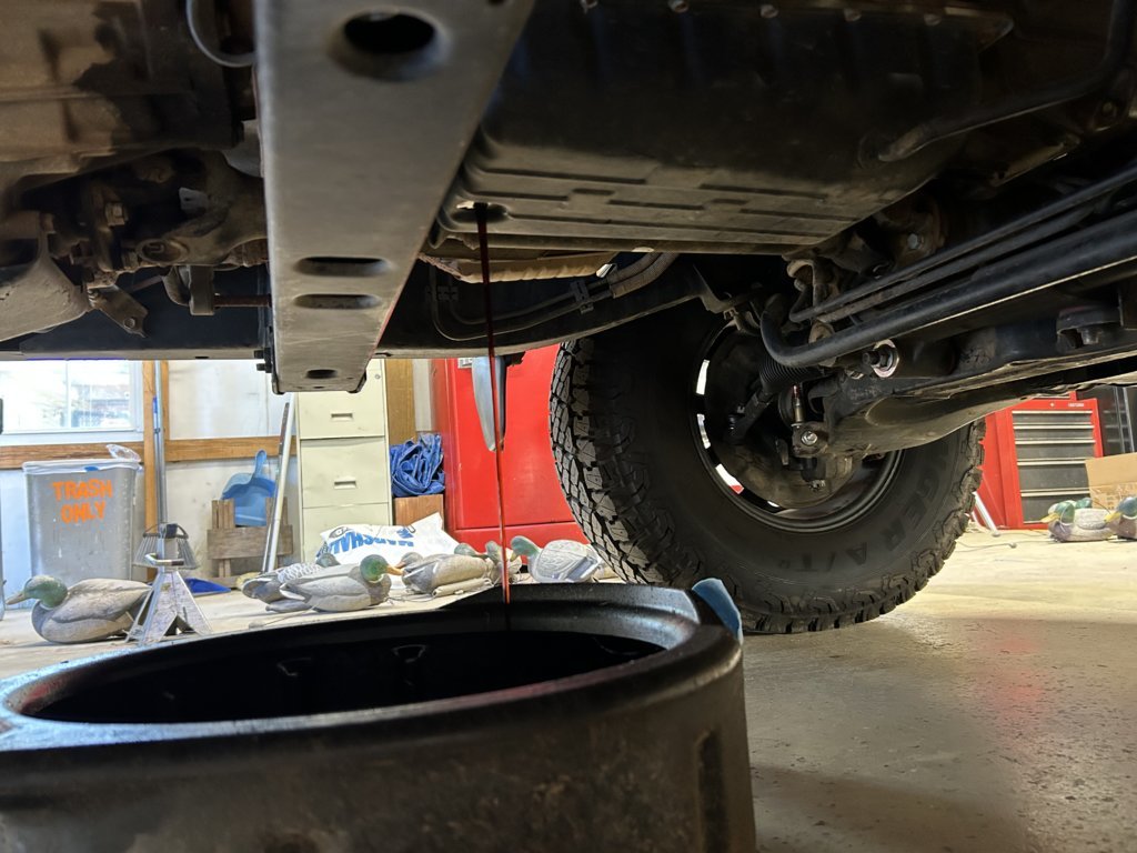

    Couple of items today. Drain and fill transmission. Added some LubeGaurd while I was at it. So far seems nice and smooth. Wasn’t having issues before other than occasional hard 1-2 shifts. We’ll see how it does over the next week. Fluid didn’t look bad or smell burnt. 3.4ish qts came out, replaced the same amount.

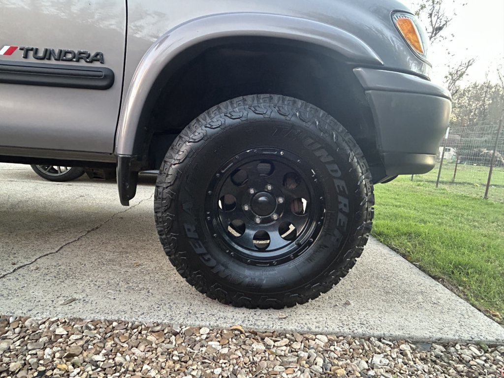

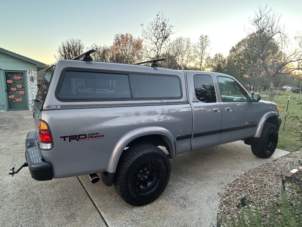

    Also pulled all of the wheel spacers and center caps and am rolling no spacers for the first time in 16 years. We’ll see if they stay off or not. Seems to drive a little smoother without but doesn’t look as cool to me.

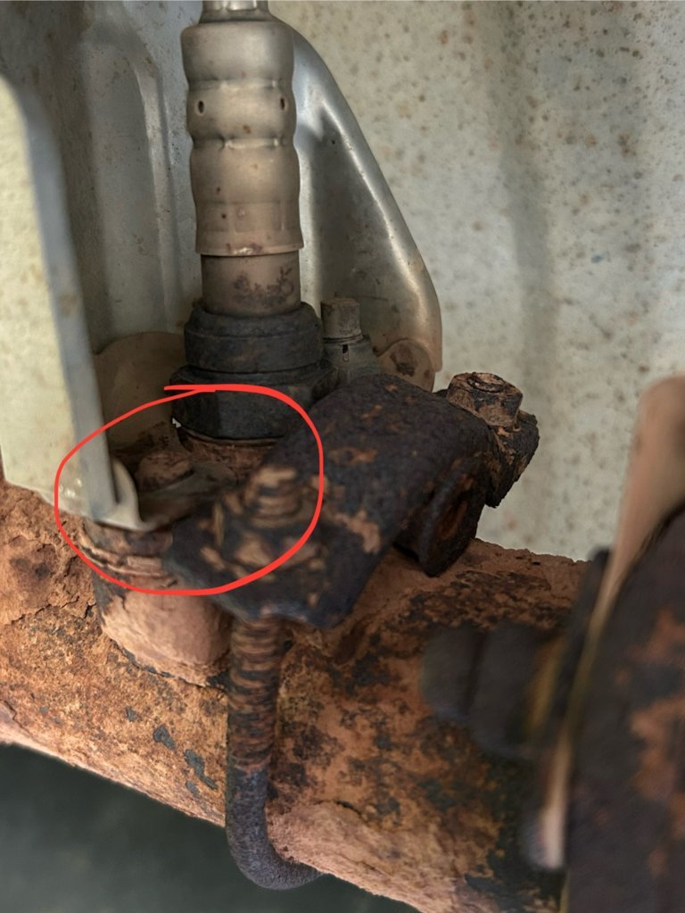

    Oh, and I fixed this terrible tinny ringing sound around 1400rpm that was ruining the sweet exhaust note. Turns out some chuckle head broke one of the O2 sensor studs off 10 years ago and rigged this crap up. The broken stud side was what was rattling since it wasn’t bolted down. I stuffed a washer in between the shield and exhaust. Sits nicely on the remaining stud stub. No more rattle.
