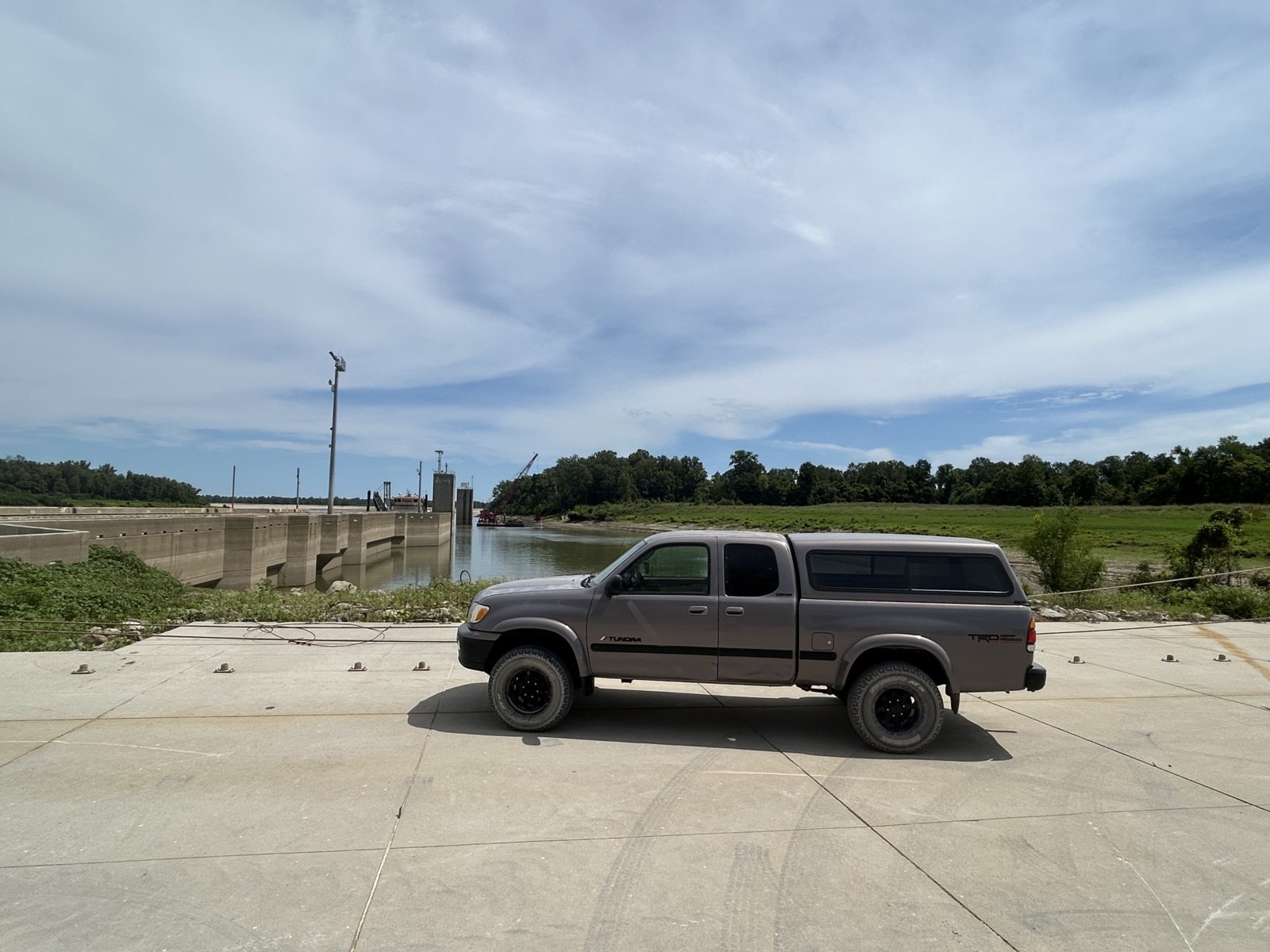

    Loaded the truck and took the new camper to the lake for the weekend. HD leafs are settling some. A bit disappointed in the overall ride height now. It’s level or still slightly lower in the rear. Guess I’ll stab my leaf I stole from the OE pack in there.

    At least you were prepared for this eventuality.
    My custom Alcans sit about an inch lower than I wanted em to and don't hold weight for shit. But they do flex really nice off-road.
    So I plan to add a leaf or two in the future. I might even add a 1" block + leaves, once I get a hard topper.
    KNABORES[QUOTED][OP] likes this.

    Very weird, I haven't seen any sag/drop in my ATS leafs. Maybe ATS and Husky aren't the same after all?

    What’s your hub to fender measurement?
  19. Sep 2, 2024 at 5:31 PM
    #169
    KNABORES
    KNABORES [OP] Sarcasm incoming
    Jan 1, 2020
    #40572
    14,241
    Arkansas
    Actually just measured my fender height and looked back at my original measurement. Both 37 3/4” from ground to fender. About 23” hub to fender. Zero drop from my original measurement. Weird.
  20. Sep 2, 2024 at 5:37 PM
    #170
    shifty`
    Jun 20, 2020
    #48239
    29,437
    ATL
    '06 AC Limited V8/4WD
    Currently with cap on (whatever that weighs) and all 4 new wheels and tires in the rear (~400lb) I'm sitting at 23-7/8 center to flare, and 38 floor to flare.
    So it's actually possible I've dropped 1/2" or so, I only measured passenger side though, b/c it's farthest from gas tank (which is 1/4 full). Or it's just that I've got about 600lb on the bed.
    Front hasn't budged since install. I guess I could crank it down but I really think I'm just gonna swap in the 6112s. The more I mull over it, the more I think I want some ride quality back. Coilovers have always been notoriously stiff. Will see what C rated tires do first. Then maybe yoink the Toytecs.
    I'm sitting high up front by half inch or so now. Which makes me think my measurements were wrong prior, or I settled more in the rear after measuring. I'm trusting the ground to flare measure more than center to flare, only because w/o a level it's hard to get perfect center on hub.

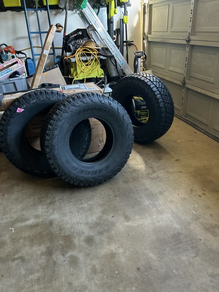

    4th tire showed up today

    What size did you go with @KNABORES I have those tires on my watch list from when you posted them in one of the sticky threads
  30. Sep 9, 2024 at 3:58 PM
    #180
    KNABORES
    Jan 1, 2020
    #40572
    14,241
    Arkansas
    285/75/16
