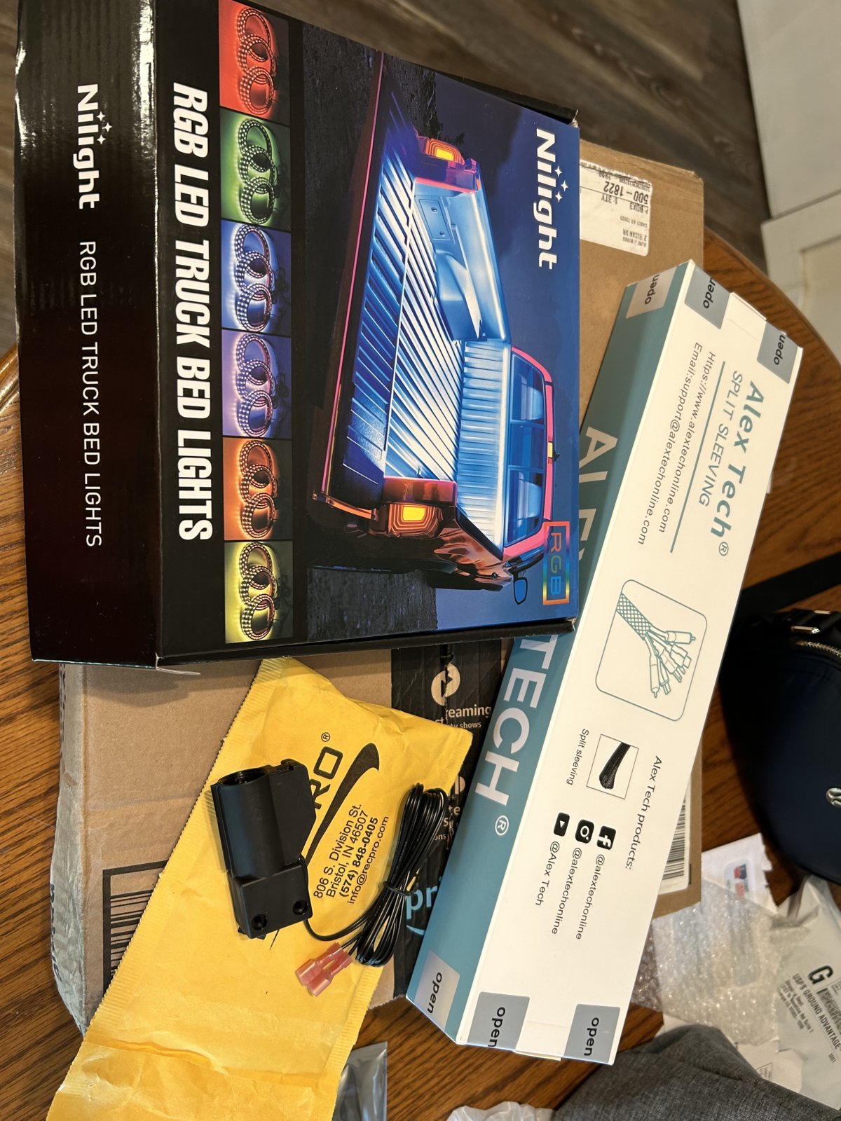

    Campershell lighting bits have arrived. Some Amazon prime day scores.

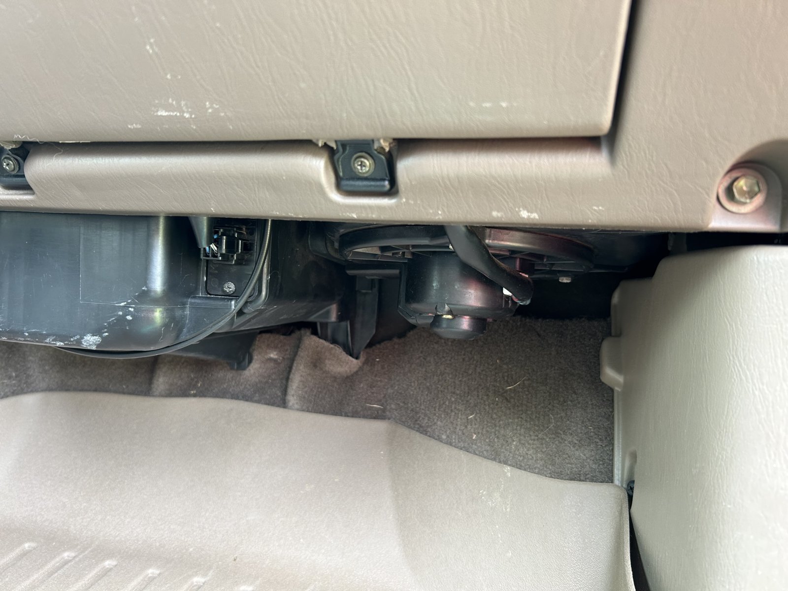

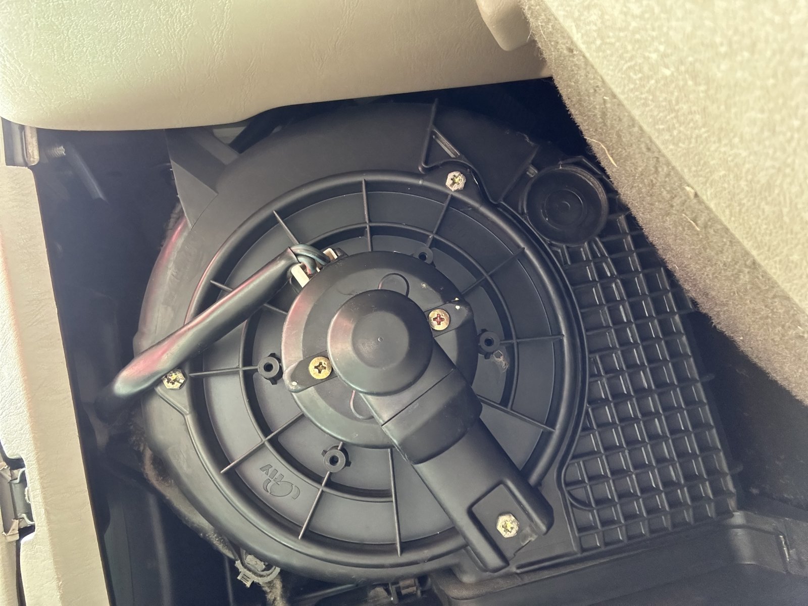

    Couple small things today:
    AC blower fan replaced. Super easy if you’ve never done it, one electrical clip and 3 bolts - 8mm. Lives under the glovebox.

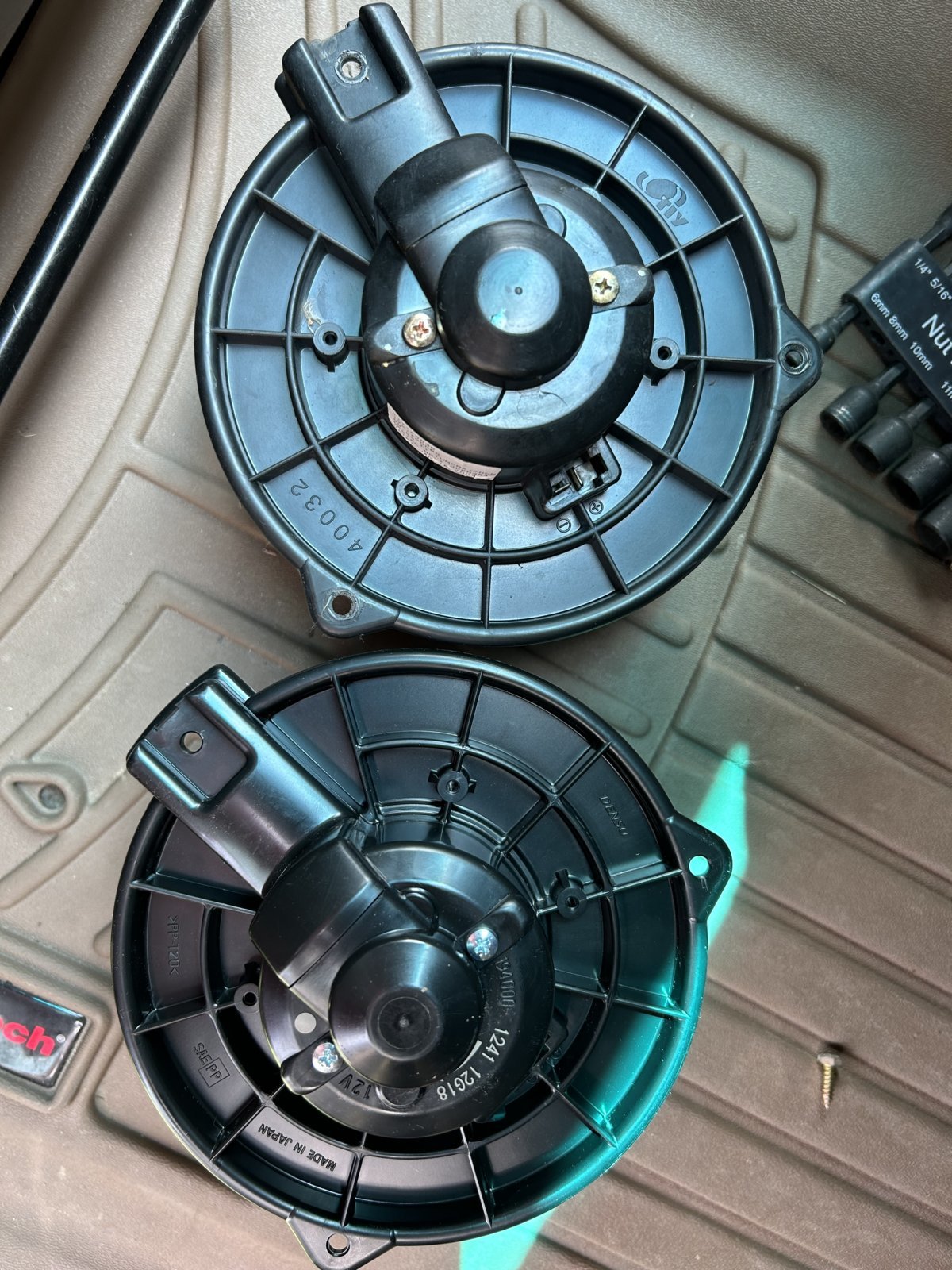

    My old non-oem replacement from 15 years ago. I broke my original trying to get the fan off to clean it.
    Old vs. new:

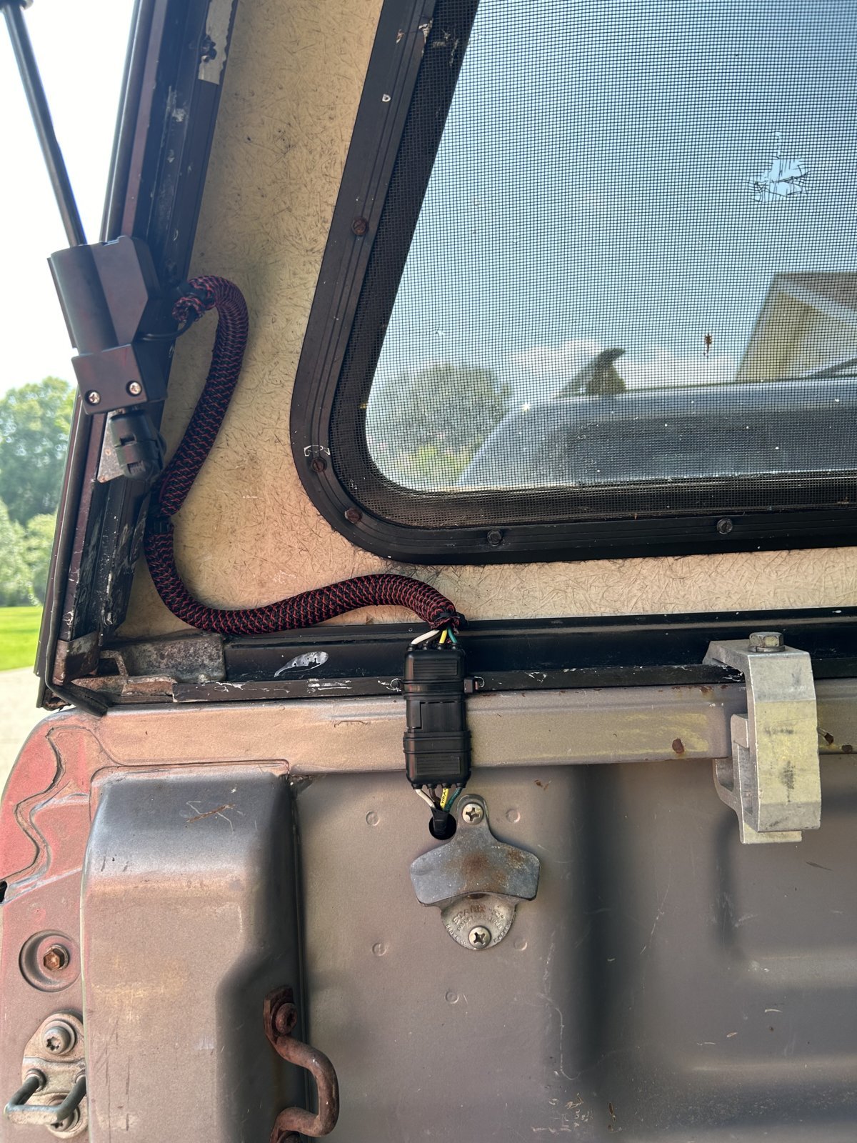

    Also added my strut switch for my topper lights and cleaned up the wiring harness with some loom and zip ties to secure. Will do the LED strip install later.

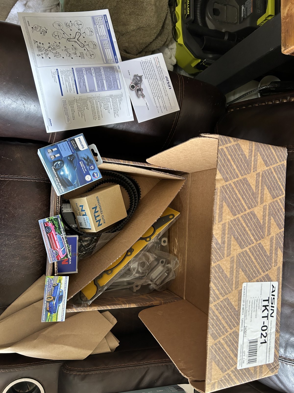

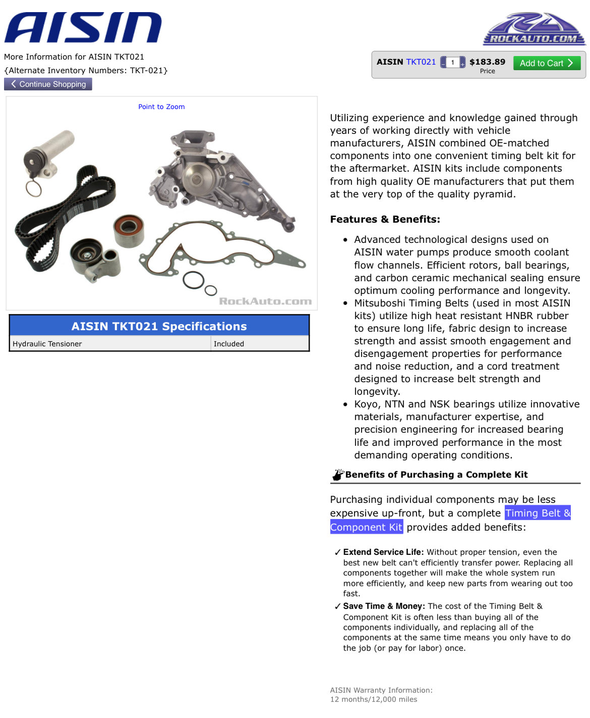

    More loot has arrived. Timing belt kit and new LED fog light replacements. Ordered the missing tie rod end, intake gasket and ball joint for the right side o_O. All told sitting around $1650 in parts (including exhaust). I would consider most of this stuff to be 10yr maintenance parts, so if it’s 10 years before all of this stuff needs to be done again, that’s not too bad.

    It’s a bit noisy. Whirring and whistling occasionally. Also had a mild bearing noise for years. New OEM is smooth and quiet and seems to have a bit more airflow.

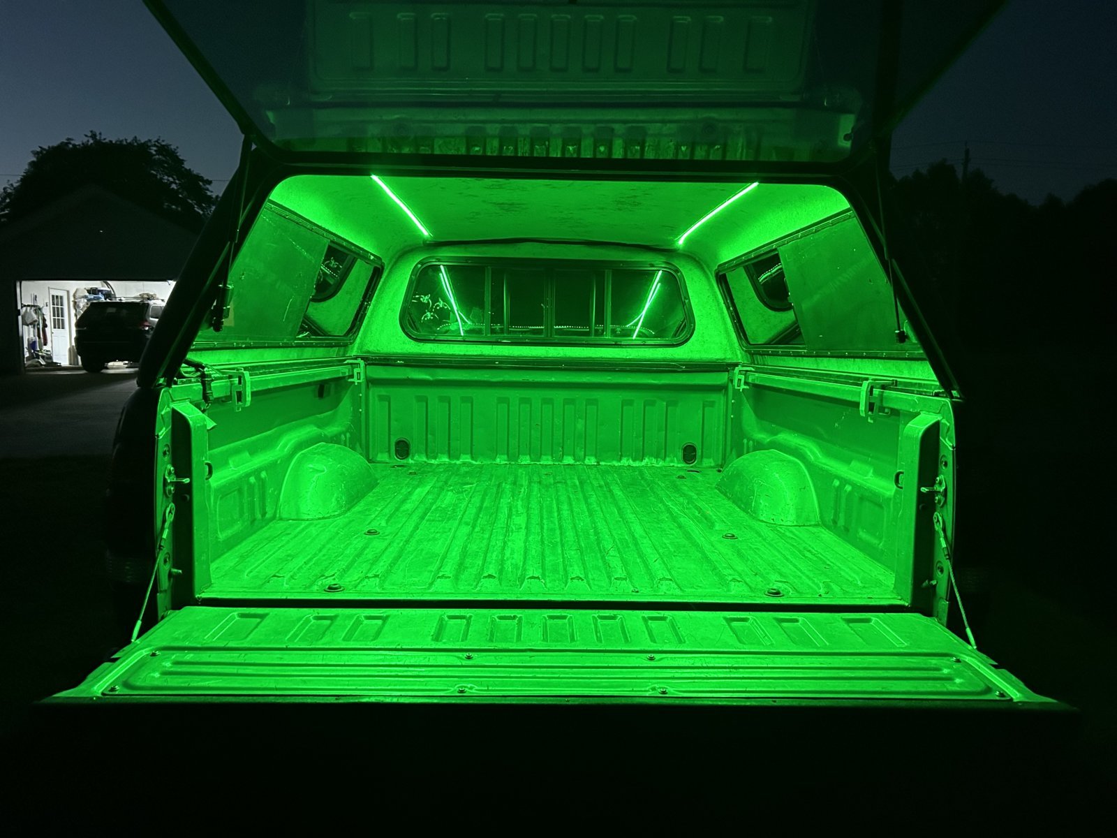

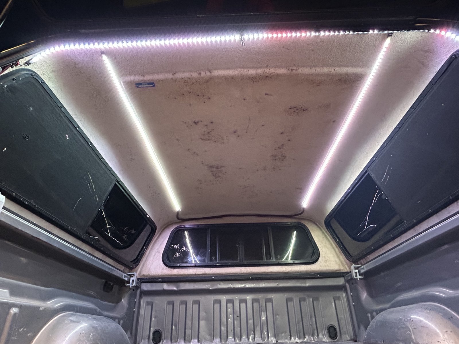

    Installed the camper shell lights tonight once the evil sun went down. Cleaned the wiring up as much as possible. We’ll see if the adhesive holds up, or if stronger stick ‘em will be needed.

    Also does fun colors and dances to the music cause, I like to party.
    activated by the prop rod switch, so they automatically come on when you open the cap.
