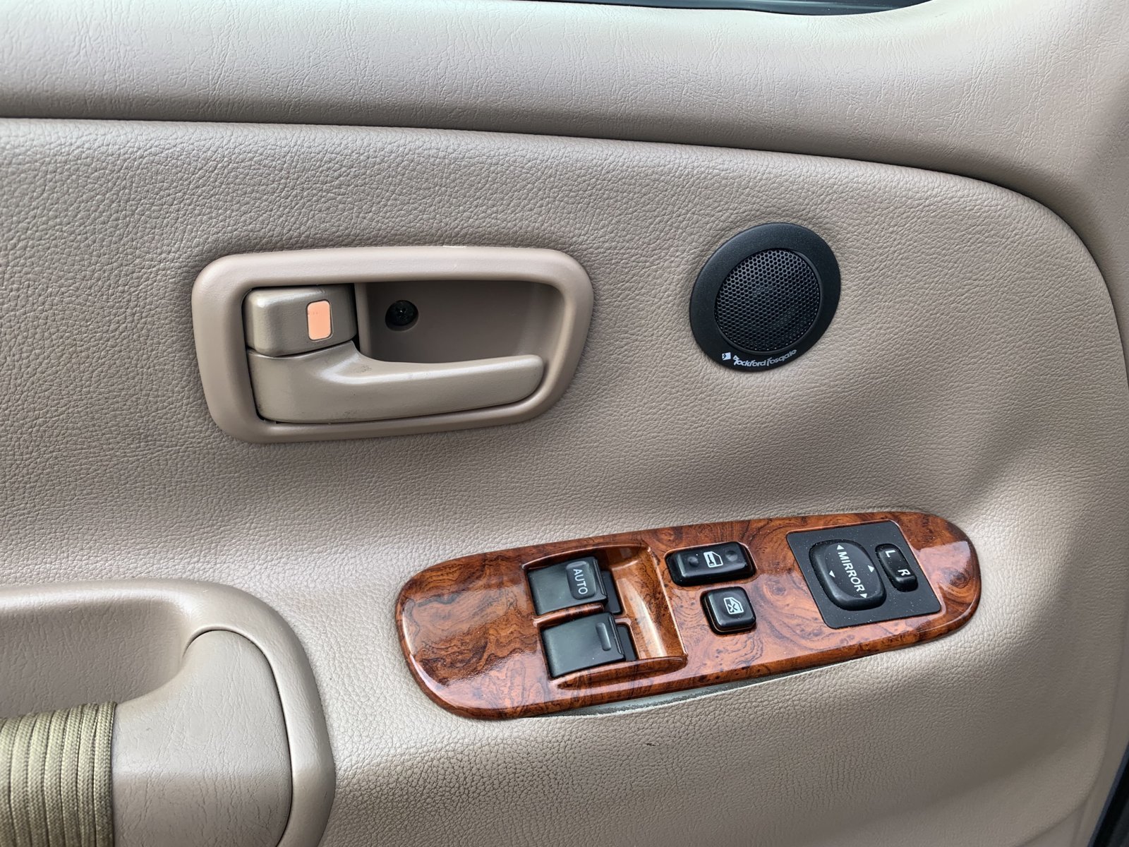

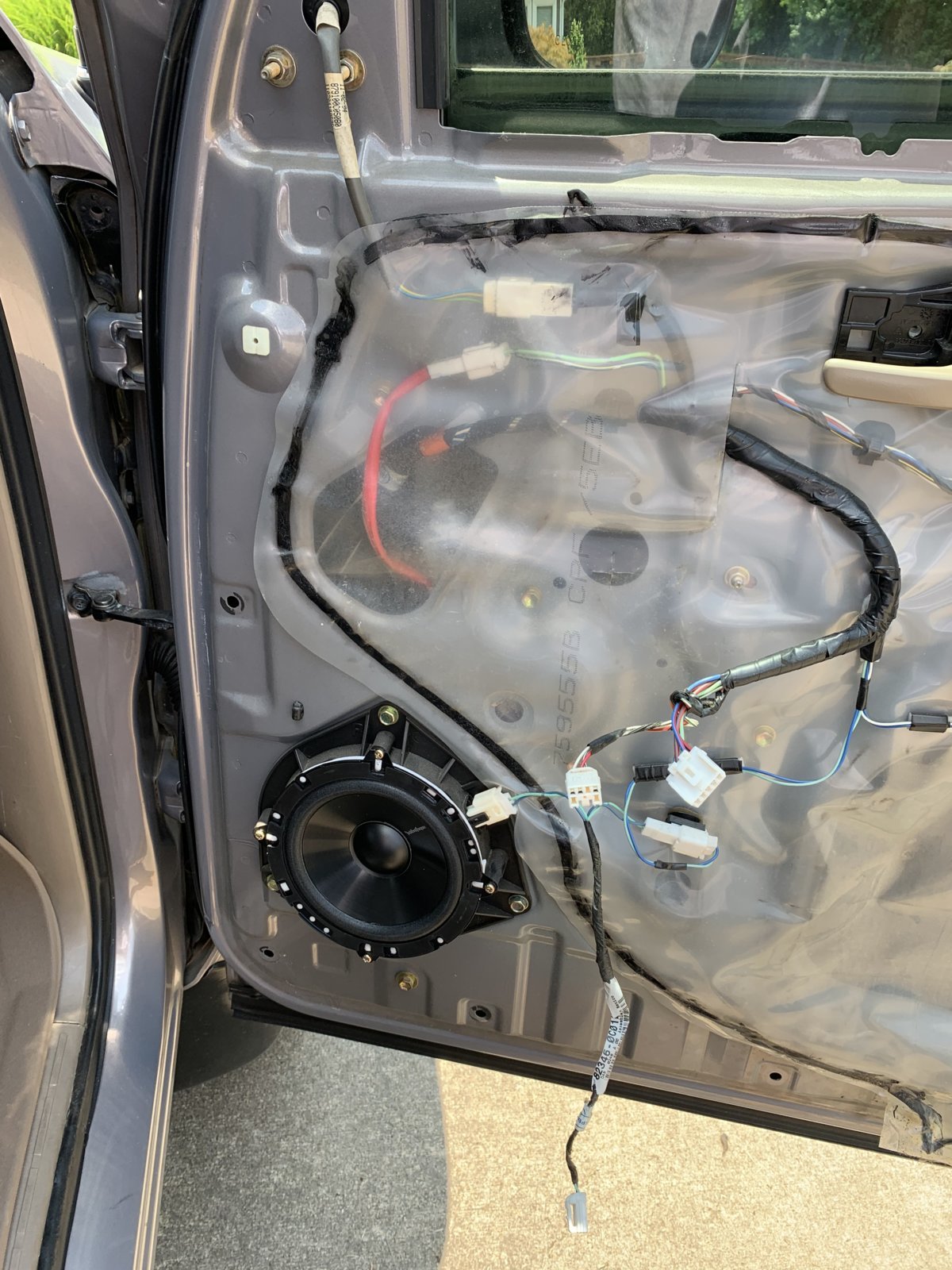

    Ok, I need to look into that. Got a link to the ones you bought? Do the tweeters fit in the stock location with or without modifications?
  11. Jul 2, 2024 at 10:25 AM
    #41
    KNABORES
    KNABORES [OP] Sarcasm incoming
    Jan 1, 2020
    #40572
    13,720
    Arkansas

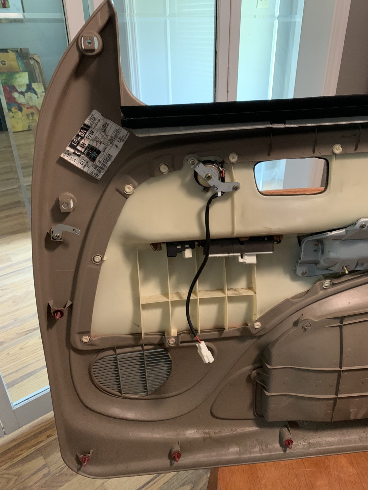

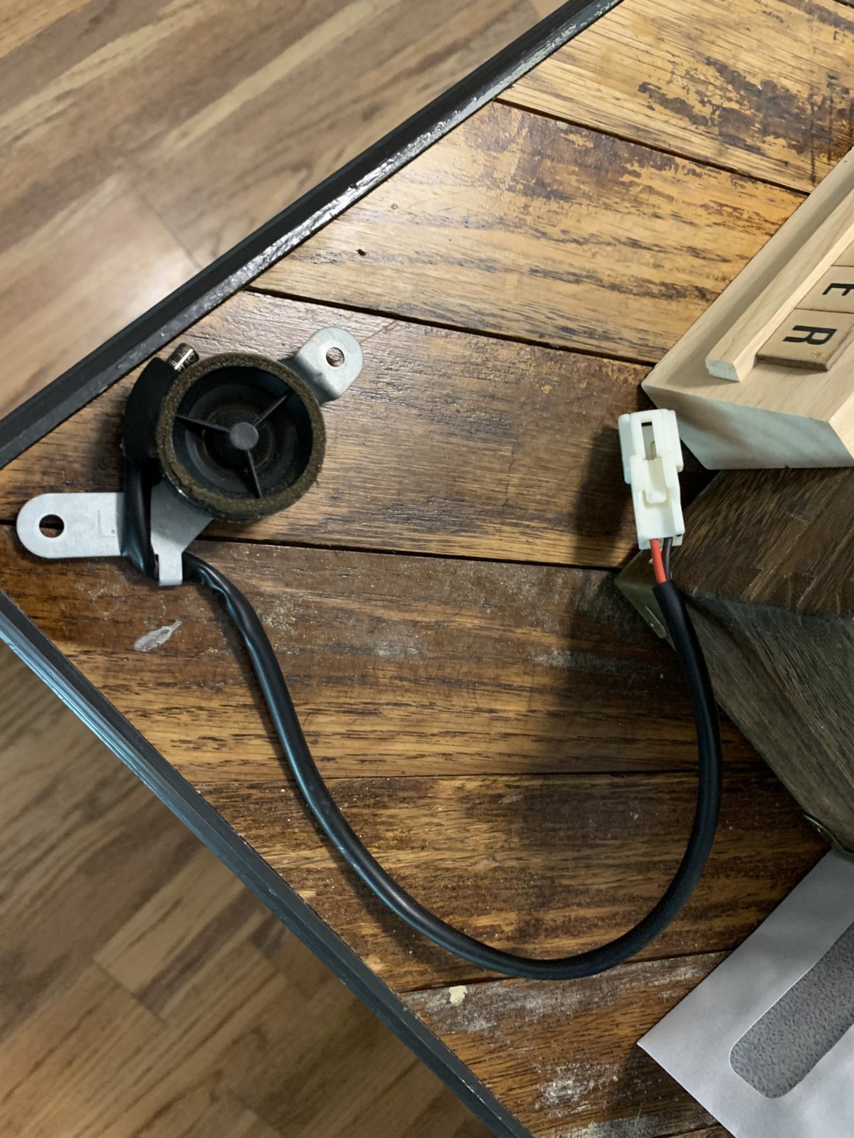

    I had to mod mine to add the Rockford separates I bought. Pretty much had to cut through the factory plastic welds and use the hole for the new tweets.

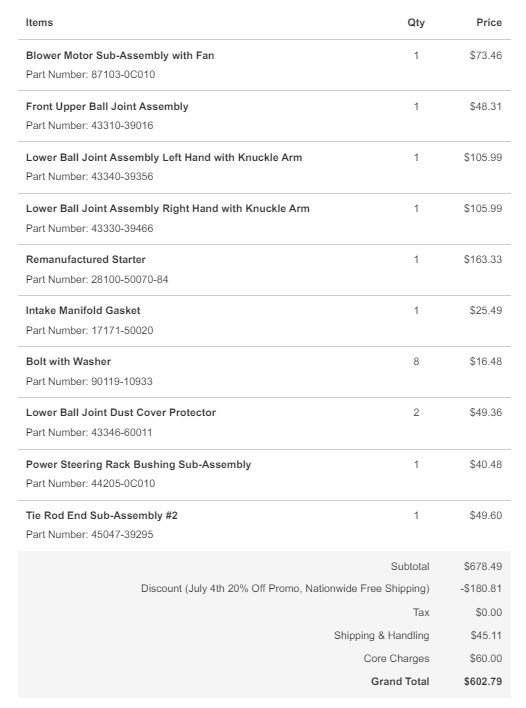

    Initial parts haul ordered for front end on the 4th of July discount special. Priced at three online parts dealers websites including the local dealership. Serra came out on top. This was $793 worth of parts pre-sale.

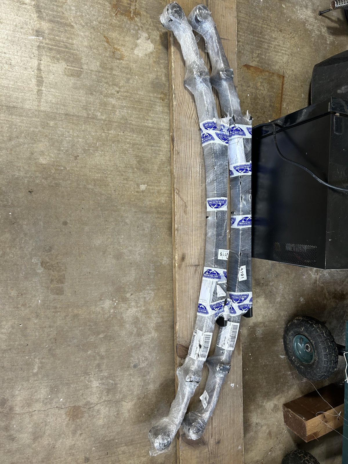

    It starts…

    How many leafs per pack?
  26. Jul 11, 2024 at 5:36 PM
    #56
    KNABORES
    Jan 1, 2020
    #40572
    13,720
    Arkansas
    5
  27. Jul 11, 2024 at 5:36 PM
    #57
    KNABORES
    Jan 1, 2020
    #40572
    13,720
    Arkansas
    If a man was gonna bastard pack at any point, which leaf would he rob out of his old pack and save?
  28. Jul 11, 2024 at 5:37 PM
    #58
    455h0le_dachshund
    455h0le_dachshund Tesler Thought Experiment
    Nov 21, 2023
    #107257
    7,171
    Reverend Hotdog
    TX...big surprise
    5 plus overload or 4 plus overload?
  29. Jul 11, 2024 at 5:38 PM
    #59
    455h0le_dachshund
    Nov 21, 2023
    #107257
    7,171
    Reverend Hotdog
    TX...big surprise
    The trick is to look at em side by side and see which leaf would fit where in a progressive fashion. Think stair steps.
    KNABORES[QUOTED][OP] likes this.
  30. Jul 11, 2024 at 5:38 PM
    #60
    KNABORES
    Jan 1, 2020
    #40572
    13,720
    Arkansas
    4 plus overload. Factory pack and OEM replacements are 3/1 rated for 1500#. These “HD” variants are 4/1 and rated for 2000#.
