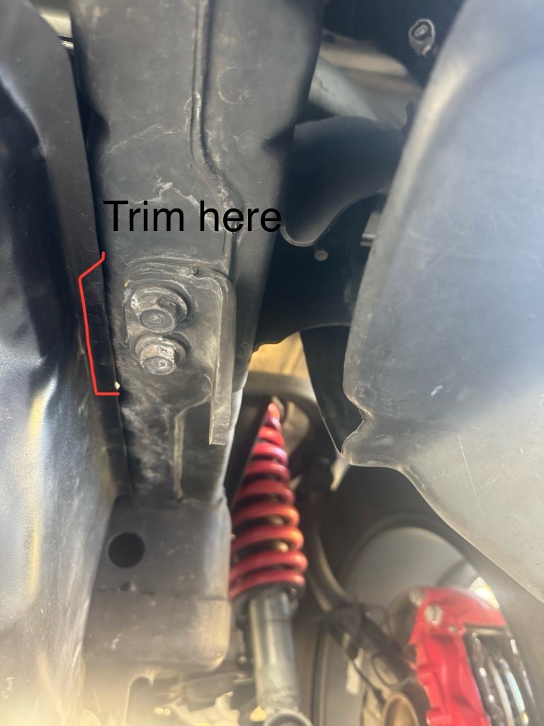

    Yeah, I looked this morning in the daylight and they will fit. Mine is definitely different and would not require the skid plate modification
    Not sure they will be visible. I believe the frame where mine are mounted is higher. Believe I'll still add them

    just have to trim the skid plate ear a little to fit these

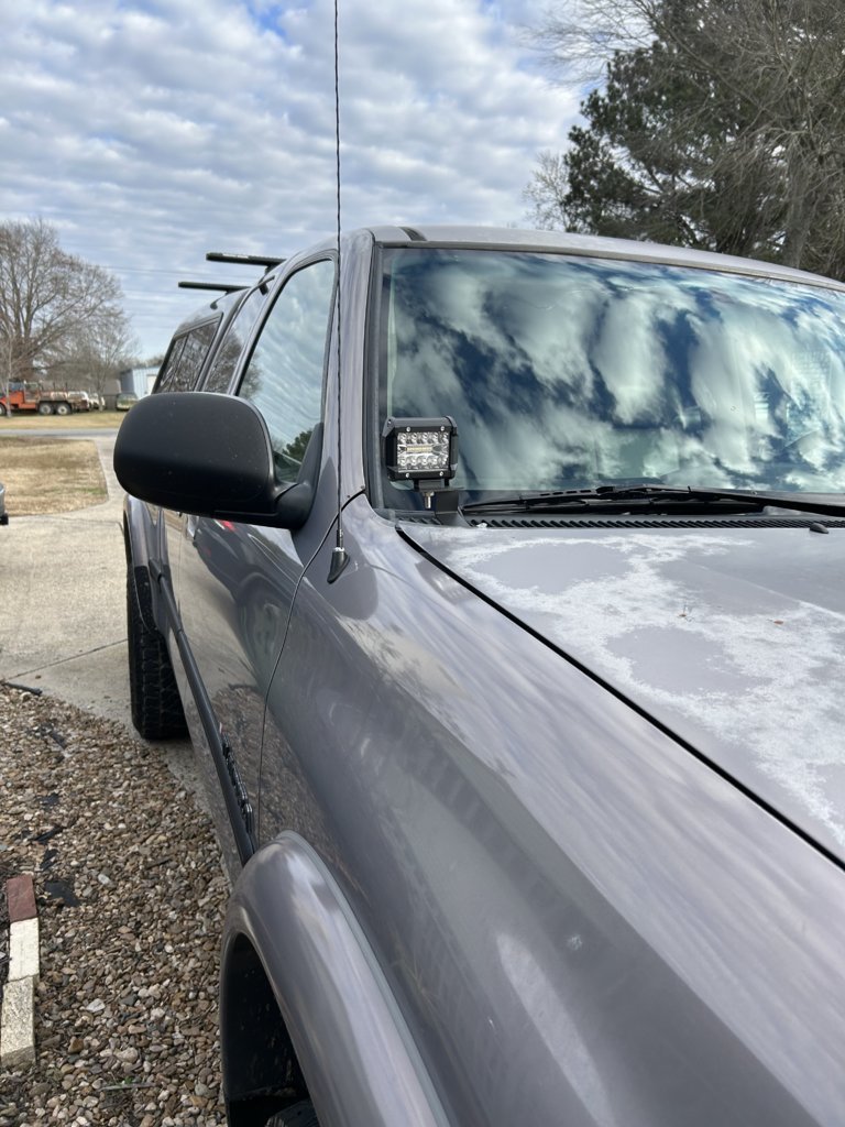

    After much deliberation as to where to mount my 20" lightbar, I've decided that it looks best........ nowhere on my truck. Going the ditch lights route instead. Ordered some Tacoma hood brackets and some three row compact 3" lights to mount on them. Had good luck and performance out of my 20" Nilight LED 3 row bar, so gonna try the pod lights of the same design.

    So what you gonna do with that light bar?
    I'm thinking mount it sideways over the 3rd brake light on your cap, facing back, slightly tilted down.
    Use it for backing up, for lighting when camping, and for blinding tailgaters

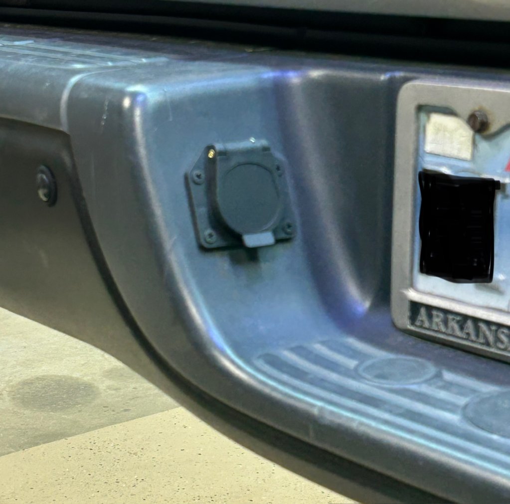

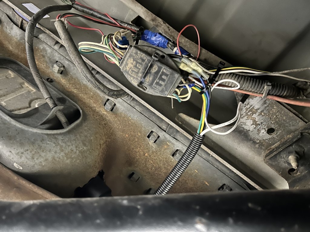

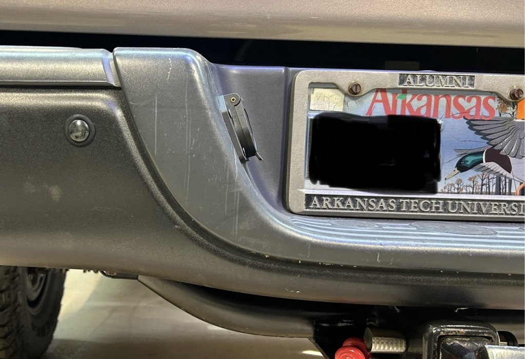

    Got under the truck and cleaned up all of the trailer harness wiring. It was a mess. Hooked up the new 7 pin in the bumper. Attached the 4 flat under the bumper stealth mode. Scrapped the old 7 pin that was hanging down and had the 4 flat tied around it. Also fixed my backup camera so it actually activated with reverse instead of just popping up every time I start the truck. Looks cleaner and feels good to have the rats nest gone.

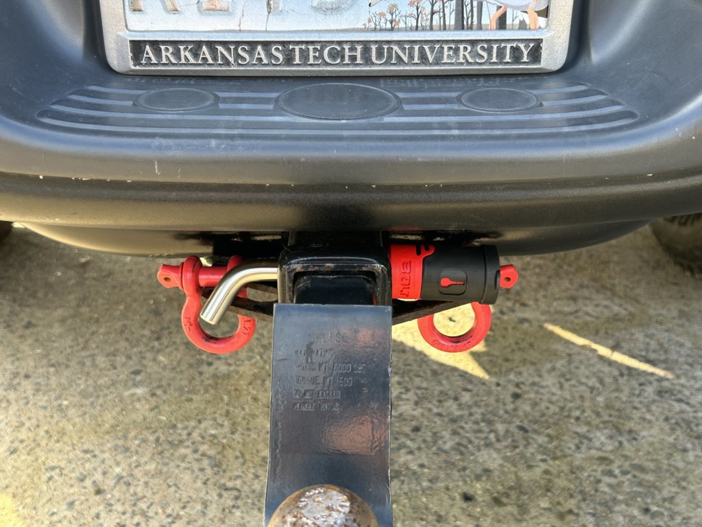

    Couple things came in today.
    ditch light brackets. These are listed for Tacomas of the 05+ vintage, but they will work with some mild modification. Widen the mounting holes slightly and bend some of the angles to match the lines. Clears the windshield as is now.
    also my BOLT hitch lock that is keyed to the trucks ignition key. Loved this on my other truck, handy.

  13. Dec 23, 2024 at 6:40 AM
    #283
    Weagle
    Weagle I survived my timing belt change
    Sep 24, 2023
    #104402
    1,070
    Prattville, AL
    2006 Tundra SR5 DC 4.7 2WD LSD towing pkg
    Bilstein 5100's with 2883's - close to 2" Replacing the 2883's and going back to the bottom perch ASAP -mobile/apple play stereo with sub and backup cam -Power stop HD front calipers and rotors for towing -20" wheels with 32" tires (305/50's) Toyo AT 3's with no rubbing -Westin nerf bars -Detroit axle new (not rebuilt) steering rack with poly bushings, inner and outer TRE's -Suspension Maxx extended front sway bar links -Overland tuning - medium level -Power front leather seats and steering wheel from 06 Sequoia -fully de-chromed/blacked out trim -all light housings incl 3rd brake light and tag lights replaced with smoked lenses, LED where appropriate -mini projector headlights -fully rebuilt trans and new torque converter -new complete drive shaft with spicer u-joints and carrier bearing -all LED interior lights including backlighting -new lower window seals for all 4 doors -all new hardware and clips for tailgate Next: Dirty Deeds racing exhaust with LT headers, yellow box, 12 hole DD fuel injectors, redo or replace door panels

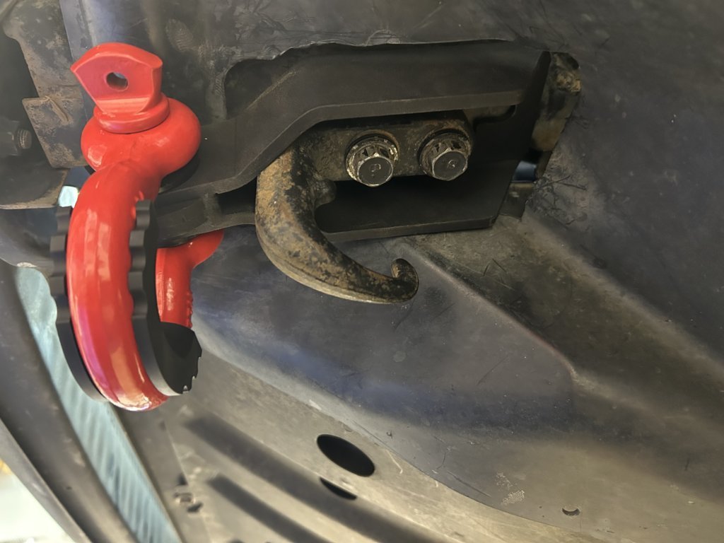

    just to confirm, my 06 is the same as yours. I ordered the wrong ones - mine are black with red rubber instead of red with black rubber like yours, but still a good addition
    Edited to add that on my '06 DC I did not need to modify the skid plate

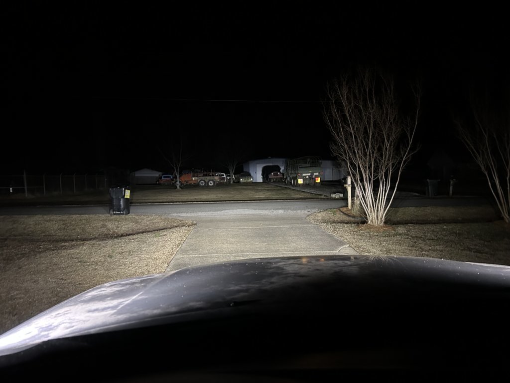

    So ditch lights are wired up and aimed to be outside of the headlights reach. With just ditch lights on they look ok. But with the headlights on, I can’t tell the ditch lights add anything really. My LED fogs do an amazing job of filling both ditches currently. Probably gonna switch to one of the dual projector amber style to lower the profile and up the light output. These are merely truck jewelry and aren’t adding anything function for me.

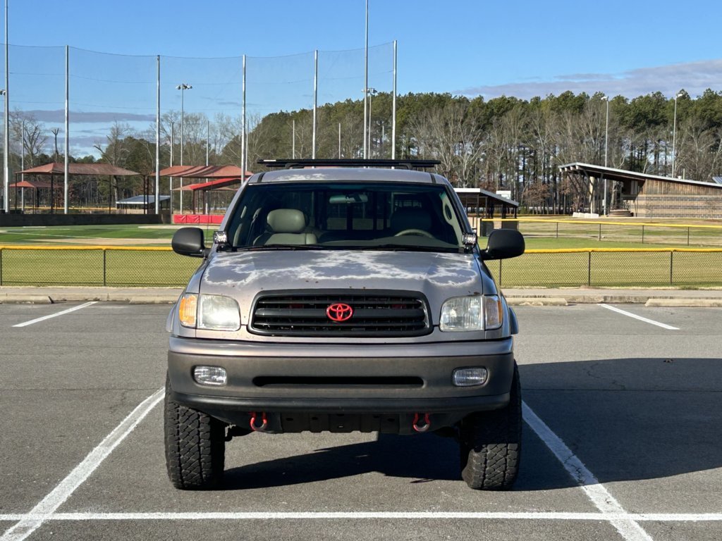

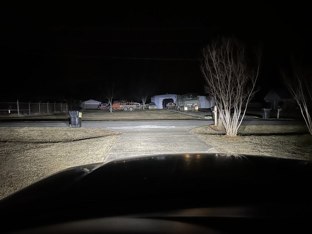

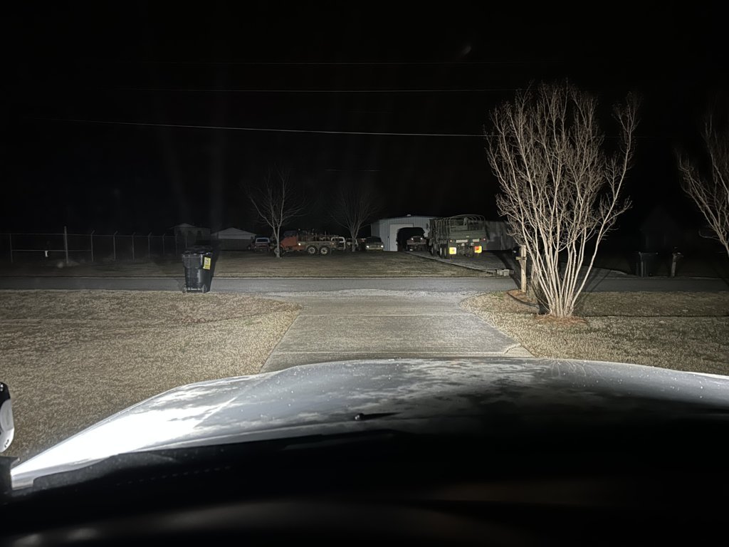

  21. Jan 7, 2025 at 4:27 AM
    #291
    KNABORES
    KNABORES [OP] Sarcasm incoming
    Jan 1, 2020
    #40572
    13,718
    Arkansas
    Pics
    Installed
    Ditchies
    Headlights and foggers
    all on

  22. Jan 7, 2025 at 4:43 AM
    #292
    455h0le_dachshund
    455h0le_dachshund Tesler Thought Experiment
    Nov 21, 2023
    #107257
    7,171
    Reverend Hotdog
    TX...big surprise
    Why does it look brighter with headlights and fogs vs all on?
    BroHon likes this.
  23. Jan 7, 2025 at 4:50 AM
    #293
    KNABORES
    Jan 1, 2020
    #40572
    13,718
    Arkansas
    Probably just the camera adjusting. In real life it looks the same. No difference when the ditchies are on. To be fair, I did not point them way out to the sides. And I really don’t need ditch light fill to improve my lighting, I really need more mid range and distance fill in dark rural driving. So it’s not the lights fault, I’m just looking for something different. Some of these may do the trick
