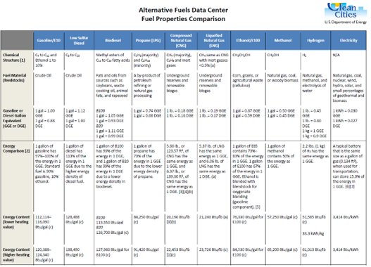

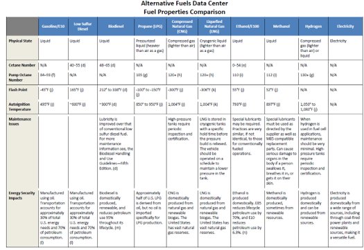

    Here's what I learnt.
    vs. Gas
    Ethanol has higher octane. ~110
    Ethanol has lower BTU.
    and ...you can pick your octane, but you can't pick your BTU.
    Gas is gas.
    since adding corn to gas will lower it's btu's - Gas with corn is not as good as non-corn gas.
    facts below.

    Cute picture. Show me the scientific evidence that 87 octane has less btu than 93 octane. Show me numbers since you believe in numbers. I posted my evidence and that’s what I go by. I am not going to just change my mind because some guy on the internet posted a pic and said so. I am sure that the thousands to hundreds of thousands high mileage vehicles still running out there didn’t all run 93. I am also sure that they have more money in their pockets, since 87 is cheaper. I am also sure that there is no scientific evidence that 93 will make an engine last longer. Just there is no evidence that expensive oil will make an engine last longer. If so the million mile tundras beg to differ. And if 93 is so great, why not just make 93? I mean, I am sure 93 will burn perfect in a 7-1 or 8-1 compression engine.
    If your not going to show me an experiment done on different fuels, stop replying with long and small hydrocarbon chains.
