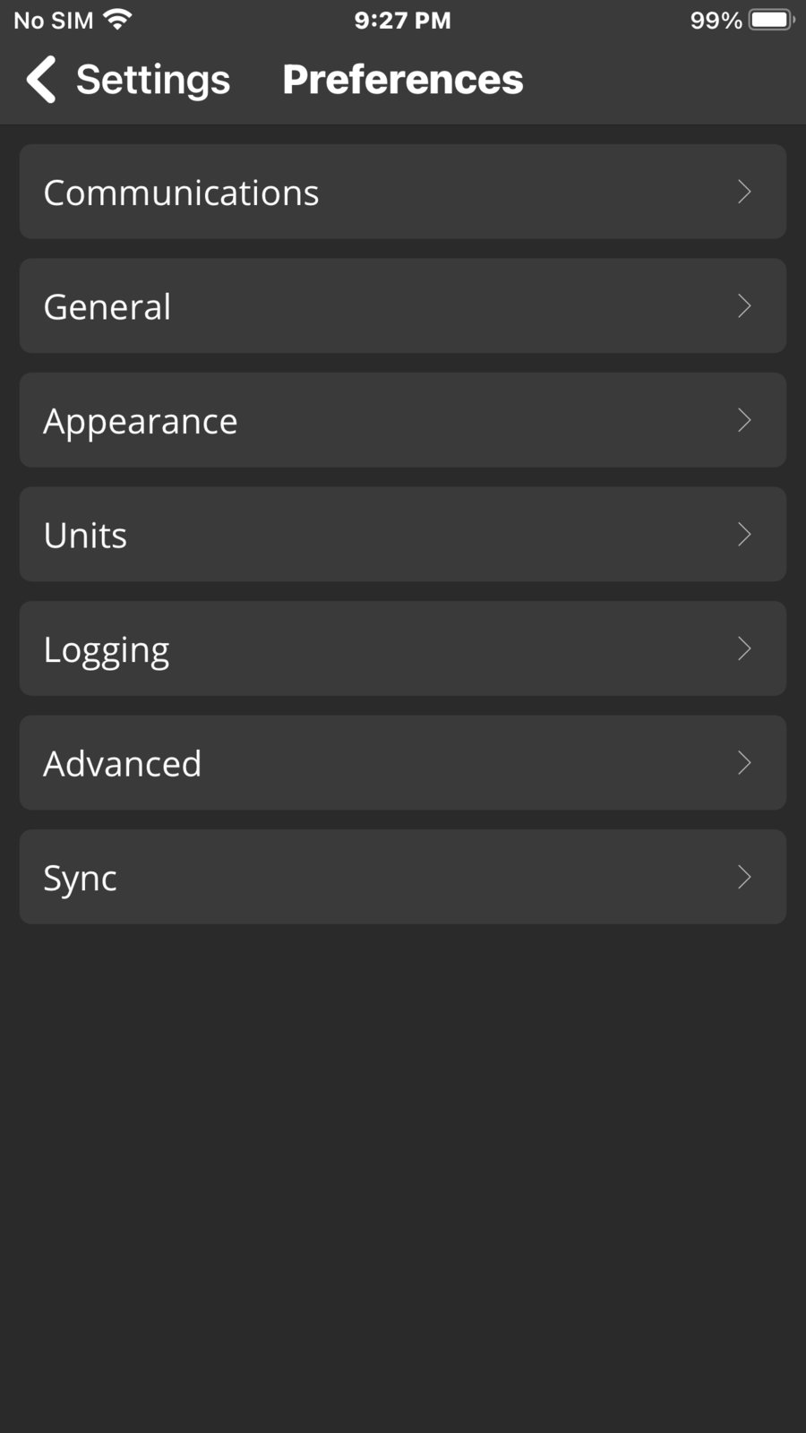

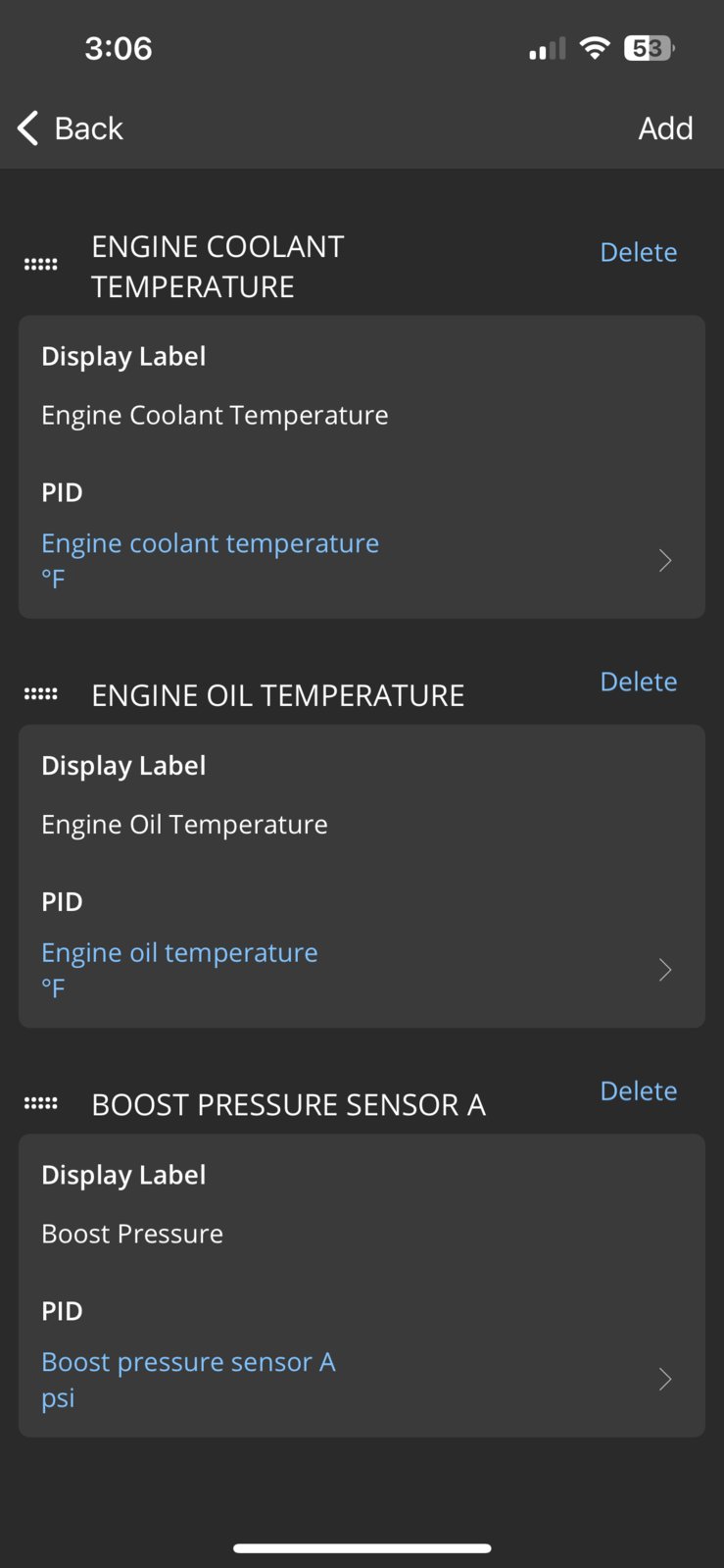

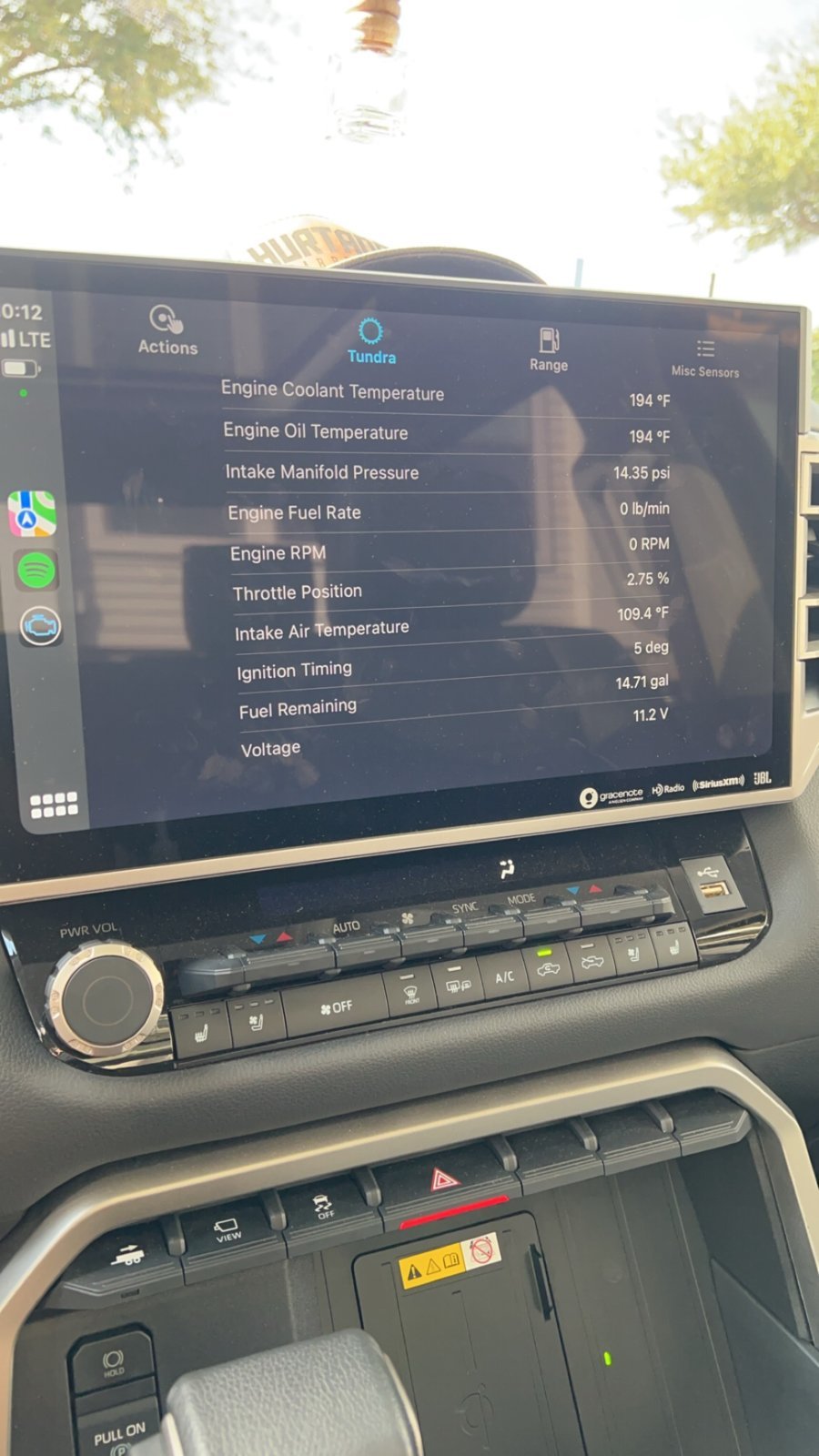

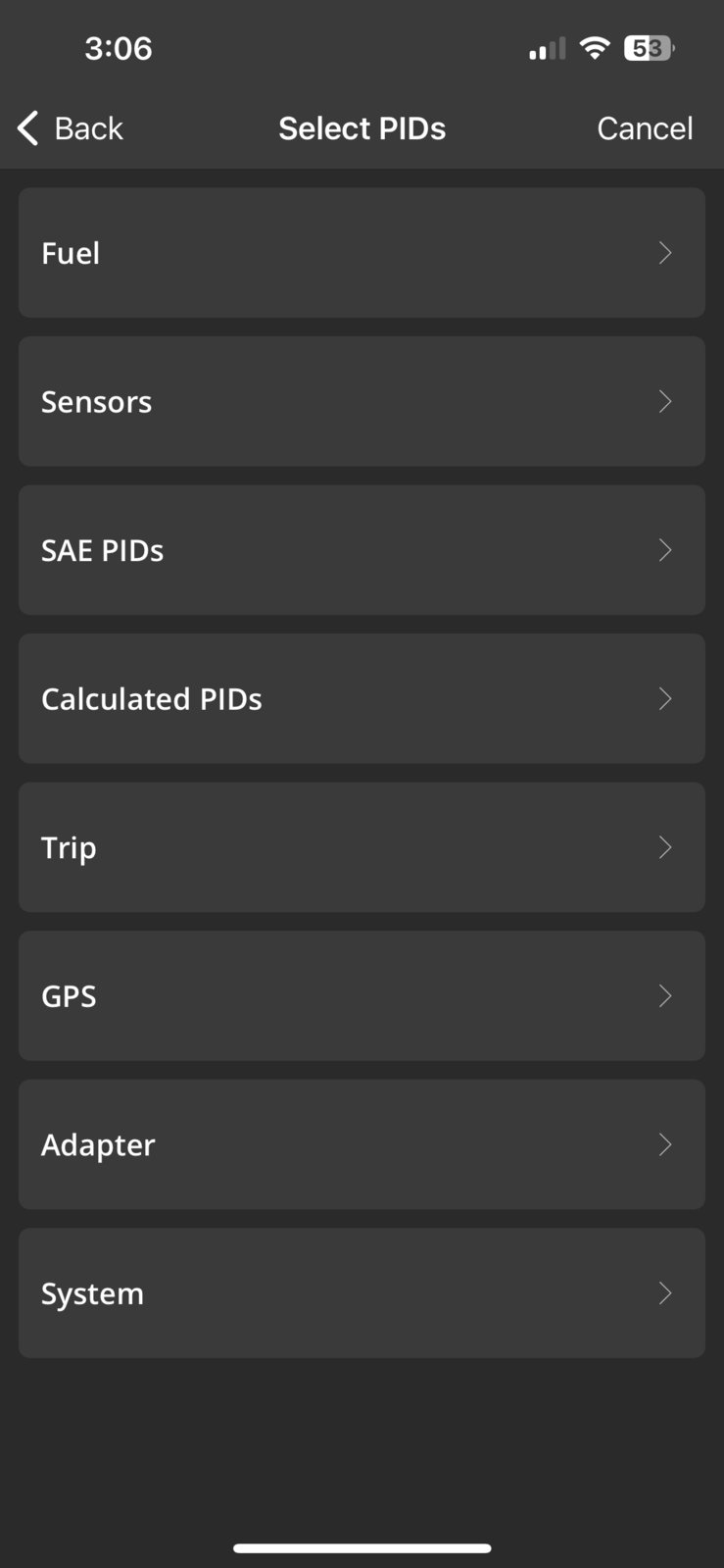

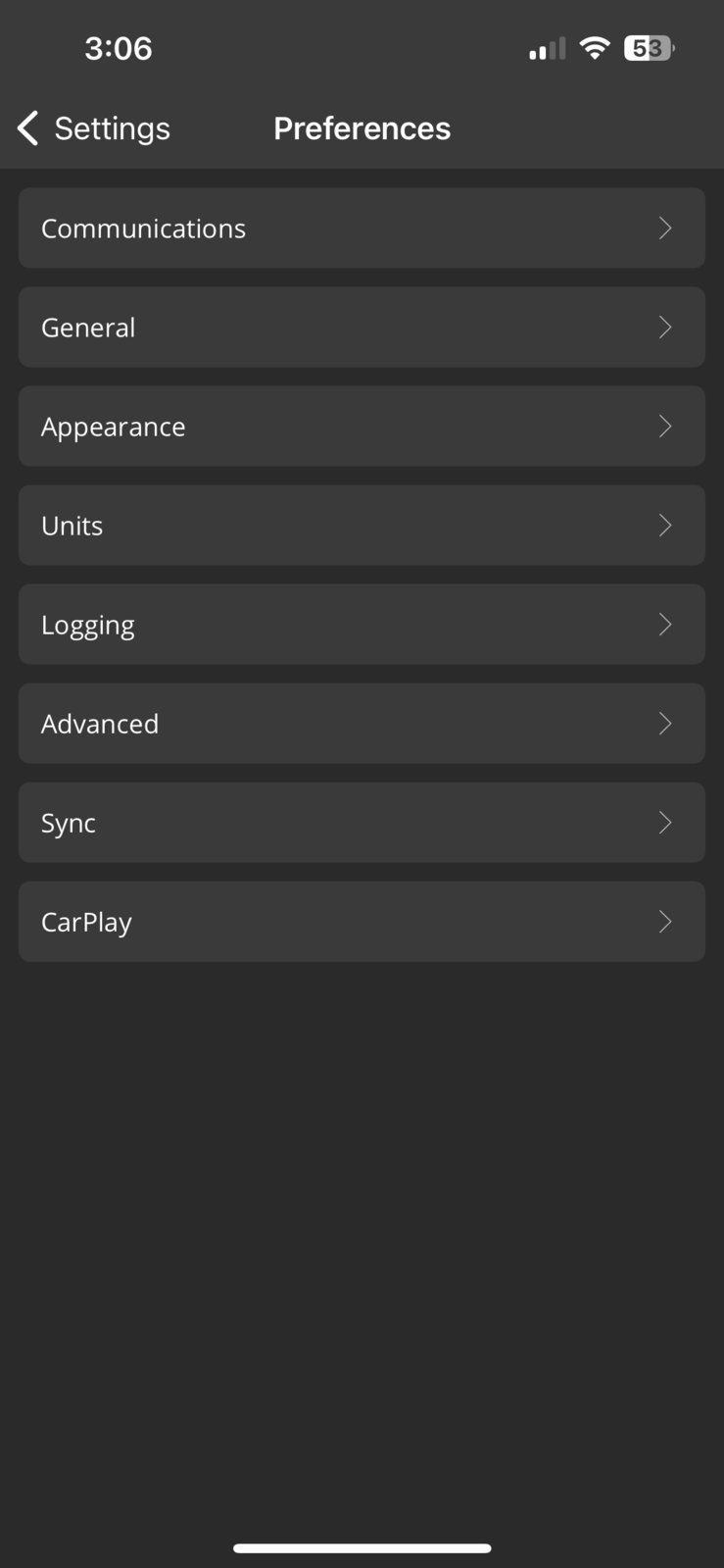

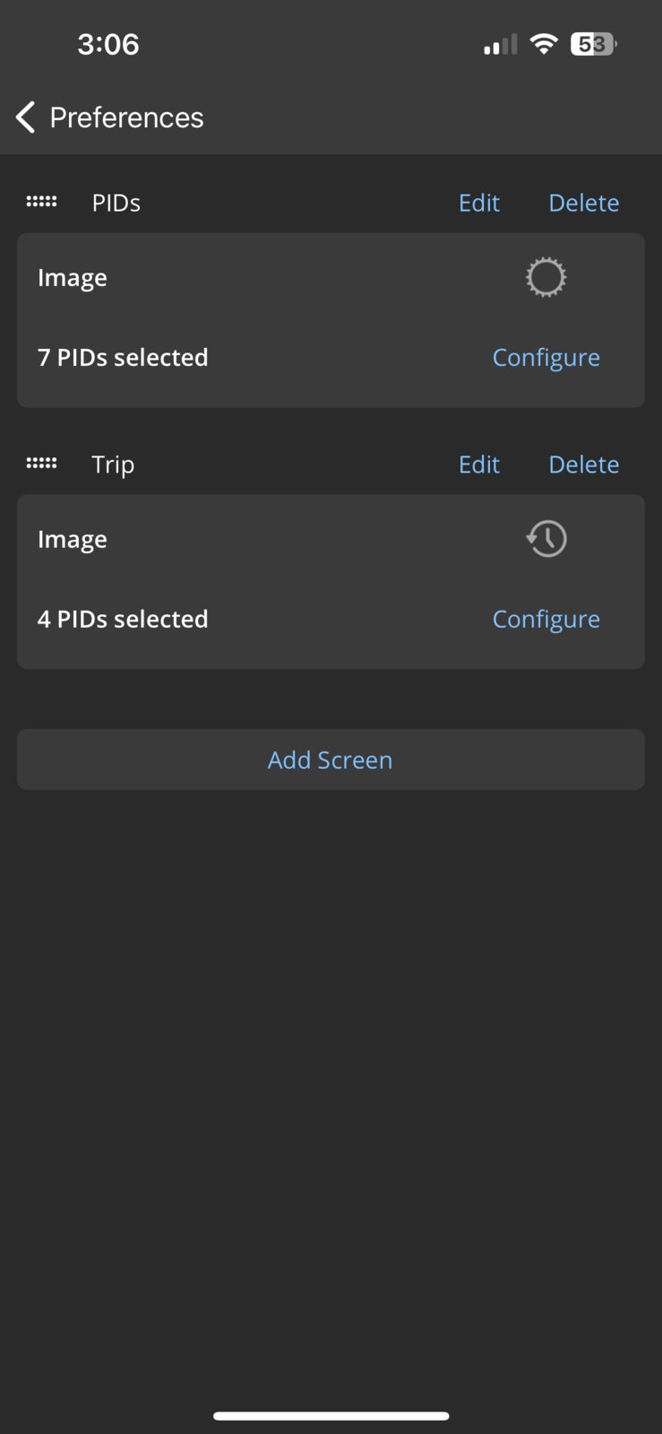

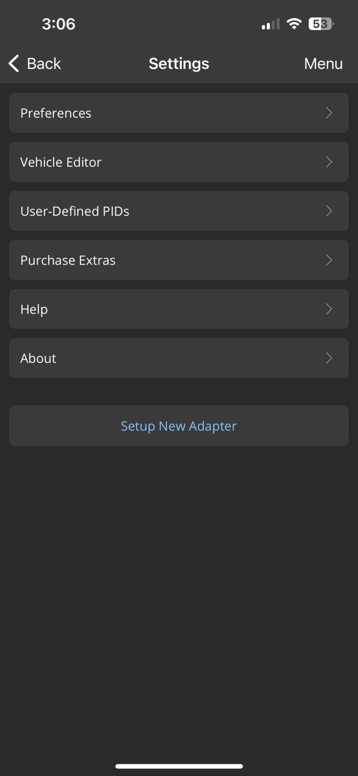

    OBD Fusion Support for CarPlay:
    If you have OBD Fusion downloaded on your iPhone (not sure about Android) Fusion should show up on your home page in CarPlay. If it's not make sure to enable it from your phone settings.
    @Gaston is right about no gauges we are limited to numerical values.
    You add can PIDs to Display on CarPlay by following these steps:
    Go to Settings.
    Go to Preferences.
    Go to CarPlay.
    Now you can see your pages and their PIDs. To add a sensor click configure. To change the logo of the page select an image. To change the name of the page select edit.
    To edit existing PIDs simply click on them and follow the next step. You can customize the display name logos and names of pages.
    This is the list of sensor groups available for me.
    After this, you can see the sensors available for your truck. Select the one you want displayed and it’ll be added to the page.
    This is one of my pages as an example:

    I agree gauges plus peripheral vision would be more helpful but we are limited to CarPlay's input-output regulations according to Fusion. Max PIDs per page is limited to 10 but this is a solid foundation to build off of hopefully they add more features.
