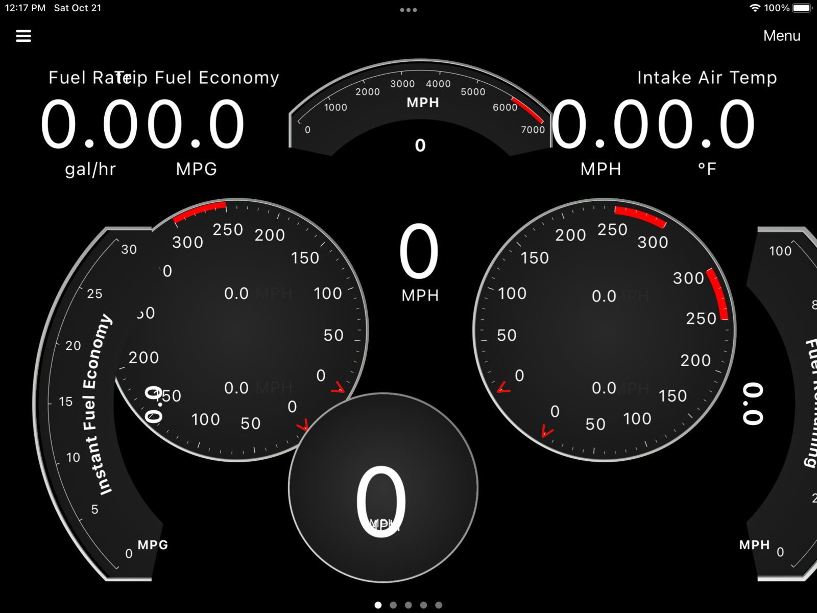

    Here is my contributions if I may?
    Scanner: Veepeak Bluetooth BLE, Am a zon, $26 bucks…
    Monitor: IPad Mini, second gen, running iOS 15.7.9…
    Software: OBD Fusion, I have not bought the extended PID package.
    I was waiting for the scanner to arrive, before buying the extended package, just to make sure it all worked, lol!
    Just for fun, I used Dropbox, (Which used to be free years ago, and now they want 12 bucks a month, Oh heck no!) to download a generous users configs…
    BIG TIP: Make sure you ARE NOT using the “Advanced mode” setting in the prefs as it prevents proper import of files. If it is set to on, the import will fail….
    Here are my results, don’t worry, I’m going to delete everything and start over to be sure… I just thought it was hilarious how these files looked after installing them.
    NJOY! And really, Thx to everyone contributing so far! Such Fun!!!

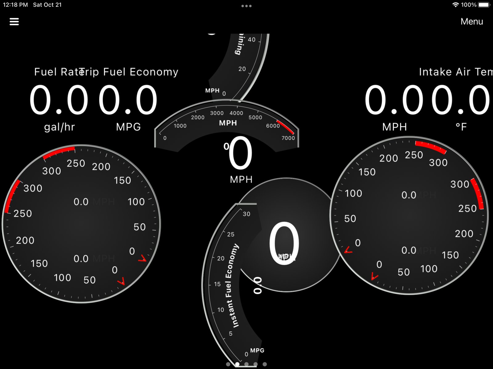

    Next day UPDATE:
    So, I’m getting some activity on the default gauges… so I know the kit kinda works. It just seems to be configuration related.
    And I have successfully imported a few dashboards from others…
    They have much newer trucks than mine.
    so, most all of their transmission gauges show up as mpg or mph….
    And, I can’t find a few of the pid’s that I’m mostly interested in such as
    tire pressure and transmission temps…
    Are any of my fellow FGT’ers (2002) running this software combo?
    Software: OBD Fusion, with the extended PID package for the 2002?

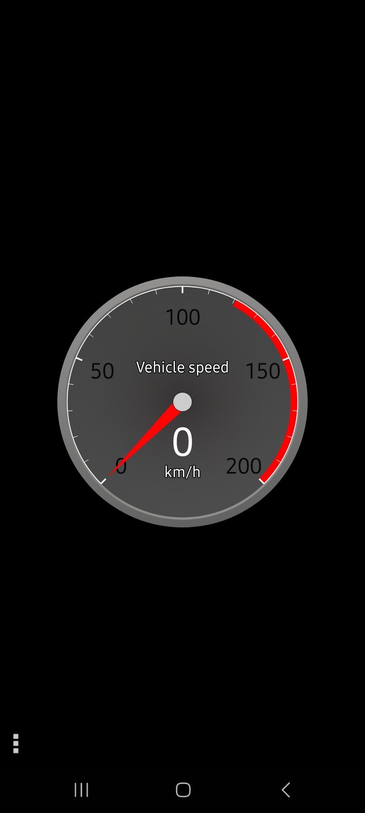

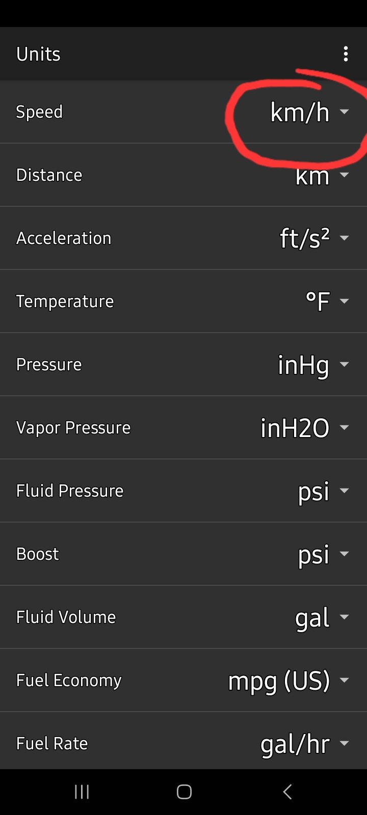

    Got my Veepeak today! every time i upload a dashboard, they're all labeled as MPH, because that's the default i think, any chance you could share this dashboard with me? or are you using Iphone too? :frusty:

    Just looking at it. Go to setting and change the units to kph then it will show kph on the gauge.
