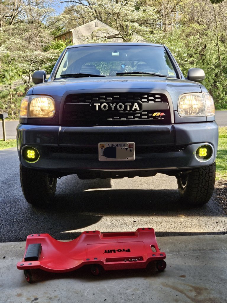

    So unfortunately, I did not have any oem halogen fog lights with which I can troubleshoot.
    I did, however, just use a voltmeter and found that I am getting 12v when the switch is on, and zero when it's off.
    Also, needless to say, i can hear the relay open when I flip the switch on the stalk.
    I would assume, although I never had this issue on my 2006 4runner, that I may need to install resistors, or something, going into the new LED bulbs?
    Any experience on this, gents?

    Ok. Problem solved. I believe the actual electrical connection housing is installed backwards.
    In the position where they actually "click" into place, the lights don't work.
    Flip them around, and they work, but don't "click" into place.
    Appreciate the help. Stupid that I didnt figure it out quicker. I'll contact the manufacturer.

    So far, in the one night I've had them, they seem good for the price. Nice wide spread in front of the truck. Doesn't extend incredibly far out in front. I was worried they would rattle, since they aren't bolted on, but they seem solid. Other than the connector issue, I'm happy with the purchase. Right now I have the connectors electrical taped.
