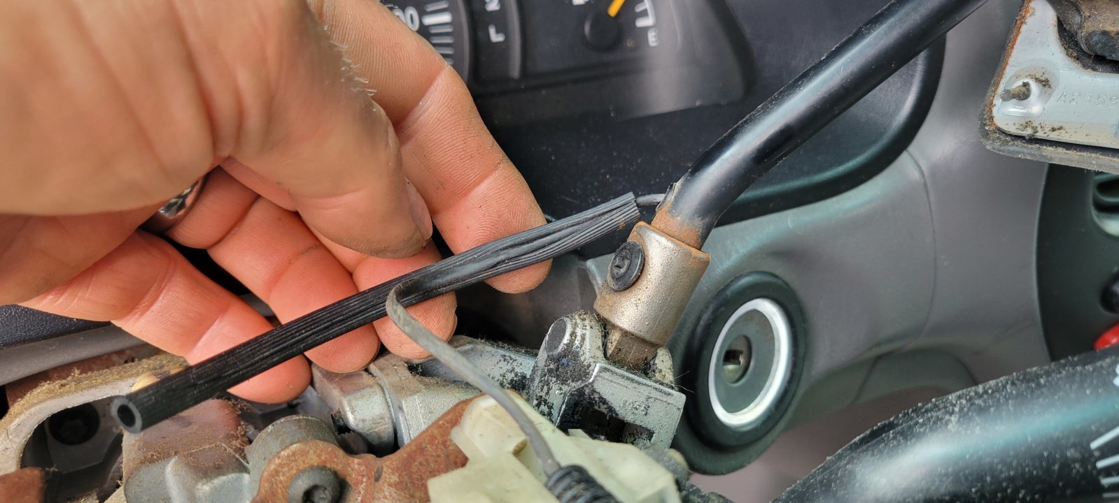

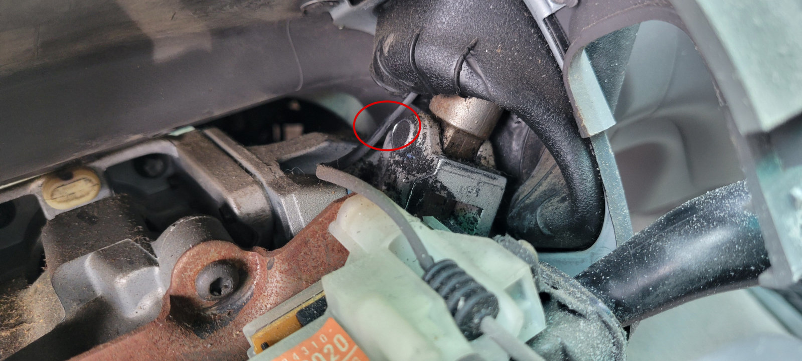

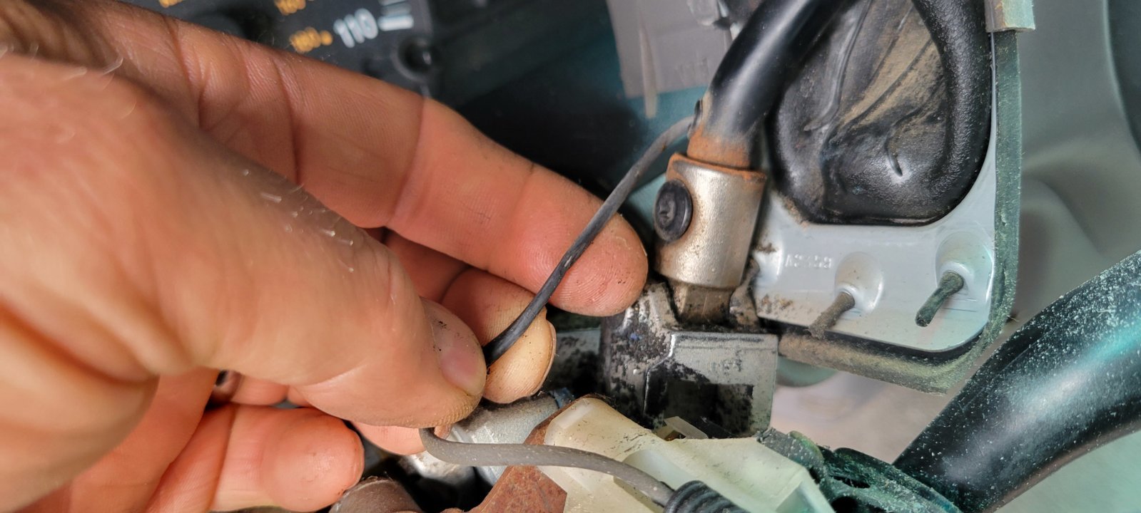

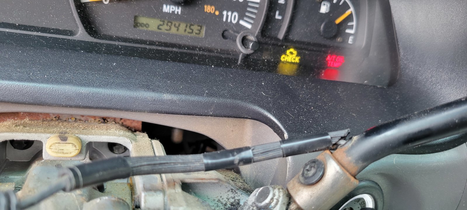

    Blinking/more like sporadic shorting in my O/D off light. Found chafing on the wire as described in the video.
    Screws on each side right here, and one in plain sight below.
    As it appears when you open it up, and where the rubbing takes place.
    Better view of chafing.
    I used some small tubing like vacuum line to protect it. (Not sure where I got this tubing but its not vac line)
    This averted a future problem for sure, but the light still sporadically blinked. So I removed the LED in that socket and returned the original incandescent... Problem fixed :anonymous:
