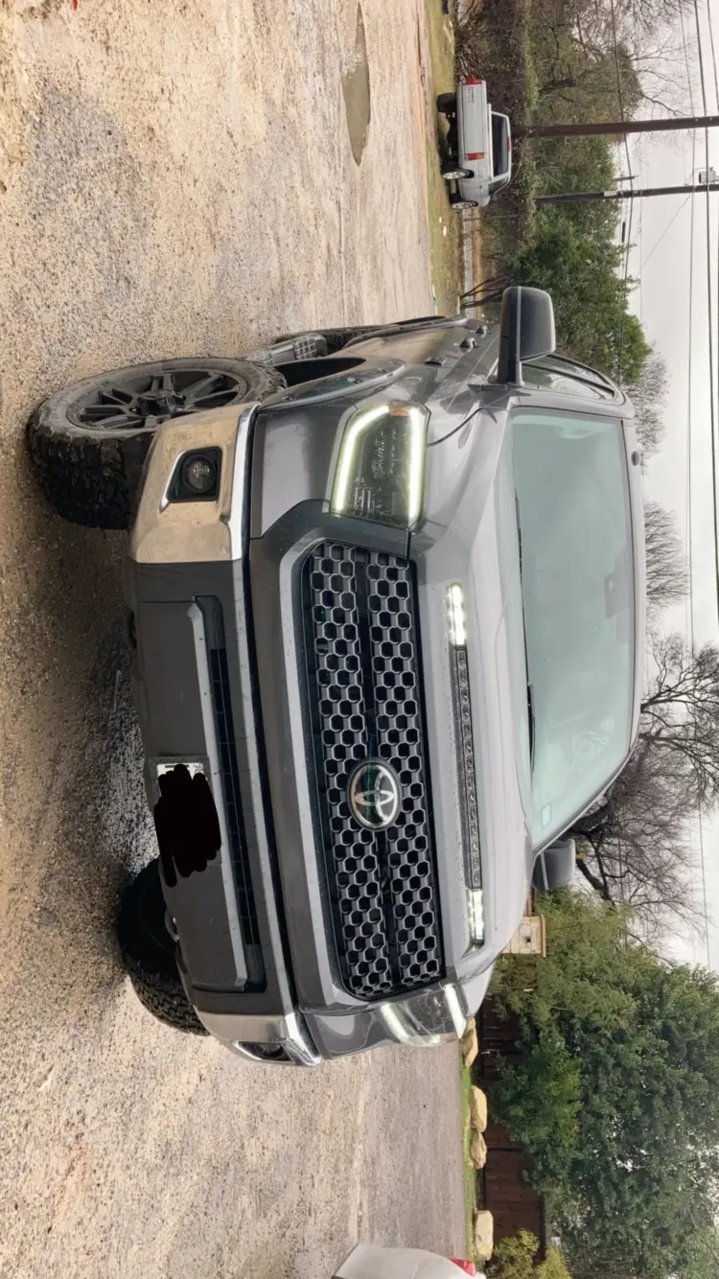

    Hey everyone update ! I’ve completed it and the light bar works perfect!!
    One BIG BIG BIG issue though.
    my nighttime red taillights are not working. Although the brake and blinker light still work.
    my front headlight side marker lights are not working. And my left blinker shows it’s hyperflashing on my dash but it’s not even working.
    Can I get any help please ? Thanks ahead of time

    Did you snip the blue wire?

    Yes I did and I shouldn’t have because whenever I put The cut wires together the blinkers work perfectly and don’t hyper flash.
    I will solder the wires back together tomorrow.
    however my rear tail lights and side marker bulbs and license plate lights still don’t work.
    It’s really frustrating buying a 1k light bar and spending four hours of my day to install it perfectly and carefully and this happens.

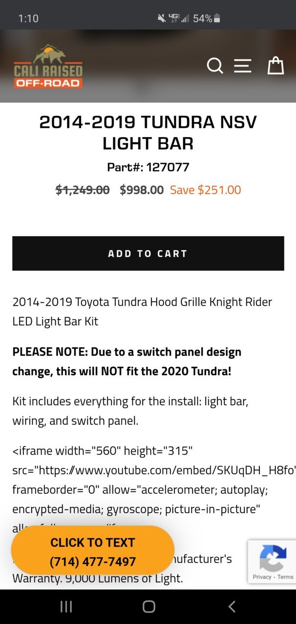

    The 2020 switch panel is different and NSV hasn't made a new one.

    Get the switch panel that @abomb60 sells. As far as the NSV, the only good thing about that bar is the way that it mounts. It's a very low output bar for the price.
