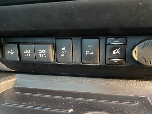

    You should look at your console. I had a space next to the USB ports. I also got the panel from HR but decided I liked the ‘original’ look the single, multi-function button provides as opposed to the 3 red button panel.5A856A2D-3966-44BA-938B-4B8D69C6CA26.jpg 4DCDF1DC-D8A2-4200-99E7-3296AD8FB657.jpg

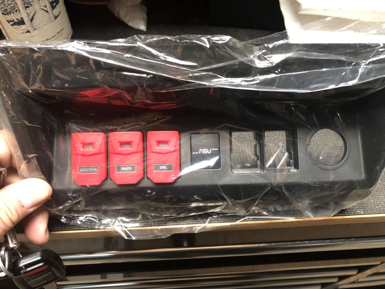

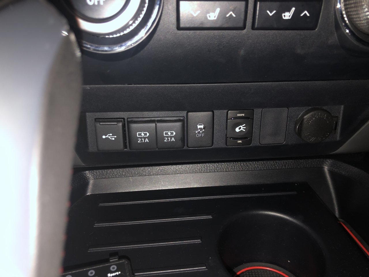

    I popped our the toyota security switch and just left it behind the switch panel, make sure to wrap it so it won't rattle behind the dash. I used that opening for the NSV 3 way switch. It's a tight feed from the steering column to this location, but it does go. 2020 Tundra. Also make sure you carefully follow the wire diagram as you will likely need to repin the main harness and the patch harness. I had a local auto shop do the repin before install.NVS tundra switch panel.jpg nsv tundra switch panel with 3 way.jpg
