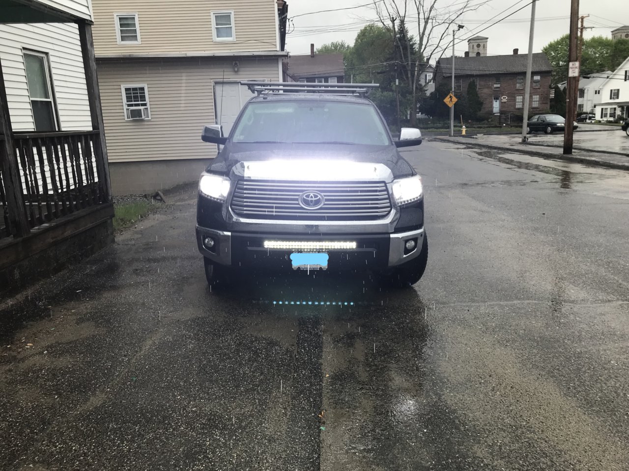

    installed my nsv today. i plugged in the 2 and 9 and then put 8 in 3.
    everything works but the dlr on the light bar and i have the strobe feature.
    nice light took about an hour to install. swipe works with the alarm.
    watch the updated video.
    i will upload some picture when the sun goes down

    i changed out the 3 pin for the 8 pin when pinning the wires last time.
    I lost the drl but was able to have the strobe function
    I would rather have the strobe then the running lights.
    The light bar only comes on when you have high beams on the way it hooks into the factory harness.

    The drl on your head lights are not effected. The light bar needs to be on at the light bar switch with the high beams on for the light bar to work. The harness for the light bar plugs into the connector for the light switch in the steering column. If the switch to the light bar is off high beams work normal.
  20. Jul 20, 2021 at 4:06 PM
    mike508
    mike508 [OP] New Member
    Apr 27, 2019
    #29719
    34
    michael
    2021 TRD Pro
    I didn’t have auto high beams on my 2019. I did notice if the head light switch was on auto the light bar will not work. Hope that helps
