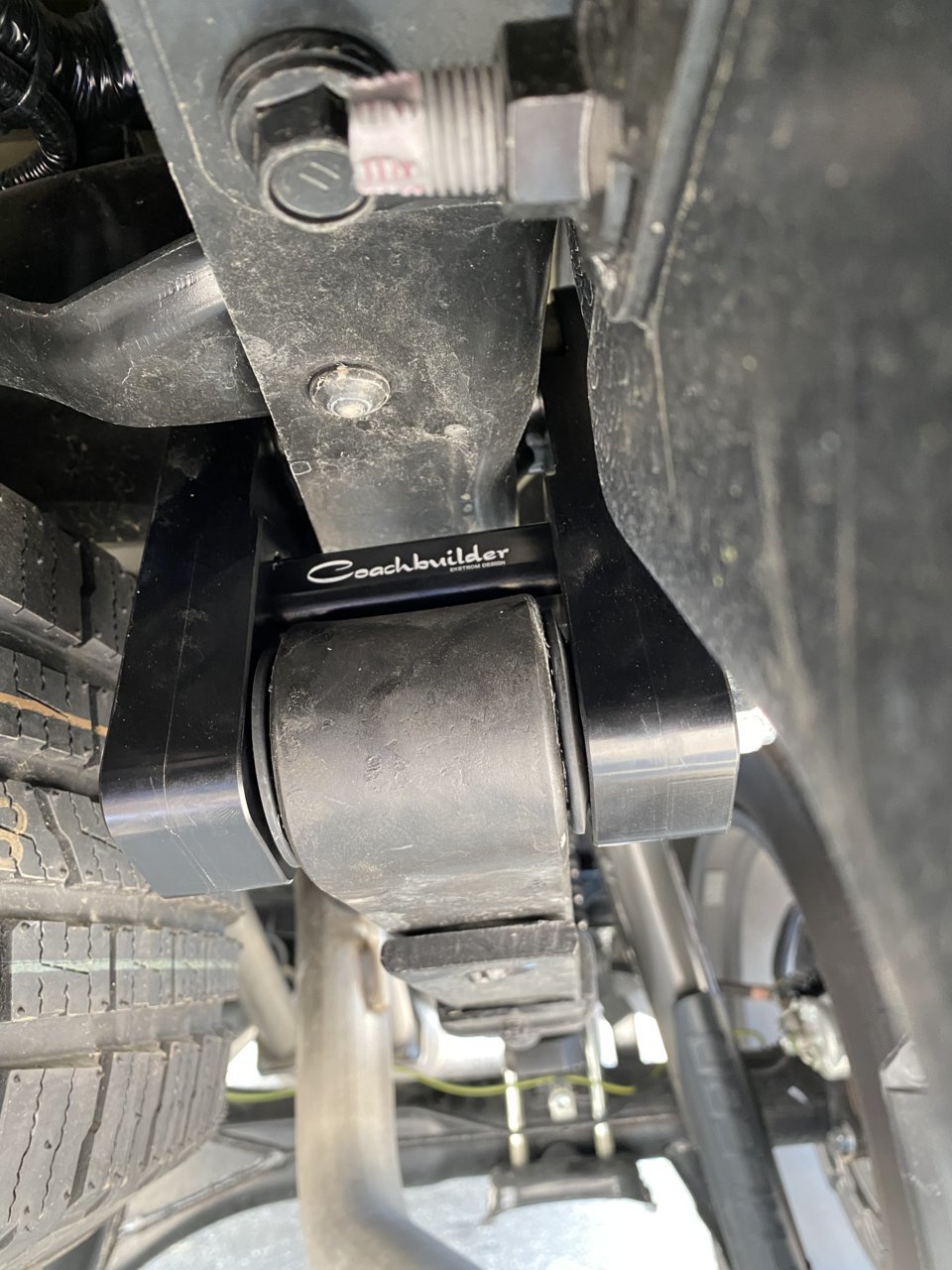

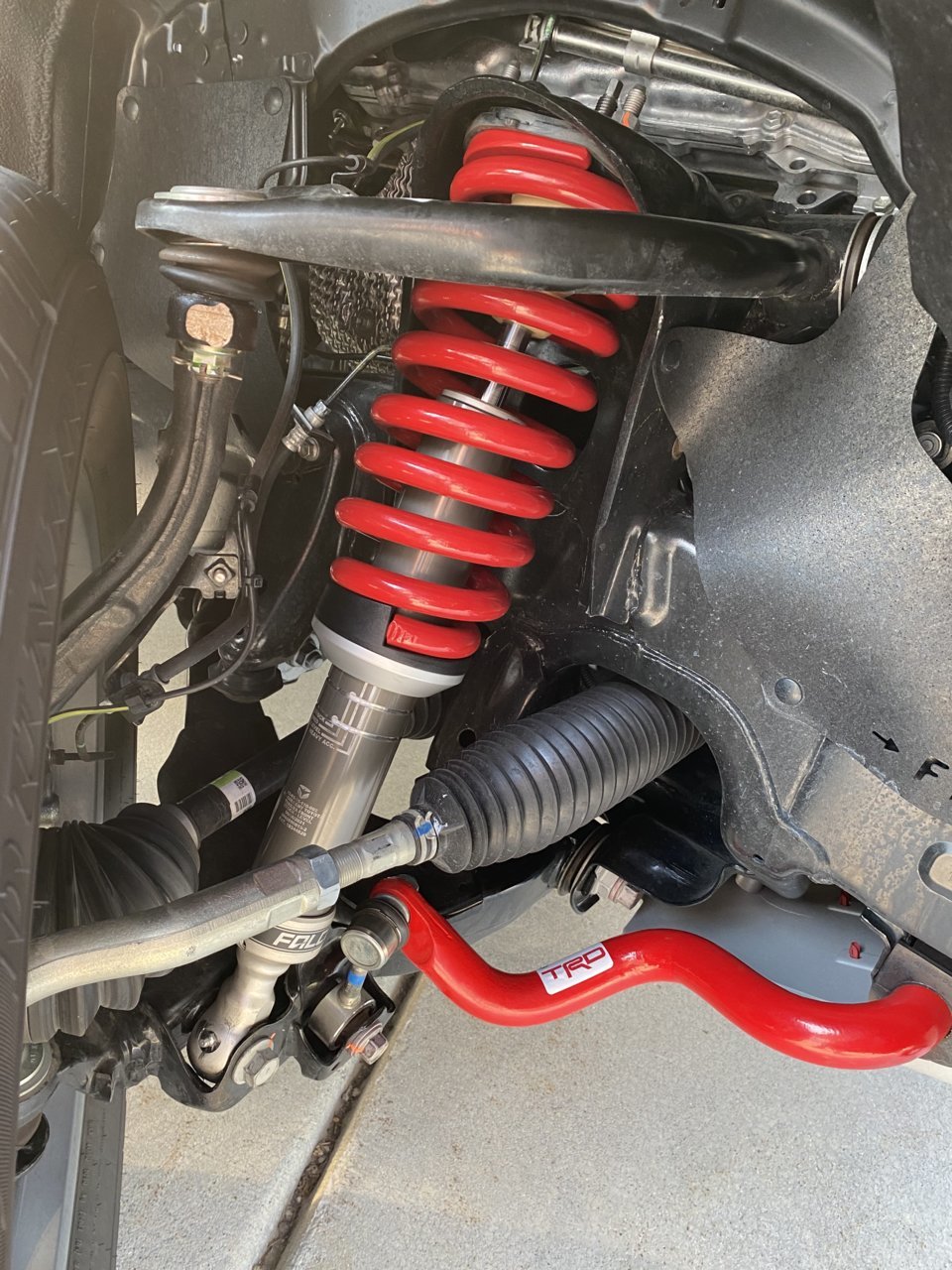

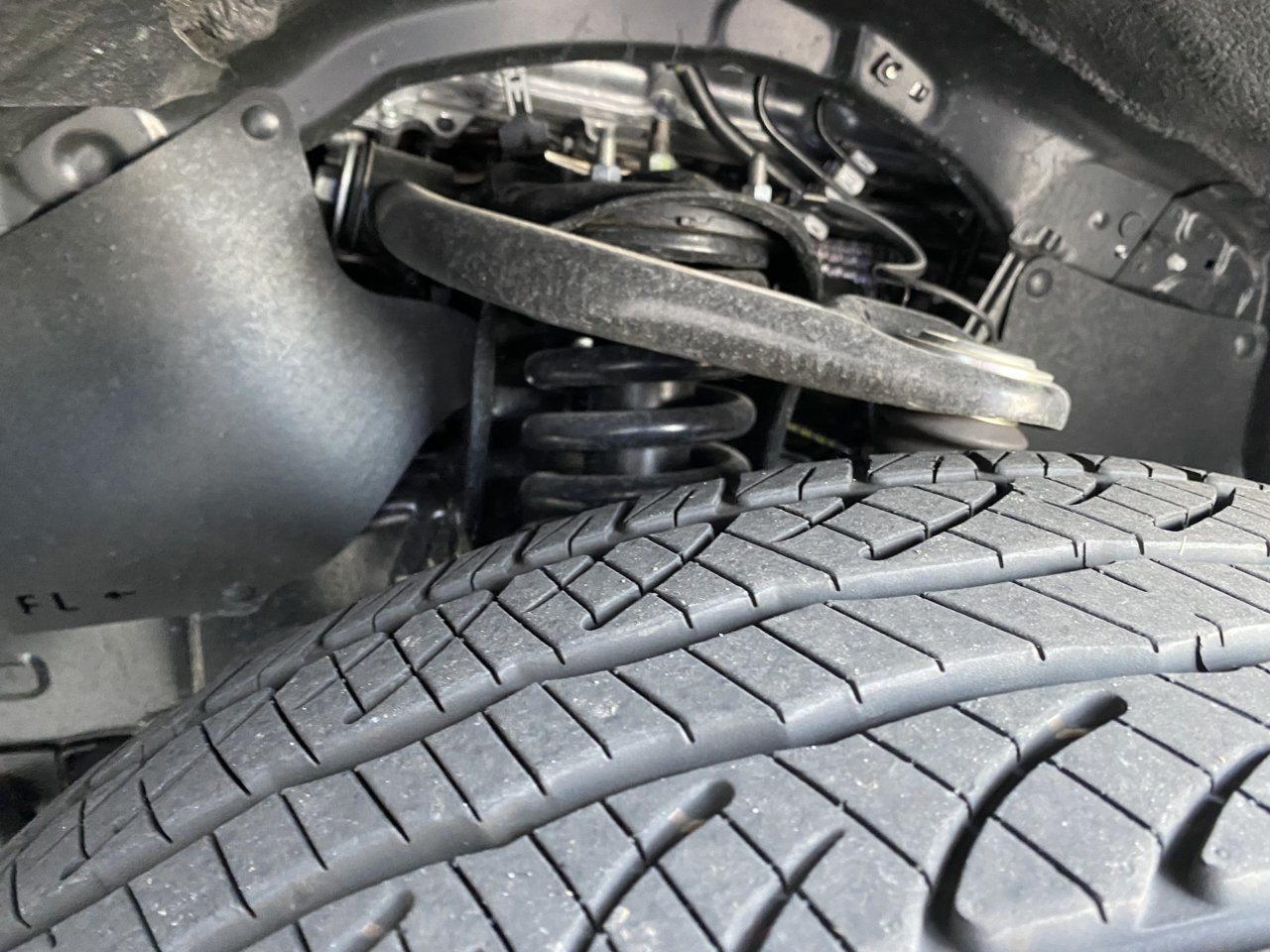

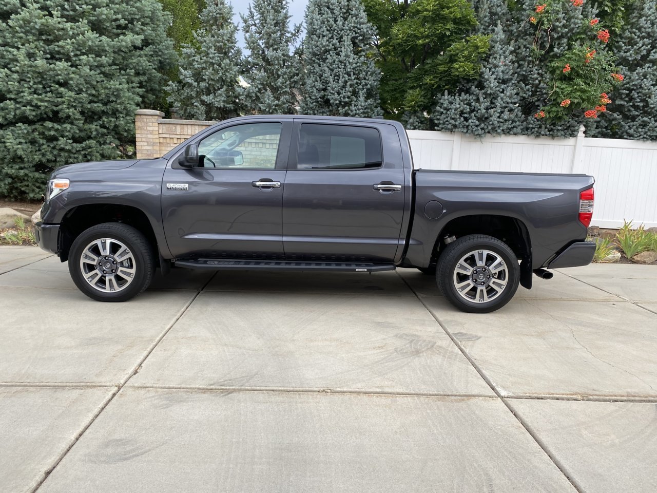

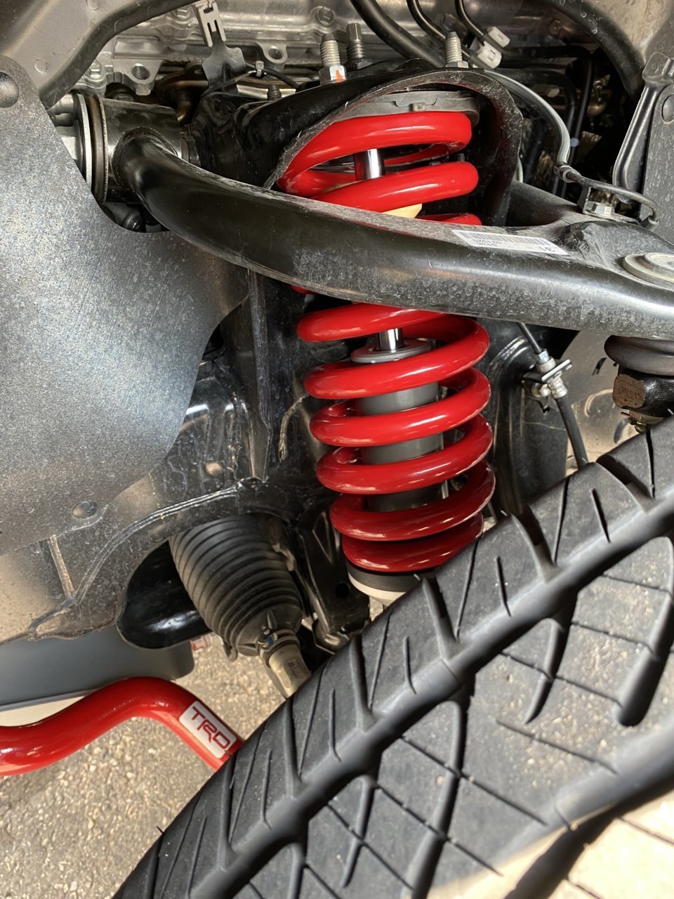

    Today was installation day. The Falcons have landed.
    This is before
    And this is after
    And the front sway bar with powder coated tow hooks

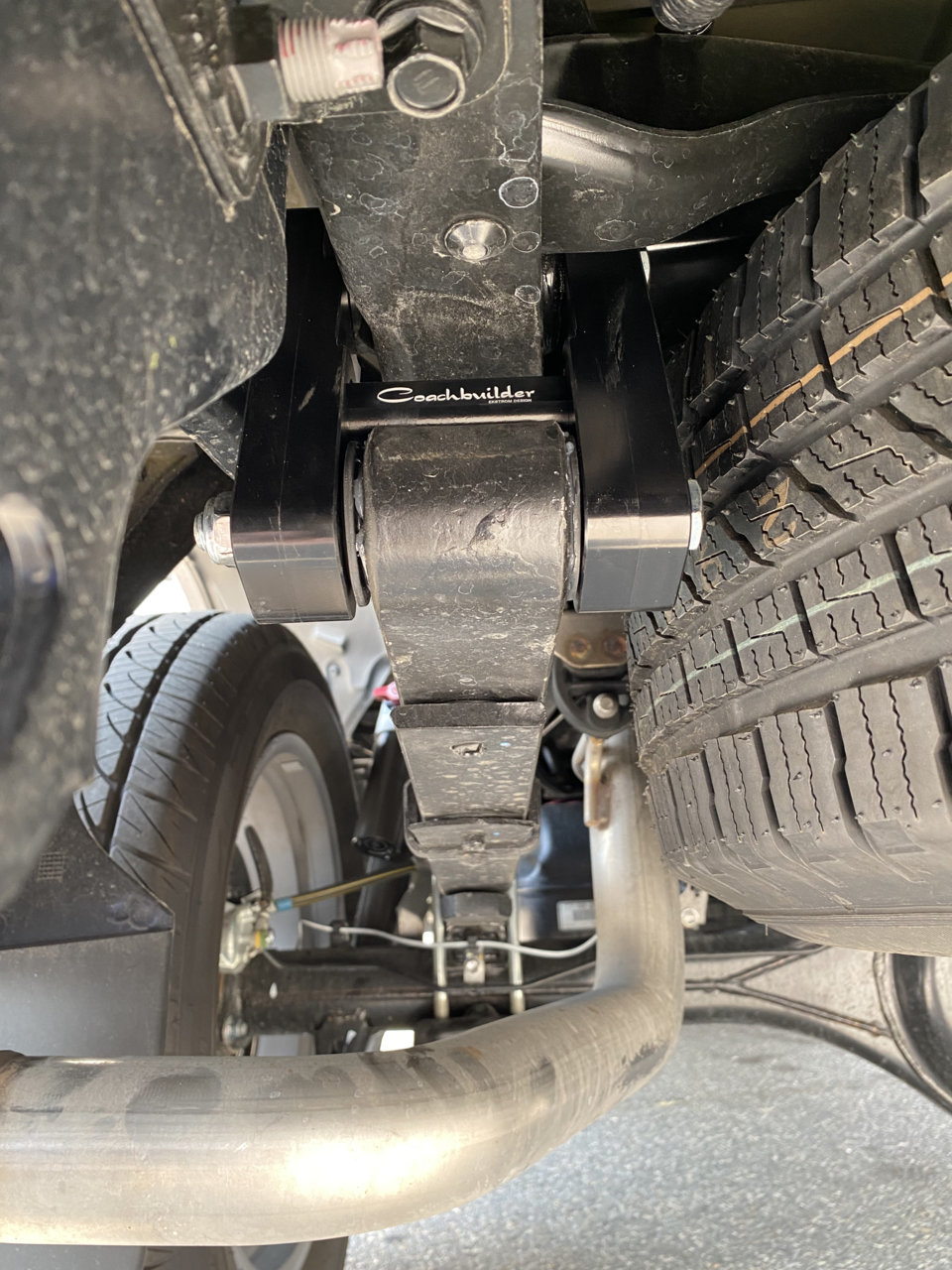

    And the CB+1 shackles

    Nice! Alignment complete? How do they feel on the road?

    Alignment done.
    Drove about 45 miles and they feel fantastic. Soaks up the bumps. Firmly planted on ground. And no bed bounce - shackles are wonderful. Install by Fat Bob’s.

    I went level.
    Before front 21 3/4 rear 23 3/4
    After front 24 1/8 rear 24 1/8
    I expect the fronts to settle a little (perhaps 5/8”)
