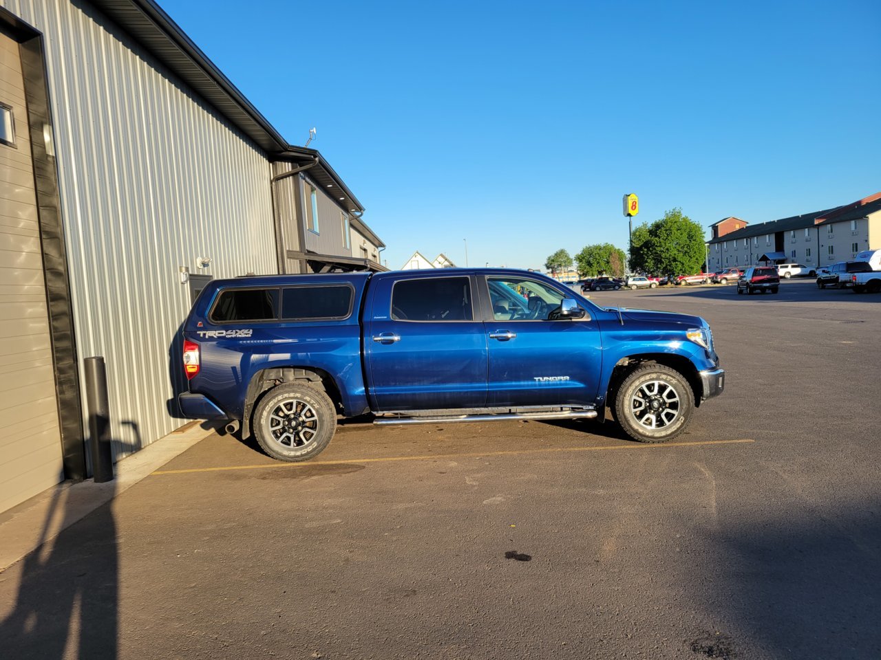

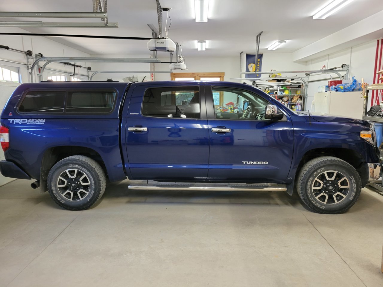

  6. Jun 29, 2021 at 5:59 PM
    #486
    HulkSmurf14
    Aug 9, 2019
    #34377
    2,679
    2014 Tundra Limited
    Tastefully enhanced...
    Here she was before the abbreviated install...poor lighting for comparison
  7. Jun 30, 2021 at 6:13 AM
    #487
    HulkSmurf14
    Aug 9, 2019
    #34377
    2,679
    2014 Tundra Limited
    I went from 22.3125" up front to 23.25" on both sides...for being only about 1" of lift...it feels bigger up front...man, she drives really well now; I'm looking forward to throwing it around the hills this weekend!

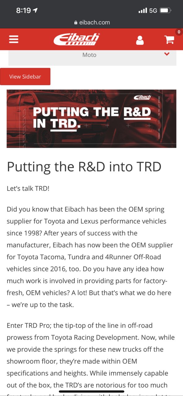

  8. Jun 30, 2021 at 11:40 AM
    #488
    SR5BRAH
    SR5BRAH New Member
    Apr 4, 2021
    #61371
    9
    Mo
    2020 Cement TUNDRA TRD OFF-ROAD PLUS
    JBA OFF-ROAD UCA, 3/1.5" 6112/5160, 33" TOYO C/T, KATZKIN'S LEATHER w/seat heaters, 4 JL C3'S, 2 JL 10W1V3-4, KAPPA FIVE amp, Tacotunes add an amp harness, LED's through out, OEM tow mirrors, BSM indicator relocated,
    This is where I read the 2016+ Toyota OFF-ROAD models have Eibach springs:
    https://eibach.com/us/n-95-trdpro.html
    I got them installed and added 0.5” top shim on both sides and running them at the heavy accessory setting. I’m measuring 25” hub center to wheel well. No lean unless you want to count 1/4” with 3/4 full tank on the 38gal. TRD off-road springs 4x4. Came out to exactly the same height as my 6112’s with the shims.
    Ride is more sporty than the 6112/5160 combo but takes the little bumps in the road better. I have driven 20 miles since install and will continue to evaluate. BD620F55-4B66-46DE-88FC-3ABC1A8C2205.jpg 11EF8C7C-9D2D-4775-84EC-0D96DB234108.jpg 8F07442B-90A2-44F8-936A-7EDE1FEE7A61.jpg 9EADF36D-C045-41BC-8202-AC69B2EE7CD8.jpg 2E260D15-F5A6-4762-806F-59375BD91A96.jpg 54B9DBA8-8C07-4E91-A928-CD72C7916D07.jpg
  9. Jun 30, 2021 at 12:27 PM

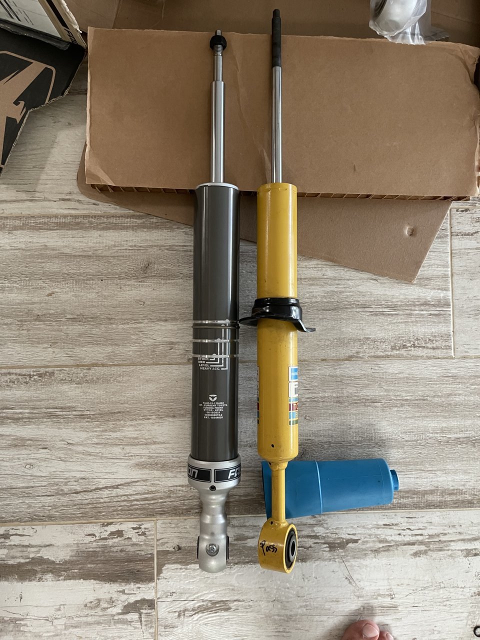

    What is everyone doing with their take-offs? My Bilstiens only have 1000 miles, they must be worth something.....right?
