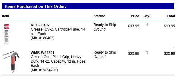

    ^^^just ordered from Summit with a red grease gun.:)

    No problem. I already have a Greasegun for the boat with Marine grease and the Red will make sure I don't use the wrong one on the shocks.
