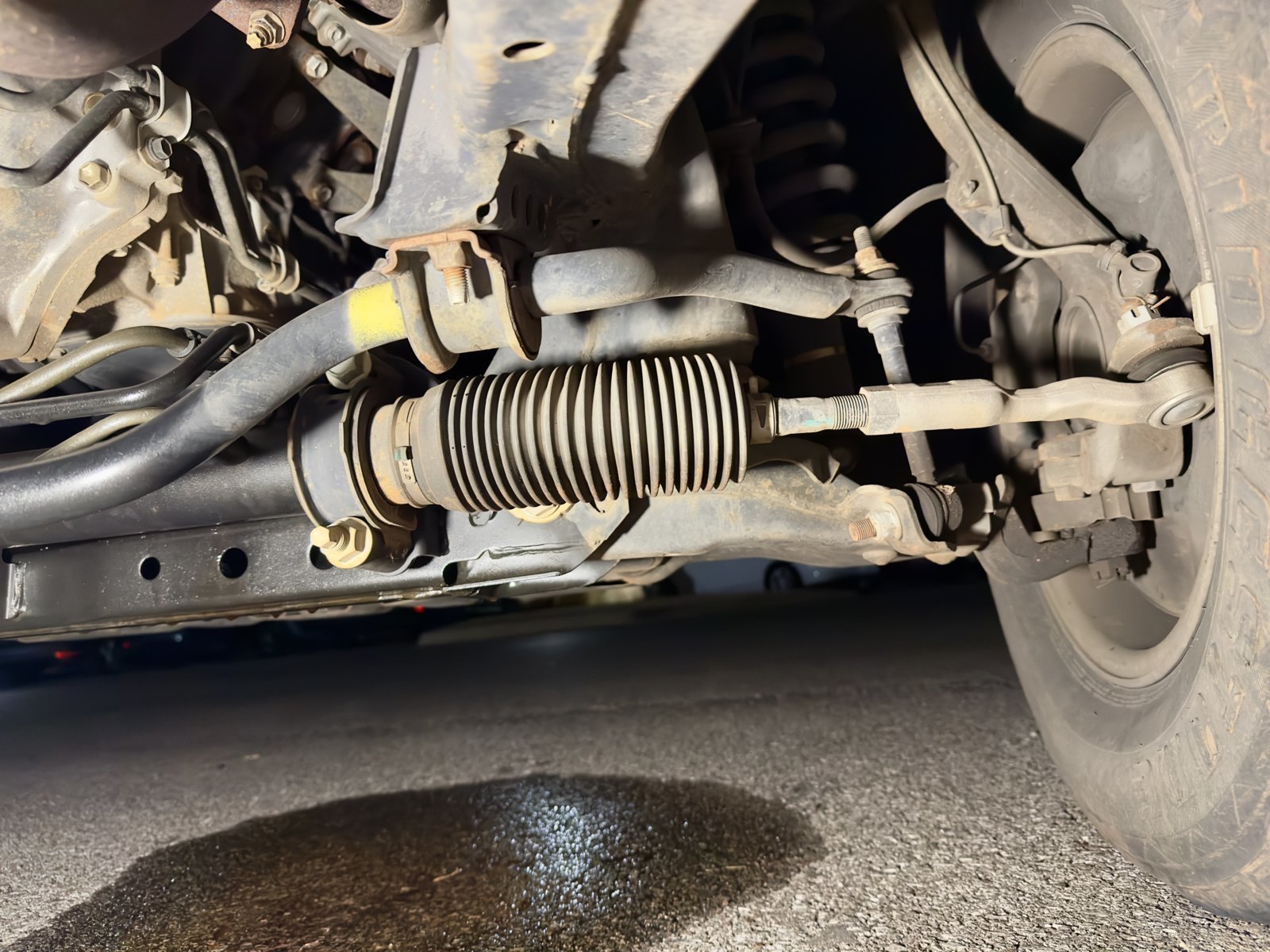

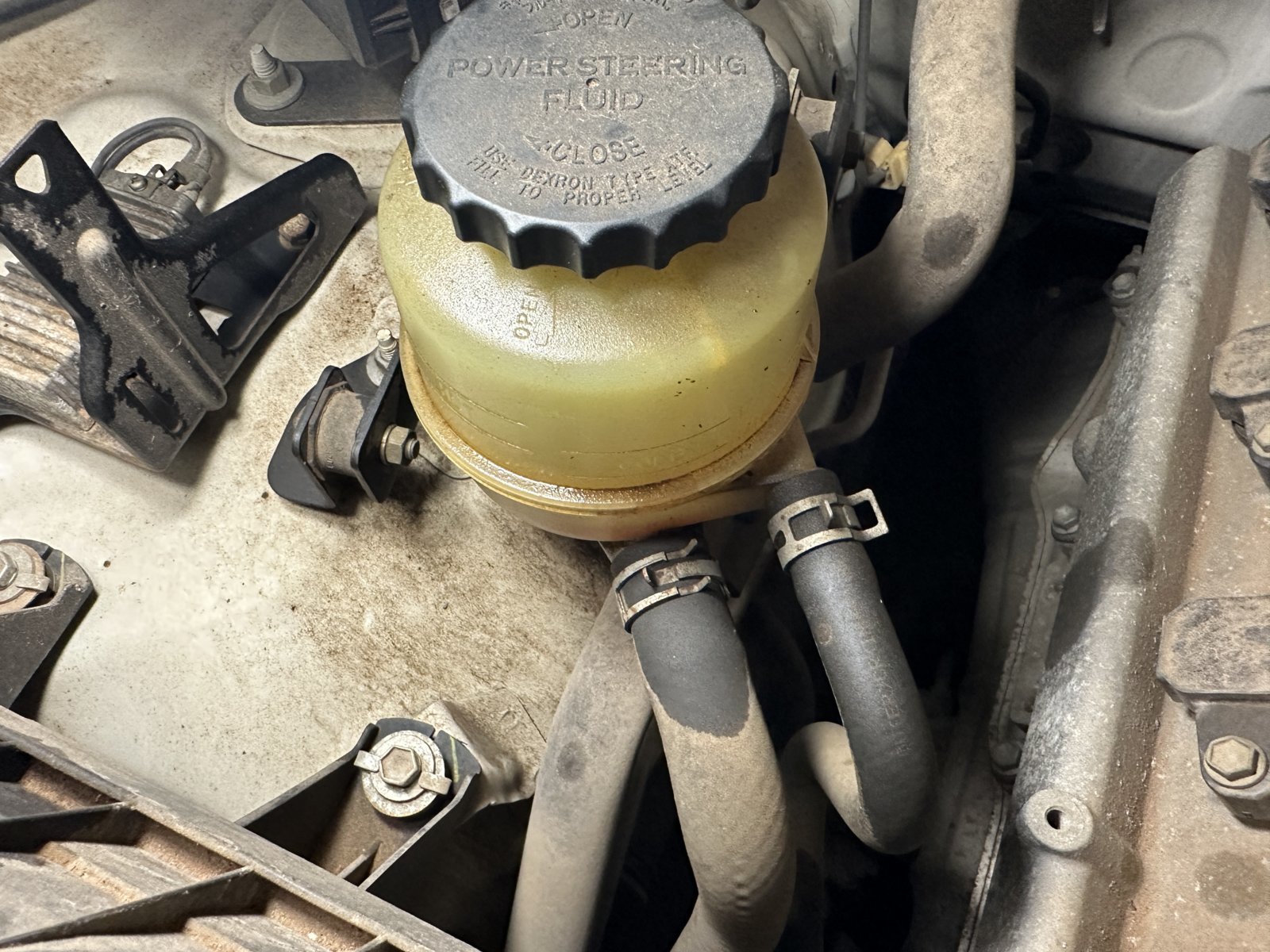

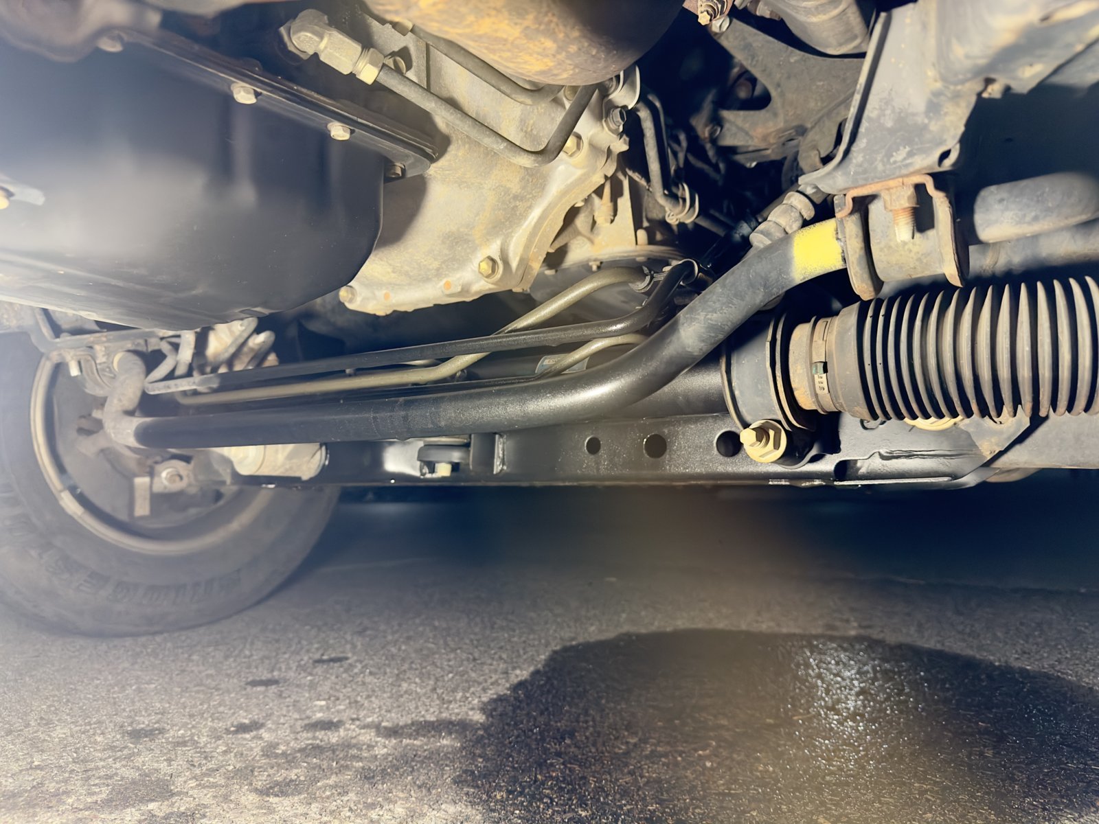

    Thank you for the help! Here are a few pics from tonight! It is a 2006 with 76,000 original miles on it!

    Wipe it all clean with rags, fill it up, start it up, then crawl your butt underneath with a flashlight to see where it's leaking. It looks like its leaking fast enough to easily see

    That said, I see you have the typical valve cover leaks that comes with low miles 1st gens. You may want to read over this thread, since other things look solid on the truck. https://www.tundras.com/threads/so-you-wanna-buy-just-bought-a-1st-gen-tundra-eh.115928/
    What he said ^^
    Fill the reservoir 1/4" above the top fill line with ATF (it doesn't take power steering fluid), and start the truck so the pump is pumping. You may not even need cardboard. Look at all the metal and rubber hoses to check for drips.
    If it's not blatantly visible, there's a safe place to jack up from the center of the truck to lift both wheels, do that, and with the engine running, have a 2nd person turn the wheels lock-to-lock to force fluid through the system. You should be able to spot the leak. When you spot the leak, curious to see that info.
    There's not a lot to this system on most cars .... you've basically got a fluid reservoir, and if that reservoir isn't an all-in-one unit integrated with the pump, it'll have rubber hoses connecting it to the pump itself like on our trucks. Then you have hard lines connecting the pump to the rack. The rack is supposed to be sealed It's going to be leaking from one of very few places:
    • Where the rubber lines go into the reservoir
    • Where the hard lines exit the pump
    • Somewhere at the rackbody: One of the hard lines coming from the pump, OR a freeze plug on the pump, or from the boot/bellows (accordion looking thing)
    • One of the hard lines itself is leaking
    Visualize the above system in your brain. Now get under the truck and figure it out. When you find the leak source, give us a picture. We can help.

    To me it looks like your power steering rack and your lines are leaking. As others have said, you can always clean everything up, run it for a bit and then take a peak under the truck to confirm.

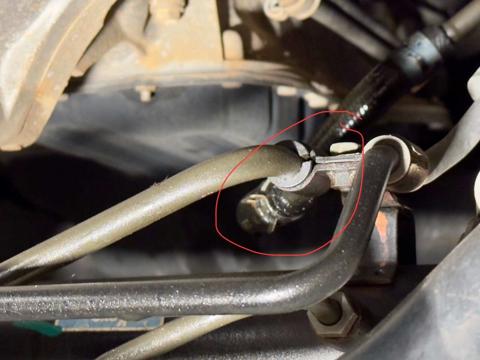

    I’m not sure just looking at those pictures that your rack housing is leaking. The bellows visible in the pics appear dry. This line is definitely wet. If it leaks as soon as you fill it up, clean the rack and lines and let them dry, then fill the reservoir and see where the fluid comes out.

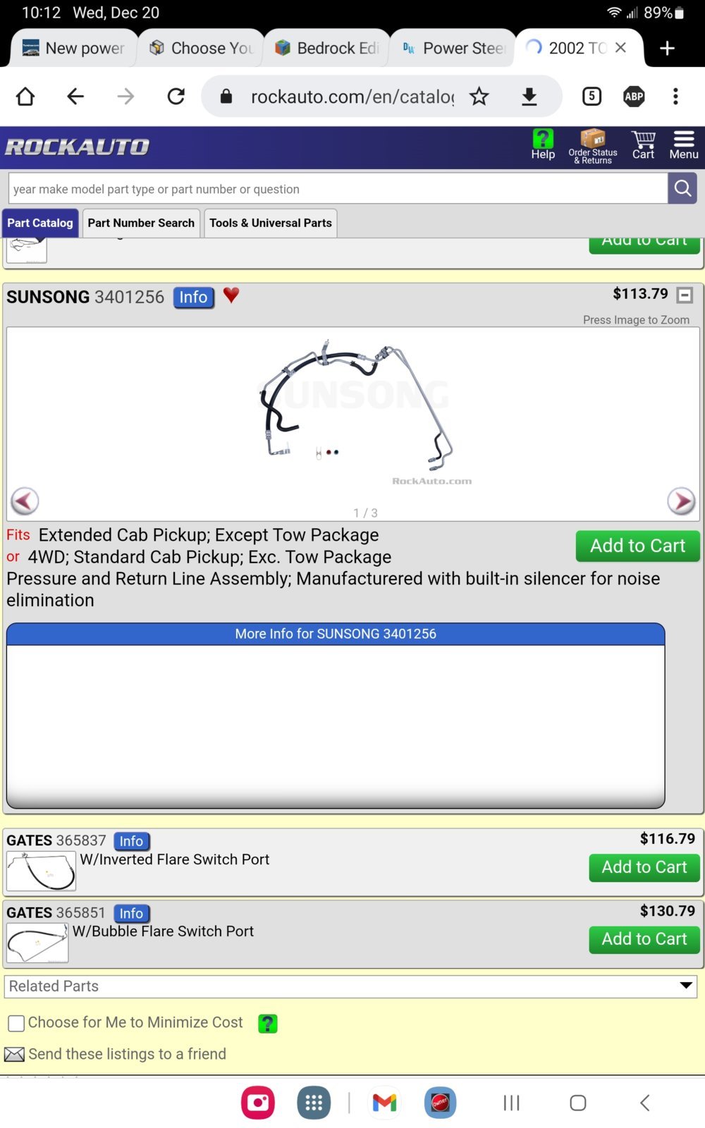

    There've been a shitload of threads around here about aftermarket lines completely fucking up racks and not being threaded properly. Like, a stupid amount.
    The only aftermarket lines anyone around here has gotten to work - at least that I've seen - are from Sunsong. Hopefully whatever the bullshit is O'reilly sold you (fuck I hate that goddamn store) didn't fuck up your rack. It's happened to others. I hate to be that guy who says, "don't buy aftermarket parts", but this is one of those times where - just like with catalytic converters on these trucks - it pays to research BEFORE you buy if you plan to get something other than OEM.

    Another vote for the Sunsong lines. I'm in the middle of installing them in my truck. I compared them to the old ones and they are awfully similar. Only difference I noticed was the Sunsong included 1 less clamp for attaching to the frame than the OEM. Hoping to finish getting it in tomorrow
