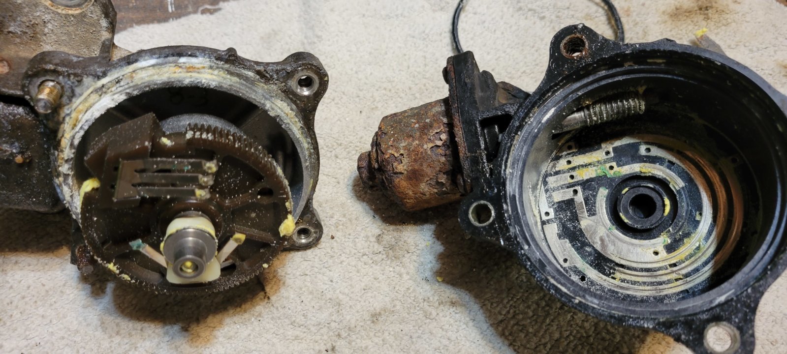

    Ever come to a conclusion on this issue? I am having similar problem where transfer case actuator will pull the rod out for 4hi, but not further out for 4lo and is not able to push the rod back in for 2wd. I take the spline gear out of the actuator and it can perform all functions when not under load. All kinds of different combinations of 4hi/4lo flashing lights, doesn't seem to be any rhyme of reason to them.

    Did you check for corrosion on actuator contacts?

    Both actuators are brand new, ADD actuator is a Dorman. T case actuator is OEM. Bought the truck to sell, I knew the Tcase actuator was bad when I bought it.

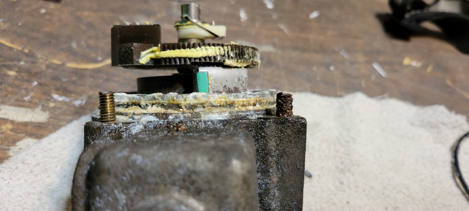

    I did the cleaning of both actuators about a year ago because I could not engage 4Lo. I pulled the gear on the TC actuator as well to remove it. I also had issues with the proper "clocking" and upon reassembly couldn't engage Either 4Hi or 4Lo. After many hours of wash/rinse/repeat I got 4Hi working, but not 4Lo. My A.D.D. also was able to perform all commands disconnected from the TC. One thing I was not able to get an answer to was the 3 positions of the TC shift shaft, until now (red highlight). My idea was to see if I could Manually engage the TC into 4Lo to make sure there wasn't a mechanical reason for failure to engage. My understanding is when both actuators are in 2Hi the only thing that turns with the front wheels are the CV axles, so the front diff and front drive shaft are at rest. There are also 2 switches on the
    TC (Edit: TC actuator) that tell the Truck the position of the shaft 2HI/4Hi/4Lo IIRC.
    As it sits now I have 4Hi, and would rarely if ever need 4Lo, but this bit of info about the shaft positions was something I was looking for. THX bodeslim
