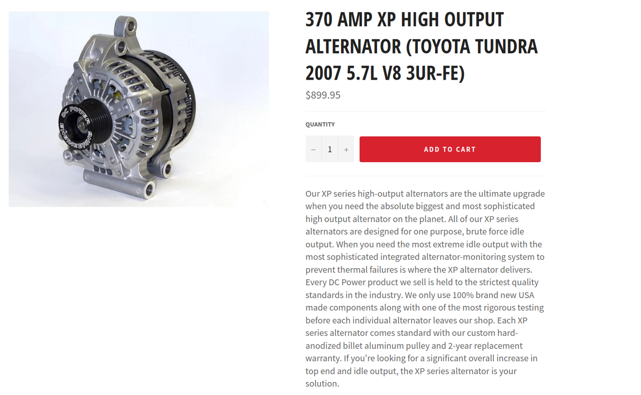

    Hmm, they had a Johnson Controls in Canby Oregon. I actually applied for work there a few years ago. Anyway, I m going the high output route. I ve decided on DC Power Engineering. I ve been unable to find bad reviews on them. They are costly though.

    Well, I hope that you will post your results and opinion on the alternator once you have used it for a bit.

    There are couple members here that went with DC Power Eng alternators. Nice.

    3000~ watt sound system is my reason. Along with a high output alternator, I ll be installing a Northstar SMSAGM220, in the cab also. All that should keep my components happy.

    I had a 270 amp DC alternator installed about a month and a half ago. I was going to try installing it myself, but my landlord frowns on car work in the parking lot. Toyota put that thing in such a retarded place. Anyway, I had a shop do it. So far it s gone without a hitch. No problems what so ever. I still have to get around to testing the output somehow. Can that be done with the thing installed, and if so how?

    I see where what I said may be confusing. I should have said, "DC Power" alternator. It s the aftermarket brand I decided on. Or do you mean what was I running in it before the aftermarket one? It was stock before.

    I had a 240 amp Mechman alternator.

    I had a DC alternator on my super duty and it worked great. Make sure you upgrade the alternator output lead so that the truck can get all of the added juice. The output at lower rpm’s is where it really shines.

    It worked out fine. Big three is a must though. Like @crewmaxlmt stated. The output lead should be upgraded, (I used zero gauge), to take advantage of the increased amps.
