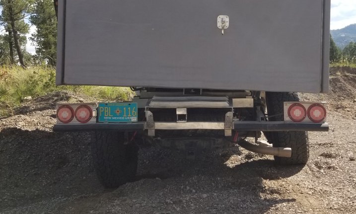

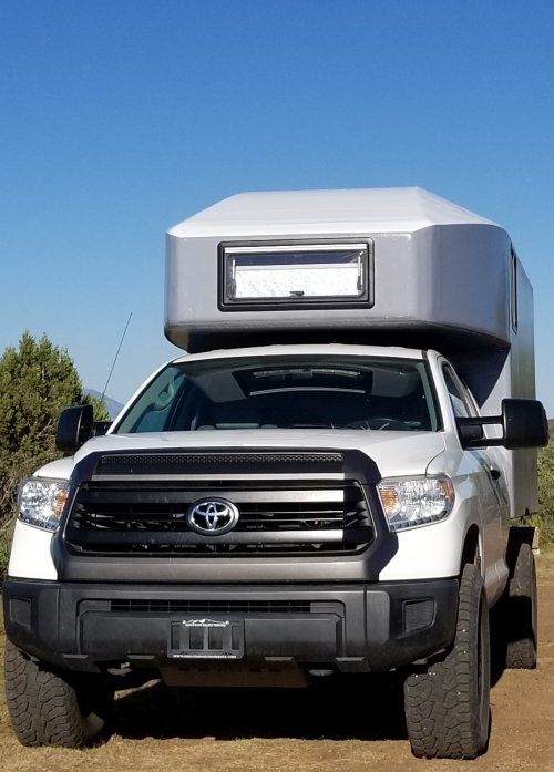

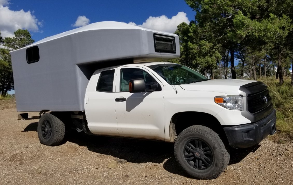

    Commercially available campers weren't janky enough, so I made my own. Not much to show; lots to do yet. But at least I can sleep in it. Photos below are when checking the articulation. There is a pivoting deal so the frame can twist without stressing the camper.
    C.I. and texasrho83[QUOTED] like this.

    Looks lightweight. Very nice!

    When loaded with junk, it won't be light! Ya, figuring the bed I removed weighs ~350 lb and the empty shell of the camper is ~750 lb, and ~100 lb for the mounts and pivot. It's hand laid fiberglass and carbon over 1.5" PVC foam. The interior is partially done, and that's all light and simple too. Need to make lower storage boxes for each side of the camper, and will have water, fuel, and propane tanks underneath as well. Planning to live in it full time, if I don't die first!
