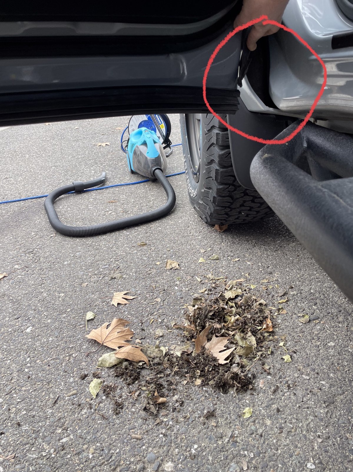

    Since pushing 60 degrees over here I tried to clean out that area at the bottom of the front fender/quarter panel. Wow! Nasty! Was hoping I would pull out a 10mm socket but no luck.

    Thanks for the reminder. I need to do that too

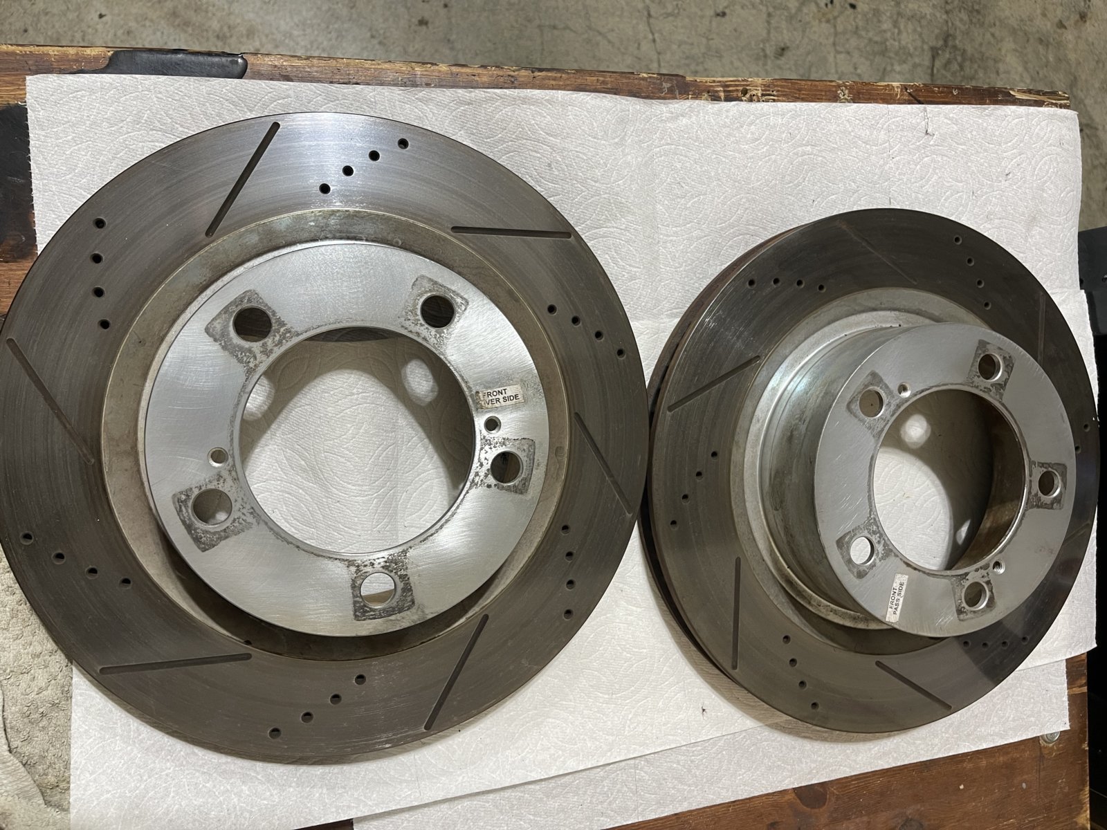

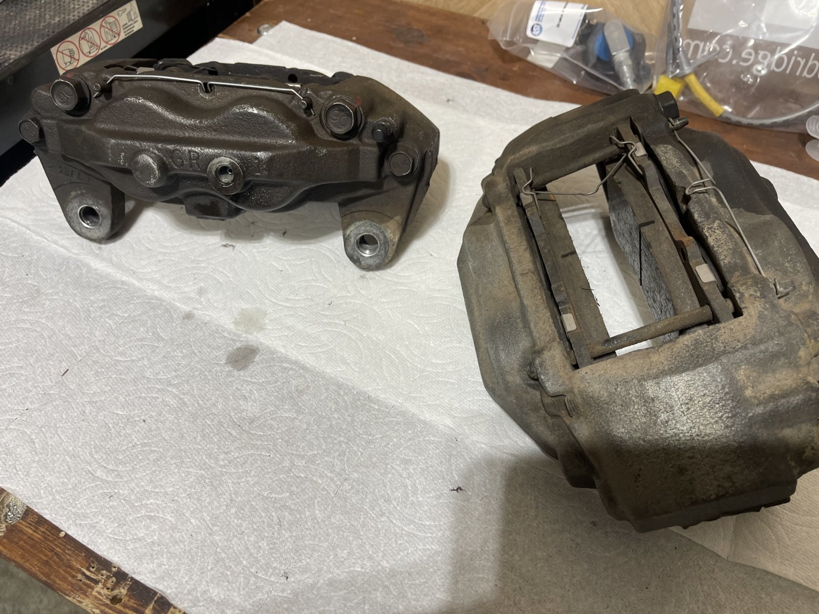

    If anyone needs some front brake rotors, pads and calipers let me know. Front have tons of life on them these are the heavy duty ones from power brake.

    Are those the factory calipers?
    I’m finally getting to where I’m not far out from a brake job… might be nice to get the calipers cleaned up and painted and just swap them out (or have on hand - twice when I did fronts on my 2008, one of the pistons was seized up.

    yessir factory front calipers.

    there’s a reason they’re only $180 lol
