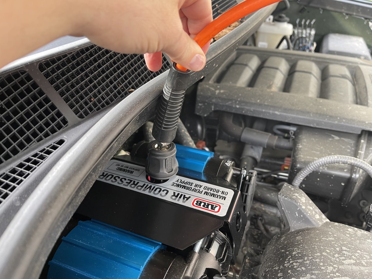

    You can bring it down to me and start saving up for something else. ;)

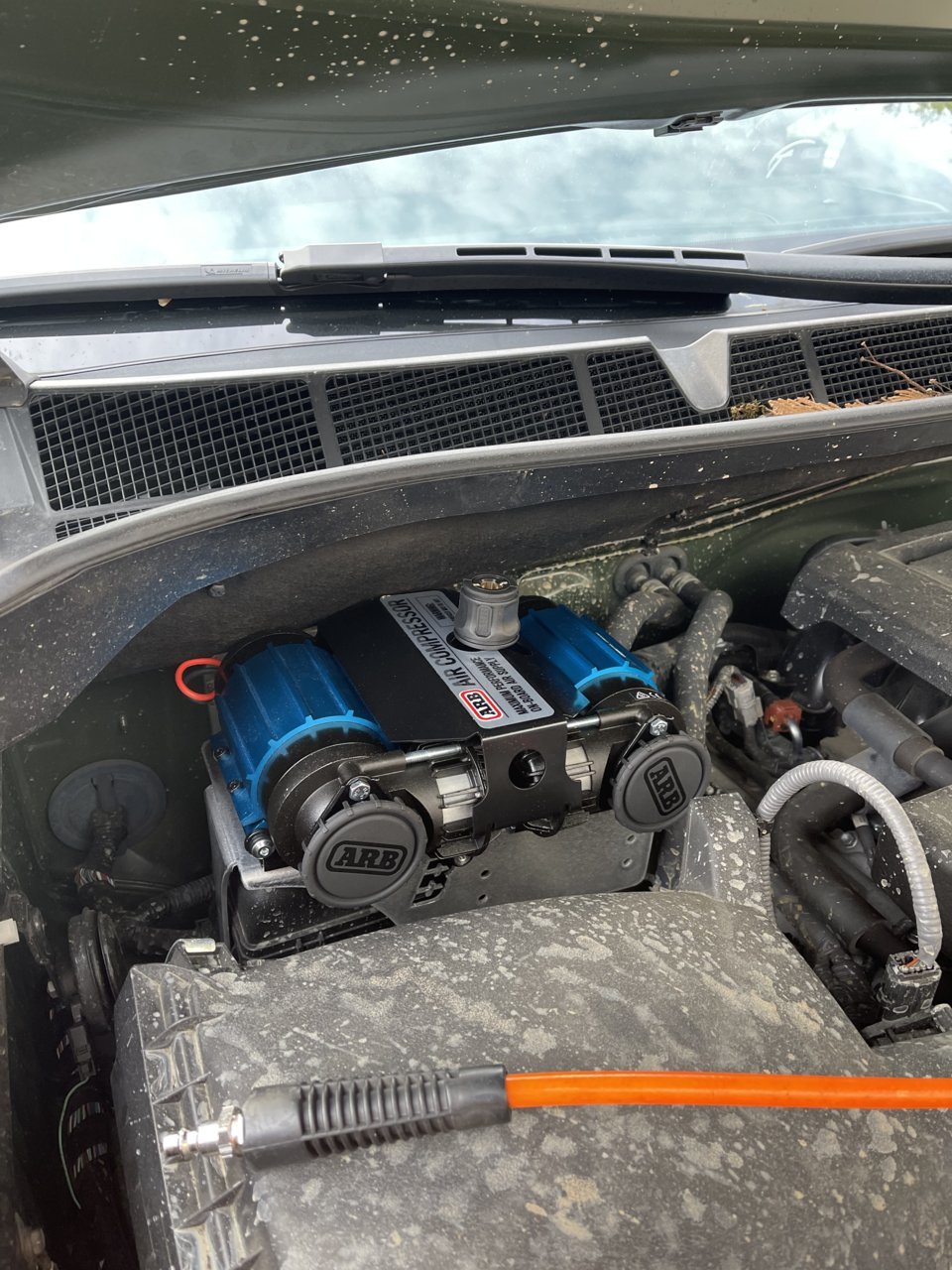

    Should be a standard pipe thread to take that quick connect off and put an elbow on there. A threaded street elbow - probably 1/4” (pipe size).

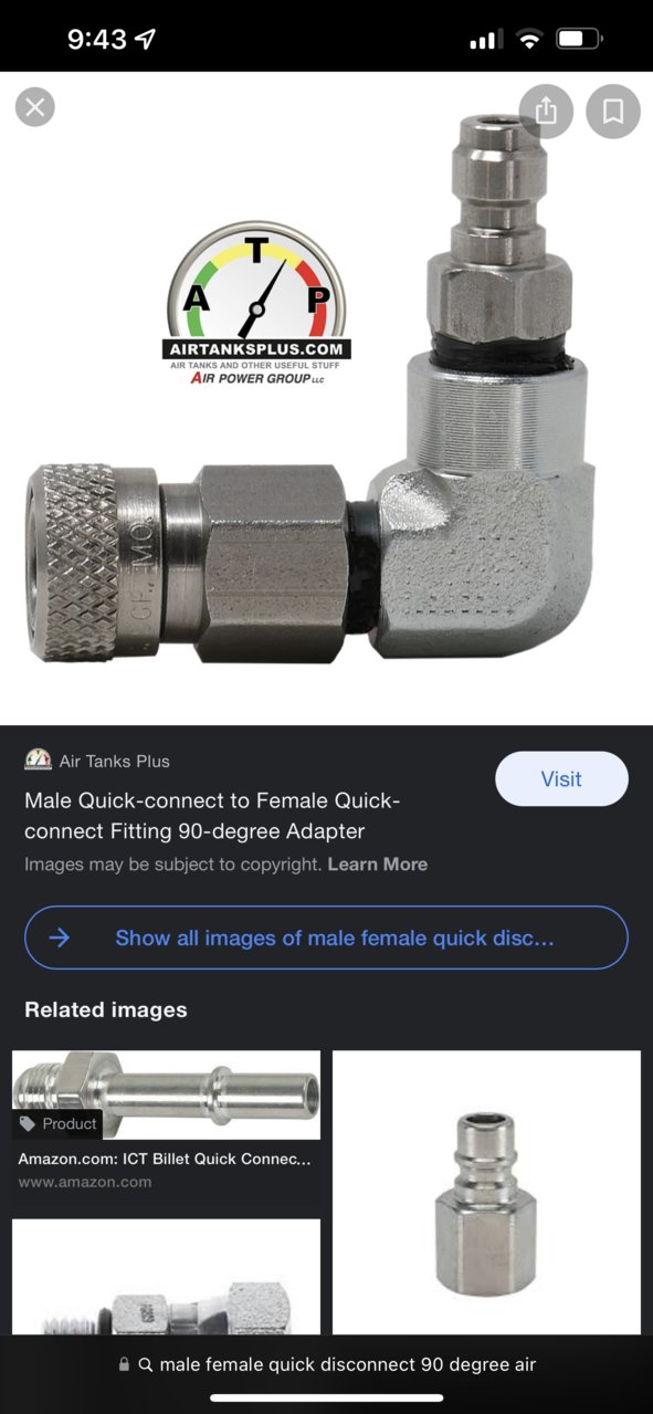

    Yeah, I’m going to take the quick attach to the hardware store and see what I find. Hopefully it isn’t some reason Ausi that

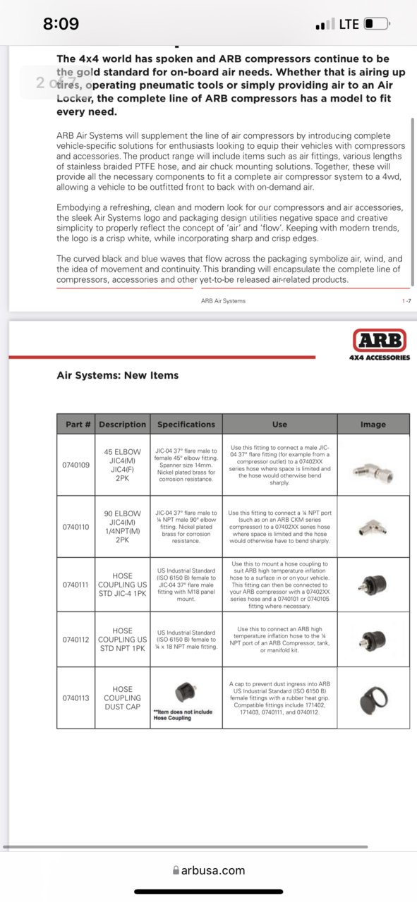

    looking at some of their stuff the end that is screwed in the compressor looks like a JIC 04 37degree flare fitting. Still looking to see how to do it in 1 fitting instead of 90, followed by a another fitting that goes to…oh hang on

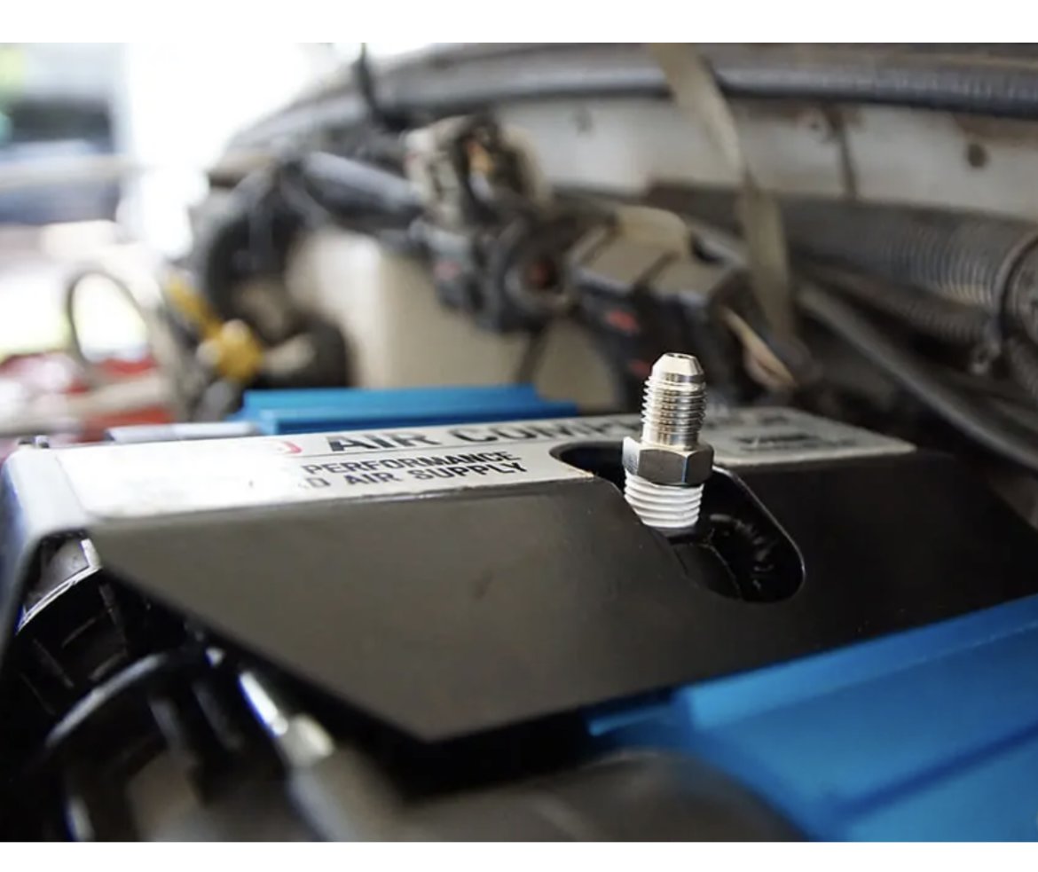

    This picture for the manifold install shows a male pipe thread to flare adapter - pipe thread into the compressor body
    https://arbusa.com/arb-twin-compressor-installation/

    You very well could be right.
    I can’t seem to get/find a manual.
    At least this ARB picture will help clear it up :rofl:
    Obviously one is right for the compressor.

    Lmfao
    Yep - they make two of them. One is the right one. :rofl:

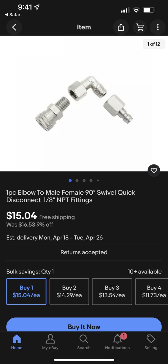

    McMaster Carr has about all the hardware you might need if you order ahead of time.
    Shimming would probably be the cheapest option and it doesn’t look like it would take much. That being said I wonder if something like this fit in the space? It might be the same size when fully assembled.

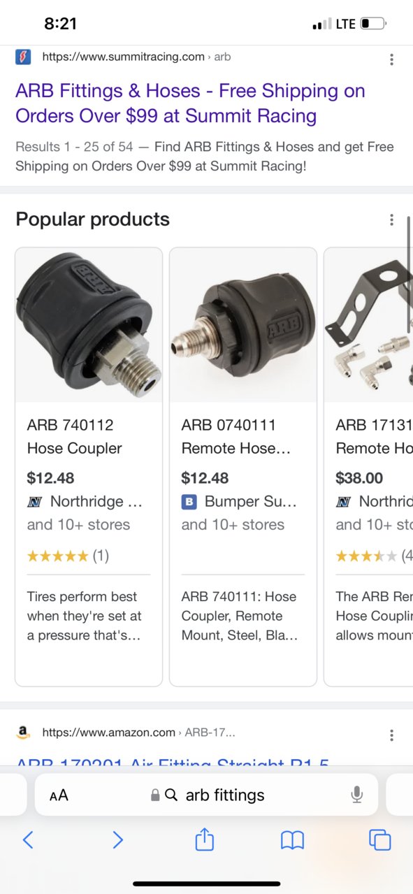

    You guys were on point last night. Thanks for all the suggestions.
    Scanning the ARB website this morning it says “A hose coupling should not be installed directly onto the compressor if it is being used for tire inflation. Instead, use the ARB Manifold or a remote coupling setup.”
    Curious about that. Wonder if the manifold offers some form of buffer/ shock absorber against pressure spikes to the system. I cannot imagine why the system would care otherwise.
    The coupler I have is the 740112. I’m probably just going to puke the $80 for the manifold and go from there. I’ll never add lockers, but it will allow me to run a hose to the back of the truck if I want or even plumb into a set of airbags.

    Yeah - I am looking at either making or buying a small tank when I do add air to the truck. It provides a reservoir so that the compressor pump isn’t running full time - same principal as a stationary air compressor. That’s part of why I’m pushing that one out a while - I want to get my wiring planning all dialed in first.

    Not sure about the ARB, but, my Viair compressor came with an air hose that has silicone sleeves over the ends because the compressor gets flipping hot after a sustained load of airing up 4 tires. Is the ARB the same way with some sort of non heat conductive covering on the coupling so you don't burn yourself disconnecting? The manifold would not transfer the heat obviously because the actual compressor body is what gets really hot.
