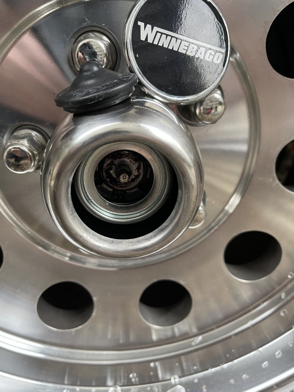

    Both of my TT's have had EZ-lube wheel bearings, have you guys checked? With the wheels still on pop off the bearing hub cap (unusually chrome) then there's a rubber dust cap behind that and then your grease zerk. I usually give them 2-3 pumps. Takes 15 minutes tops.

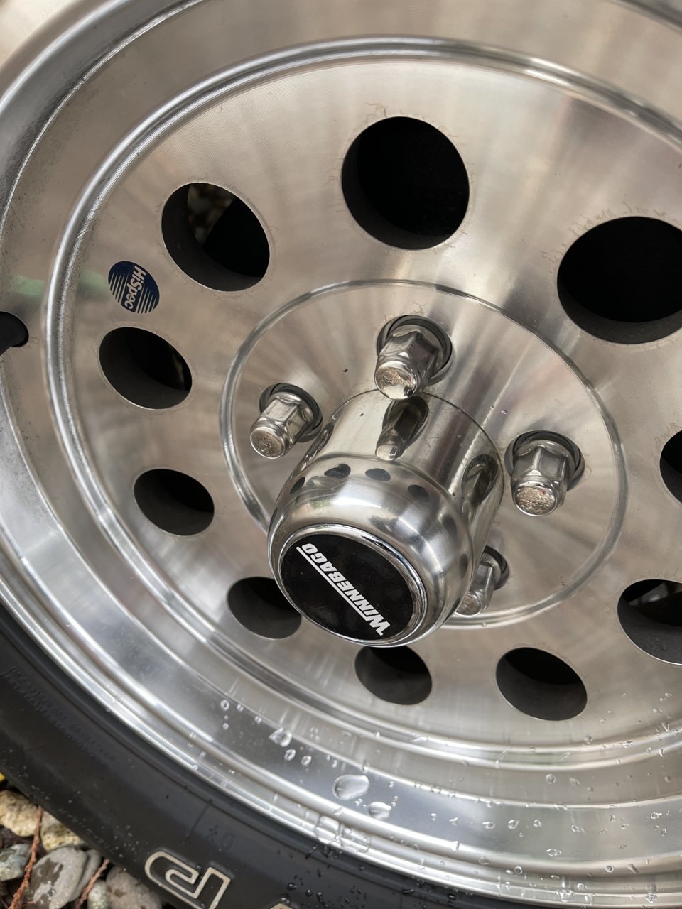

    I cannot get the cover off. Tried tapping it out with a rubber hammer and nada.
    When I do the wash/wax in a few months I’ll pull the wheel of cuz now I’m curious AF.

    Got a pic? I had to use a really thin screwdriver to pry off the plastic chrome cap

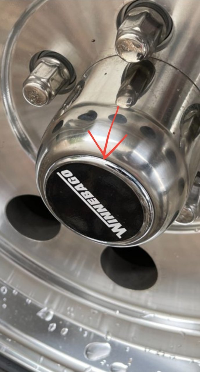

    Yeah, without causing damage of course, try a thin flathead screwdriver under that Winnebago chrome ring. Should pop off

    Or a stout trim tool

    Dont those wheel center caps enter from the back of the wheel? To access the hub shouldn't there be a cap on the hub itself? Which would mean to remove the wheel? Just thinking out loud here lol

    They do, that's why I pulled my wheels off the first time. :D
    But the very center piece pops off for greasing.

    Weeeeelllllll chhhhhiiiiiit!!!!
    You da man! Thanks for the Pro tip!
