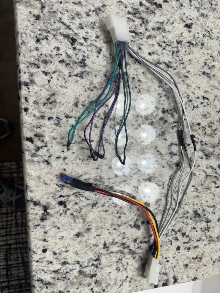

    Glad I saved this thread. Harness finally came in after ups lost my first one.
    All crimped together and ready to plug in tomorrow.
    Appreciate all the info posted, very helpful.

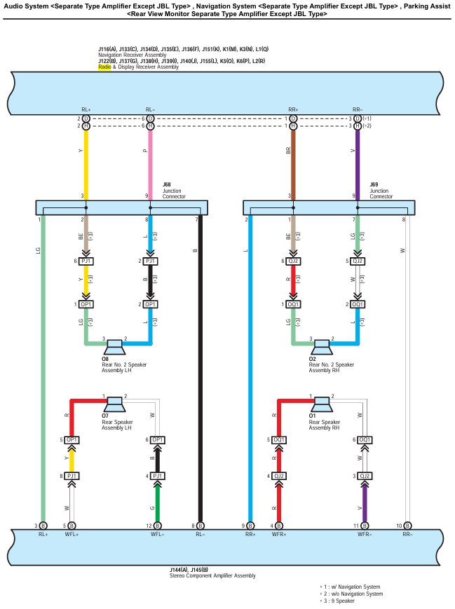

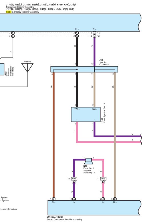

  18. Apr 12, 2025 at 9:24 PM
    #48
    1lowlife
    1lowlife New Member
    May 4, 2016
    #3296
    11,253
    DADA
    THE GREAT STATE OF TEXAS
    2014 MGM DC SR5

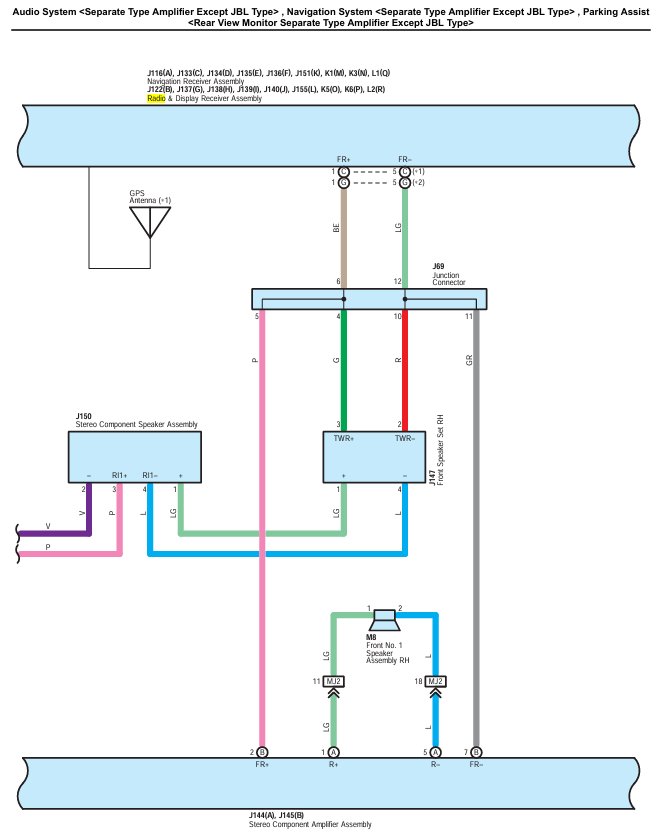

    The dash speakers are powered from the HU.
    The front doors from the underseat amp, when it was there.
    The amp bypass should have both front and rear doors running from the HU.
    You did omit the OEM undereat amp, correct?
    You can use these diagrams to make sure you did the bypass correctly..
    You may have crossed some wires which would have messed up the entire front speaker output, dash and doors.
    The front signal goes out the HU and splits to the dash speakers and the OEM amp then to the front doors.
    Maybe try unplugging the amp bypass and see if the dash speakers are working.
    For the rear the signal goes out the HU and splits to the rear tweeters and then the OEM amp to the rear doors.
    Welcome to the forum.
    20manny1996 likes this.
