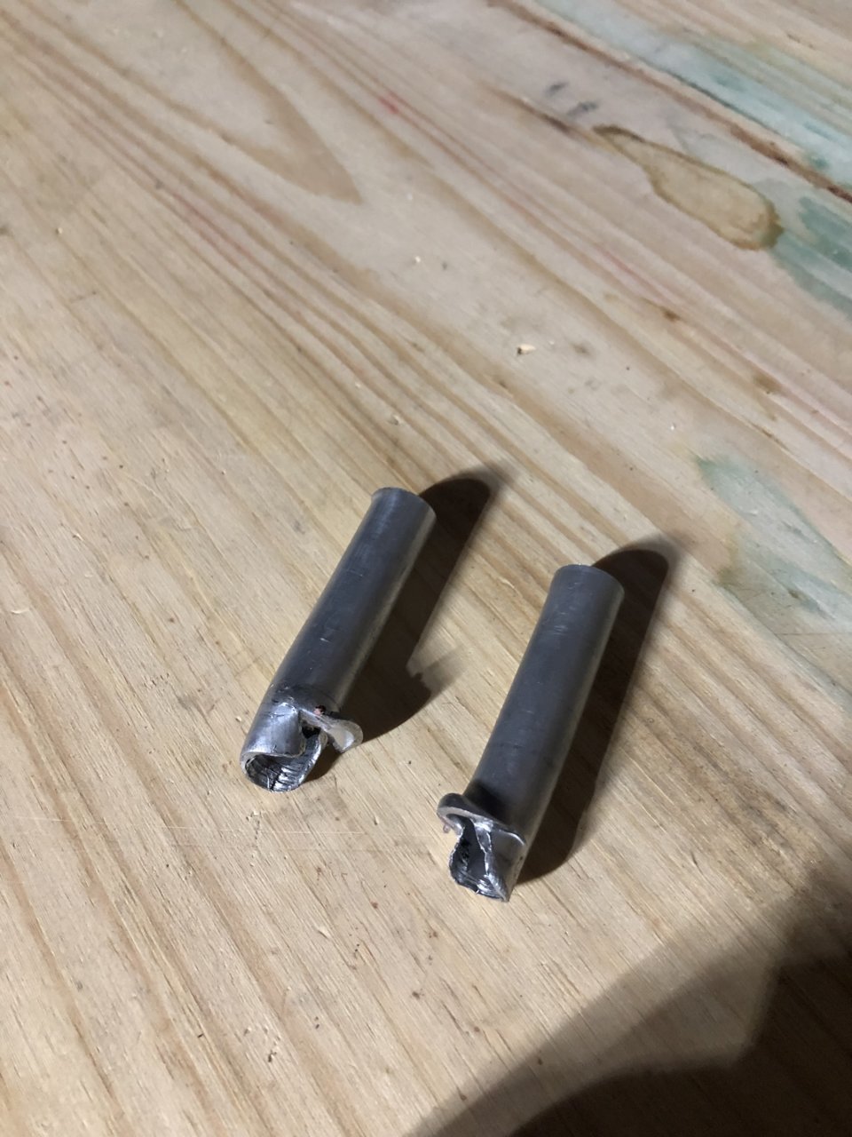

    So an update on the clunk. Took off my stock pro skid and RCI tranny skid and clunk went away. I even had the rubber on it to help. But I believe my culprit is the collar on the bolt that goes on the back of the skids that get crushed and have a wedge washer and nut. But no grease in my u joints in 60 k miles isn’t good either so she goes to the dealership tomorrow just to have the master tech take a look at all the joints since I removed the skids. Damn. Pissed that it’s the skid again. I got new skid hardware just cause I removed the skid so many times and the last time I had the skid on the collars were too damaged and lost them so they weren’t on an no noise. Does everyone still use that collar?93B432E2-C427-473A-AC2A-8E2A5ED67D5B.jpg
  8. Nov 26, 2018 at 5:40 PM
    #38
    164,174
    I forgot all about those TRD skids being the culprit.
  9. Nov 26, 2018 at 6:12 PM
    #39
    Jimes
    Jimes [OP] New Member
    Nov 27, 2014
    #764
    949
    Bay Area, California
    2015 toyota tundra trd pro
    I didn’t forget. Just thought cause I replaced the hardware that it couldn’t be it. But the hardware itself is the problem. Feel like a jackass. I greased damn near everything on the truck I could and torqued all the suspension bolts and drive shaft bolts. Went to town just to remove skids and no noise. Does the RCI engine skid have this issue? Anybody have them and still had to put the rubber spacers?

  10. Nov 26, 2018 at 6:14 PM
    #40
    164,174
    I’m not aware of that issue with RCI skids.
