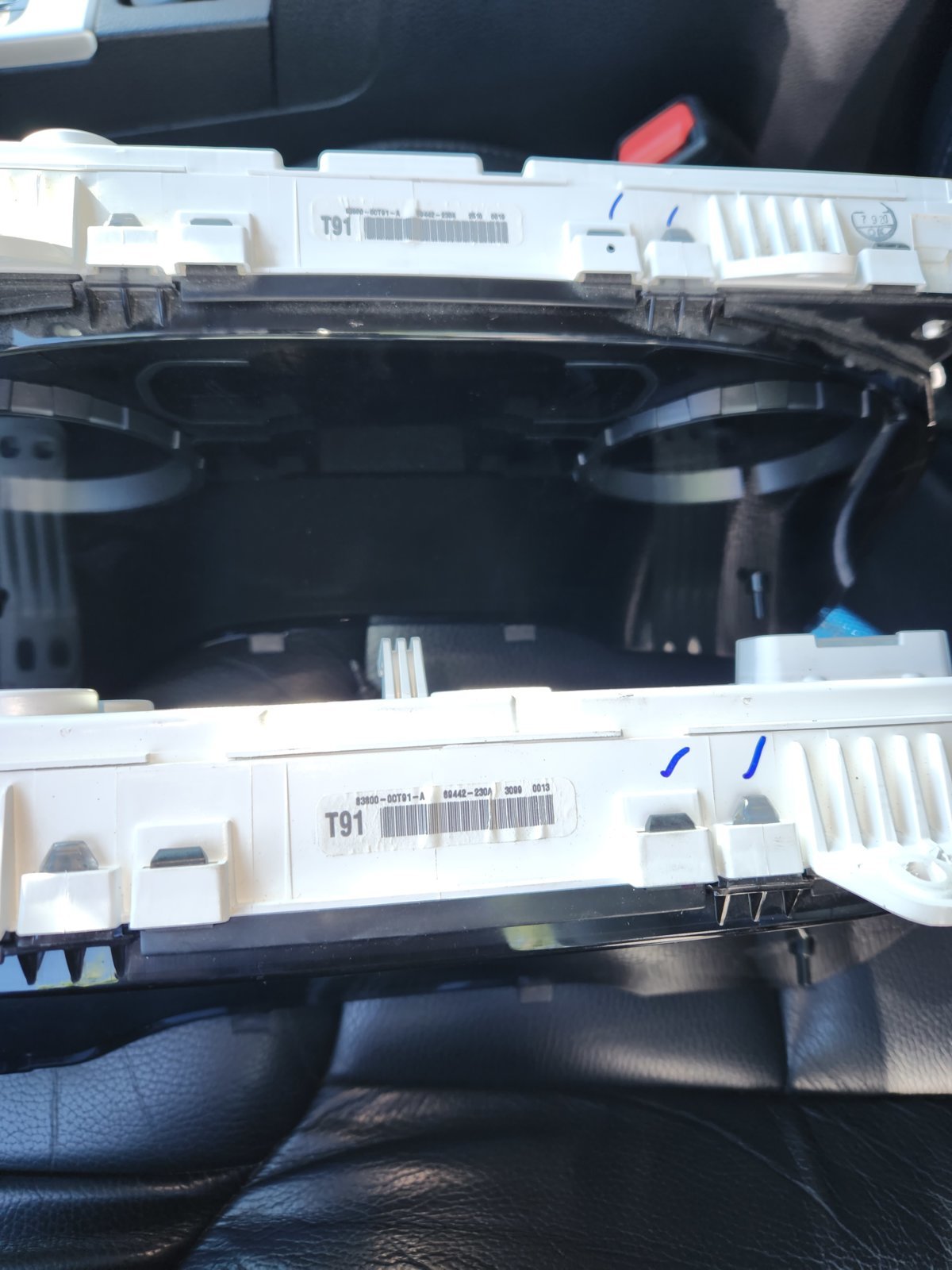

    my truck is the 2021 sport premium.
    Im trying to search other trims to see if I can see what options that cluster came in.

    New used cluster fixed the issue.
    Found a used part for $350 exact same part# and trailer right side is working properly again. decided to replace the 30amp fuse with a 15 amp fuse.maybe that will protect the circuit if I plug in to a shorted trailer.
