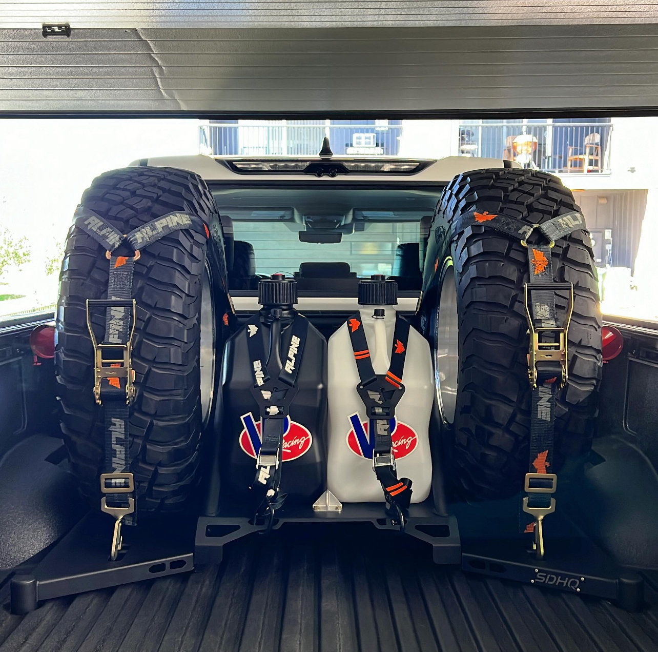

    Removed the tonneau to get the chase rack organized. Just need to wire up the lights and fill up the Powertank.

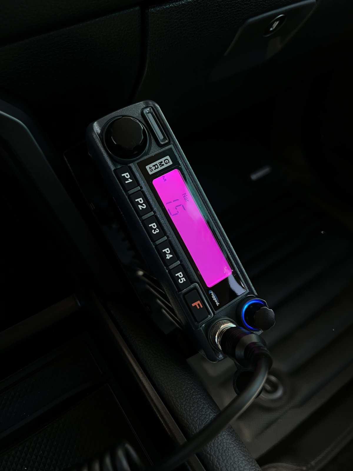

    Finally a good comms system after using two-way walkies for years and getting pissed off with the lack of range and clarity. Had to adapt the 2nd gen tundra kit to work on the 3rd gen but got it done.

    Looks great. Any particular reason you mounted the antenna lower than the cab roof?
    Also curious about your radio mount to the side of the console. Did you buy their seat bolt mount and have to mod it?

    Mounting on top of the cab would be ideal but without a built mount, the alternative is a magnetic base and running the cables out the window, which I don’t want to do. I’m waiting for a third brake light mount. The point 5 antenna works great for its size and doesn’t add additional height.
    I drilled a couple holes into the plastic console trim and added a plate for reinforcement. It’s sturdy and ain’t falling off. The included seat bracket doesn’t work for the 3rd gen but you can easily make it work. I didn’t pay enough attention when mocking up the seat mount bracket but it’s possible that it would place the box in the way of the glove box. Mounting it to the console as I did give you a couple mm clearance to open it.

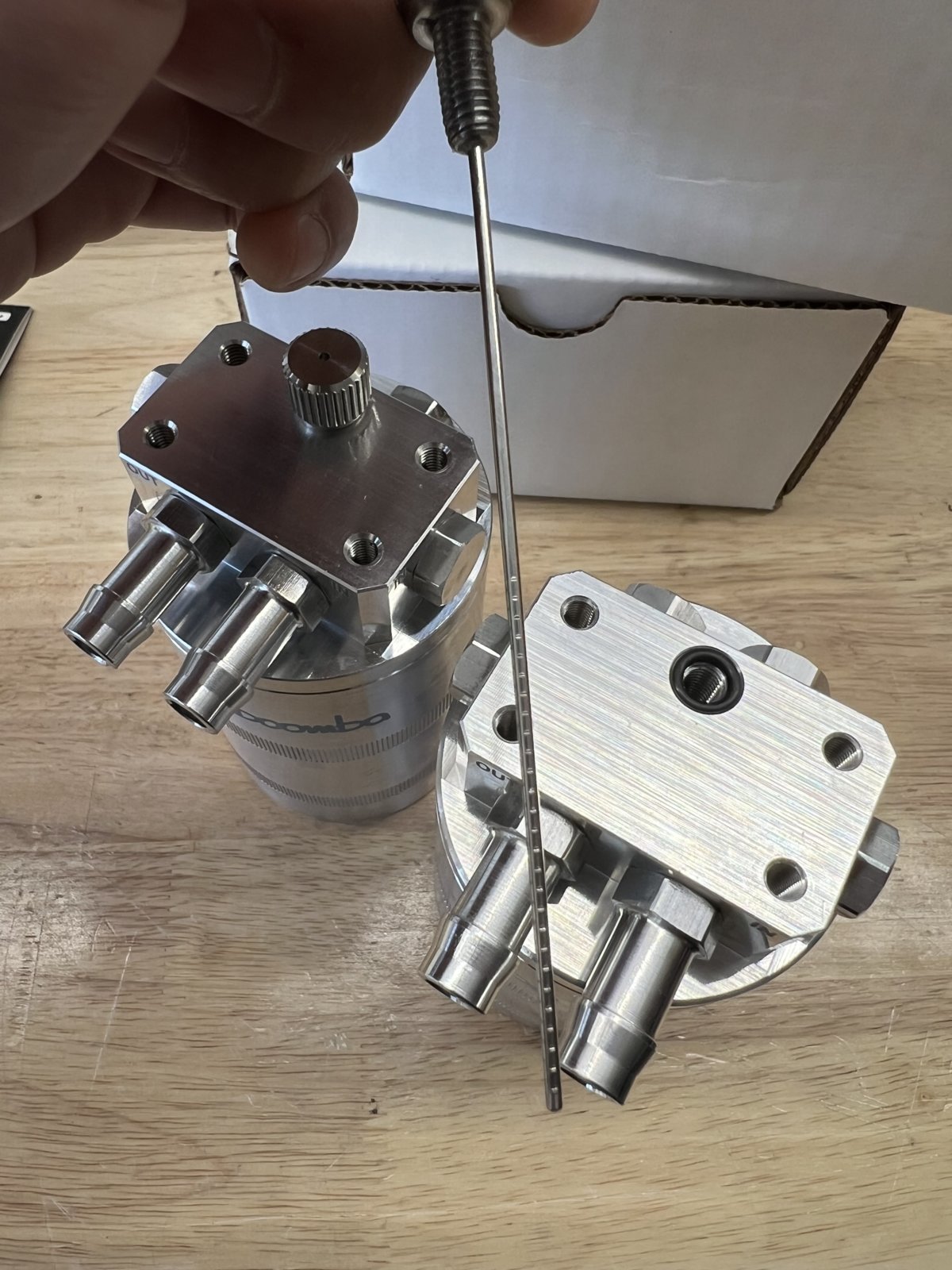

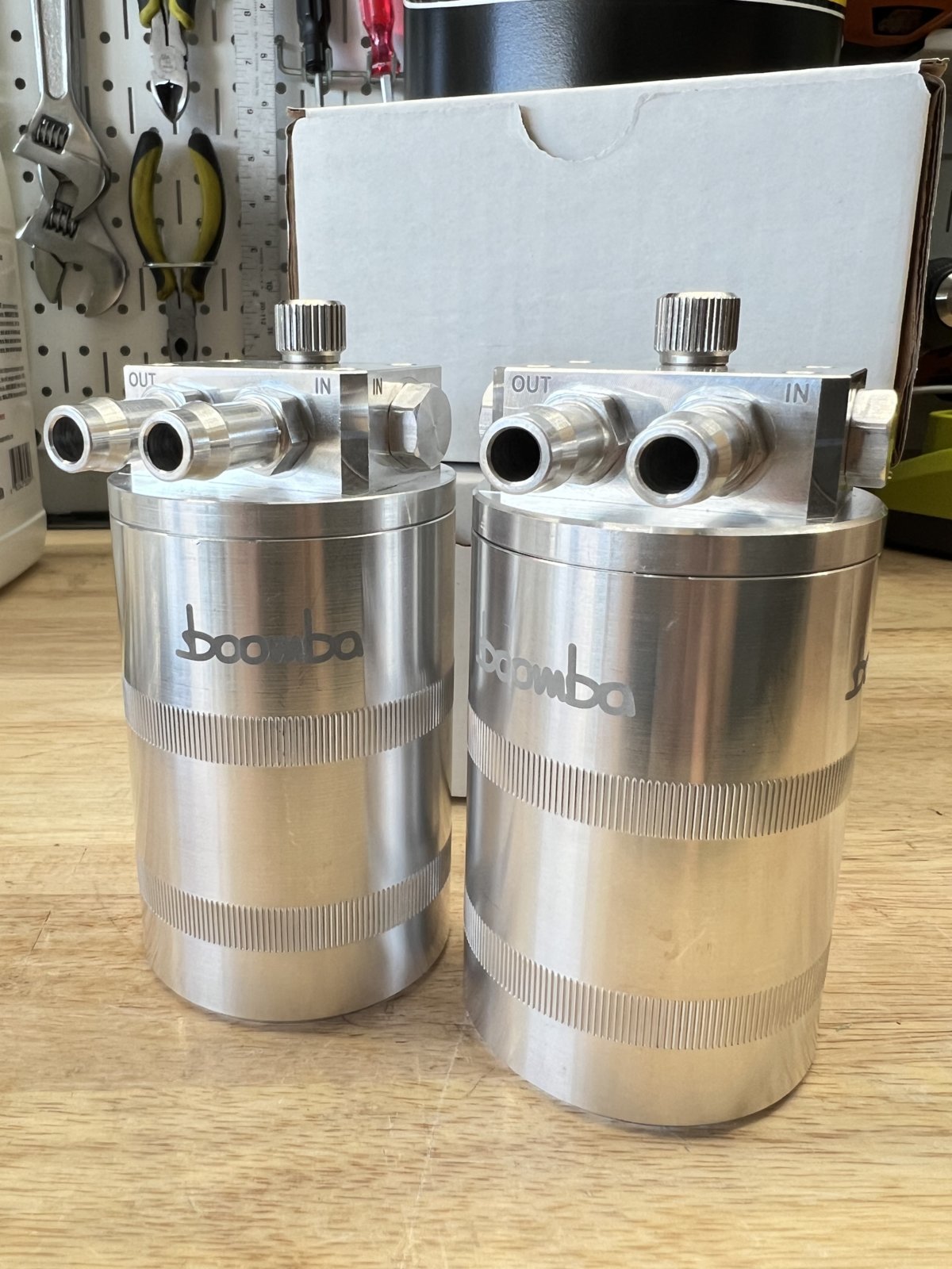

    More shiny machined metal parts? Yes, please! This dual oil catch kit arrived and I'll be taking the hour it should take to install this tomorrow. Nicely machined billet cans with integrated dip sticks. Nice touch!

    Catch cans in. I just surpassed 4K miles yesterday and really wasn't expecting to see much oil collecting inside the vent hoses. Driver side wasn't too bad - one or two drips as soon as I disconnected the hose. The passenger side was worse and the hose continued to weep oil while sitting on my work bench. It'll be interesting to see how much these collect.
