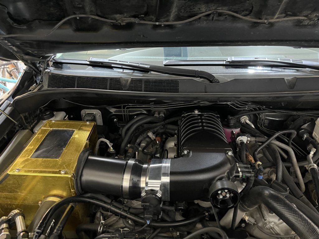

    The gold tape does work especially for my aluminum intake box. The accelerator does a good job sealing the fenderwell hole but an additional layer wouldn't hurt I imagine.

    Eibach Pro 2R, Dirt King UCA, 285/70/18 Toyo ATIII, Stillen TruPower CAI, OTT
    I ended up cutting the intake box just enough to be able to fit the accelerator+clamp to get a nice tight seal. @pvn.beluga was able to get his installed without any cutting but that's gonna be a real tight fit. Not sure what @Tundra234 did to his. I'm sure he'll chime in :thumbsup:
    If you decide to cut the box, just make sure you don't cut too much off to not be able to slide the accelerator on.

    @00h2itrYou’d want to install the accelerator onto the intake and then fold the accelerator into the fender well hole in order to not cut the box it self.

    I think you might be cutting both? Honestly, try to squeeze it in before you do any cutting.
    00h2itr[QUOTED] likes this.

    @pvn.beluga in this image, it looks like you didn't cut the intake, but only the accelerator, is that correct? And no hose clamp? Any feedback there?

    No, didn’t cut anything at all. Just push the accelerator all the way onto the intake hole.

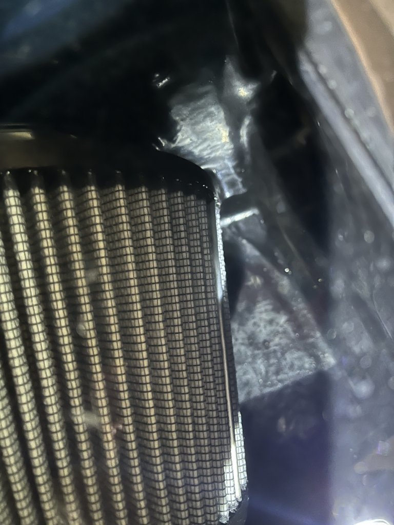

    So drove in my first rainstorm. Noticed a bit of water coming in the front tube into the box. Anyone else have this happen? Should I be concerned?

    Water in the box eh I would check the filter if it's wet.

    I haven't driven mine through heavy downpour, we don't get much here. Is it just droplets of water that came through or do you have a pool of water on the bottom?

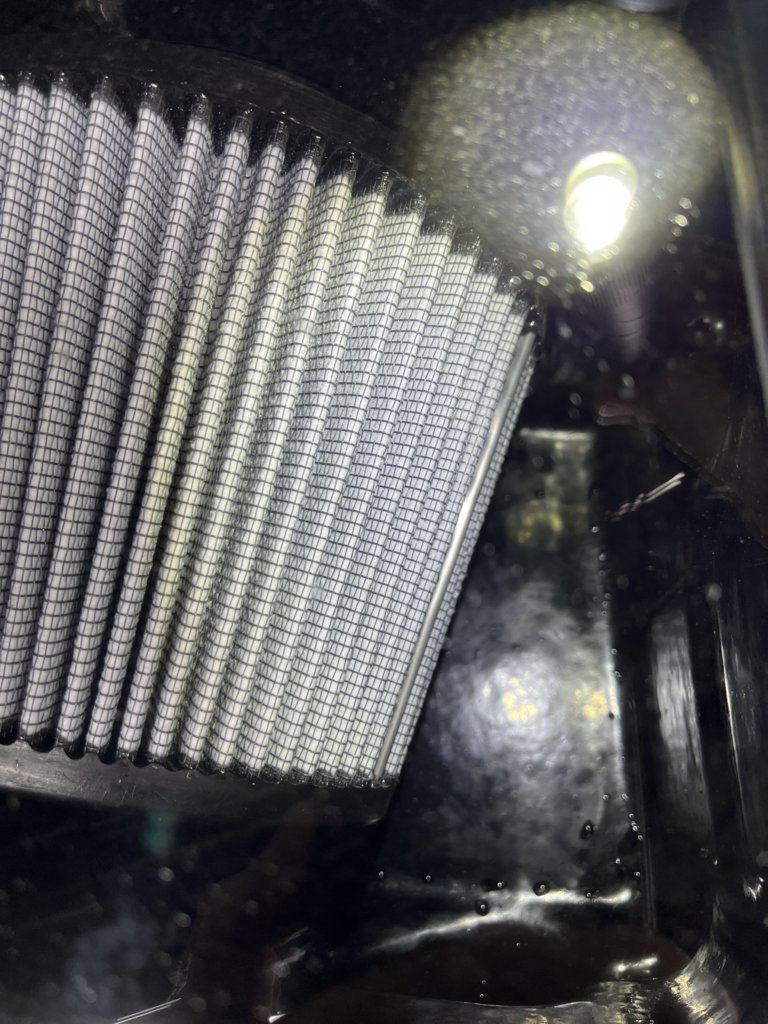

    No pool. A tiny bit in the front driver side corner. Looks like mostly water droplets coming in. Just went back to check it. Most of the drops dried up. All that was left was that corner. I can also see where some droplets splashed up onto the lid.

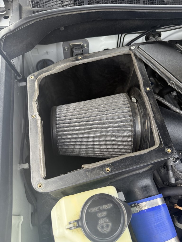

    Where did you get the dry filter for your Stillen? I'm leaning that way now PXL_20250711_204817123.jpg

    You can find one from AFE that fits that box

    I also got mine from AFE. I actually had mine custom made by them. I gave them the inlet size, the length, and the max diameter that would fit. They made it to the exact dimensions I requested.

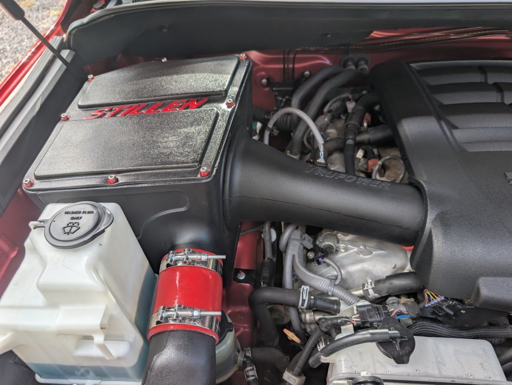

    Where did you get the red tube? I need to swap mine. I'm curious to see the difference between the oiled versus the dry filter. When I ordered mine, she recommended the oiled due to the humidity.

    Ordered off Amazon.Tube from box to air dam is 3" dia and tube from box to TB is 3.5" dia. Ordered new stainless clamps too

    Thanks. I saw the clamps.....nice!

    Dry for less oil to potentially get on the maf
