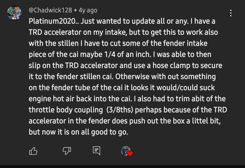

    I wasn't sure where I had seen the comment about the accelerator with this CAI. It looks like it was in the comments section of the YT video from Nitro...
    So I may have to give this a shot someday. Don't know if it's a huge game changer but ehh, I wanna put my accelerator to good use.

    I thought about this too.

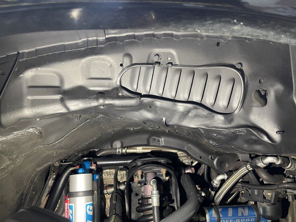

    I was thinking that the intake tube through the fender well might be sticking out slightly further.
    @reywcms Did you do anything to the intake tube for the fender well?

    My setup is different there since my suspension and airbox are different etc. Let me snag a pic

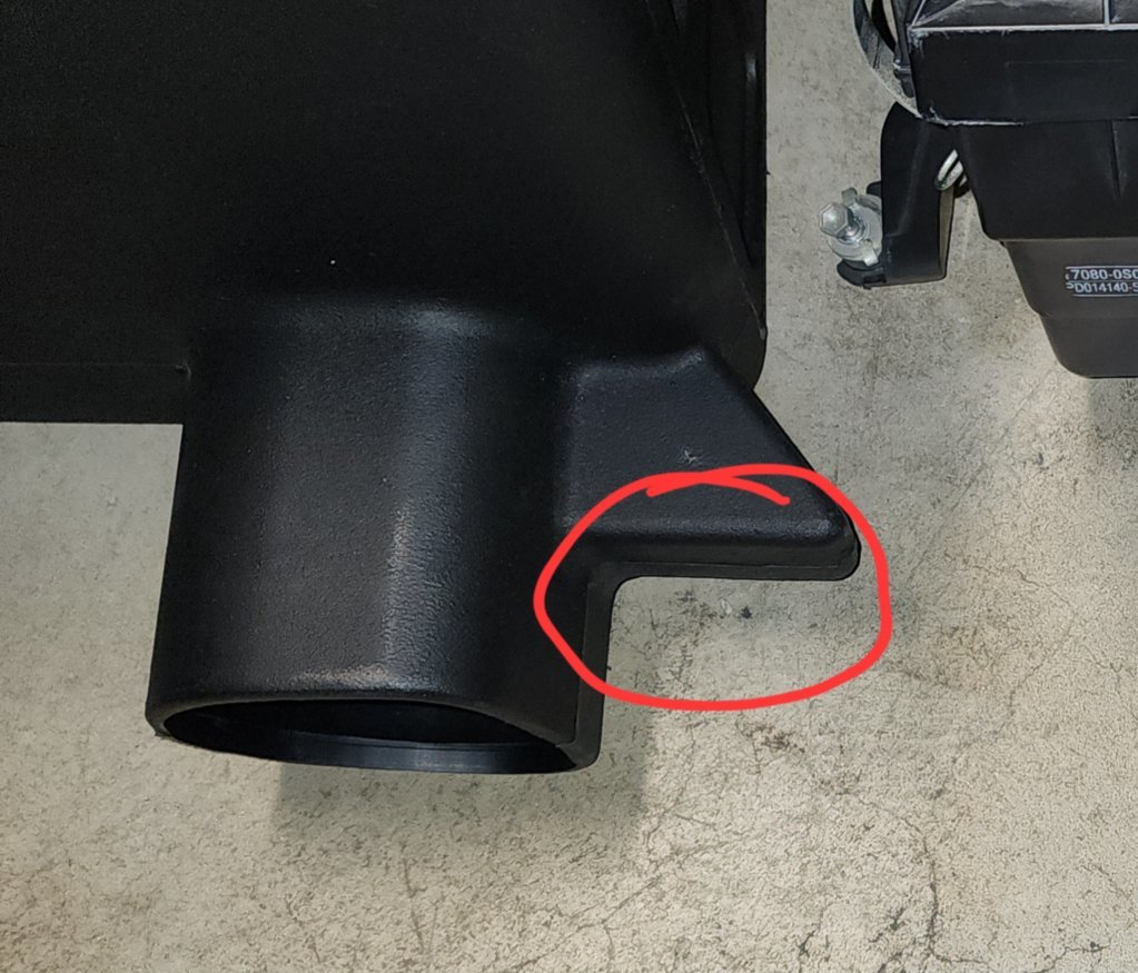

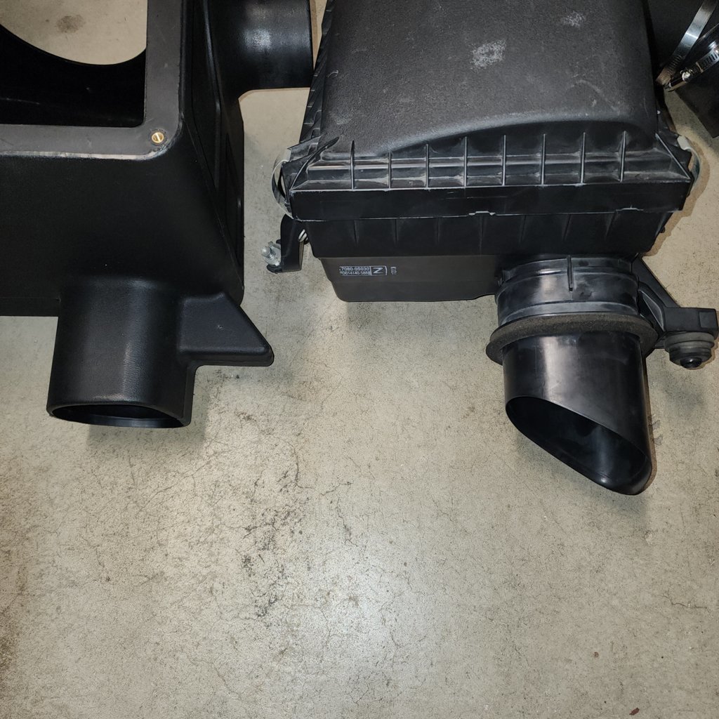

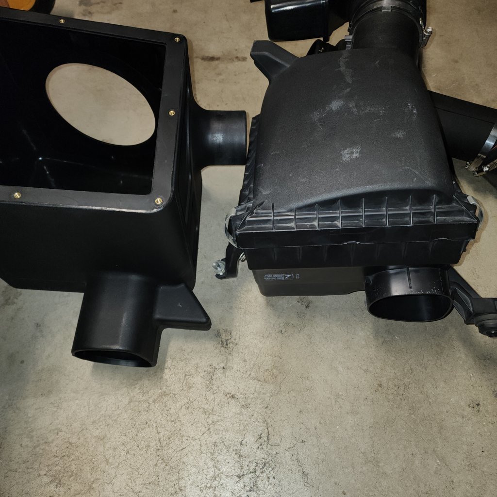

    Well I took my Stillen off just to inspect the fender air inlet where the accelerator would mount on the Stillen box and it looks like Stillen makes theirs long enough to eliminate the entire piece that clips onto the stock box.
    So I can see now why there would be a need to cut the Stillen air inlet down enough to fit the accelerator.

    @pvn.beluga have you already opened your kit up?
    Do you have the nipple on your box that's supposed to be here...
    It's a bummer that corner piece is hollow otherwise I'd cut that whole corner piece off to allow me to cut the inlet further down.

    Not yet actually, I’ll be opening it up this weekend. But I did see that where they’ve eliminated that nipple to add in the 3rd bushing from the OEM.
    In @2020Platinum video, it shows that his model does have that additional nipple.

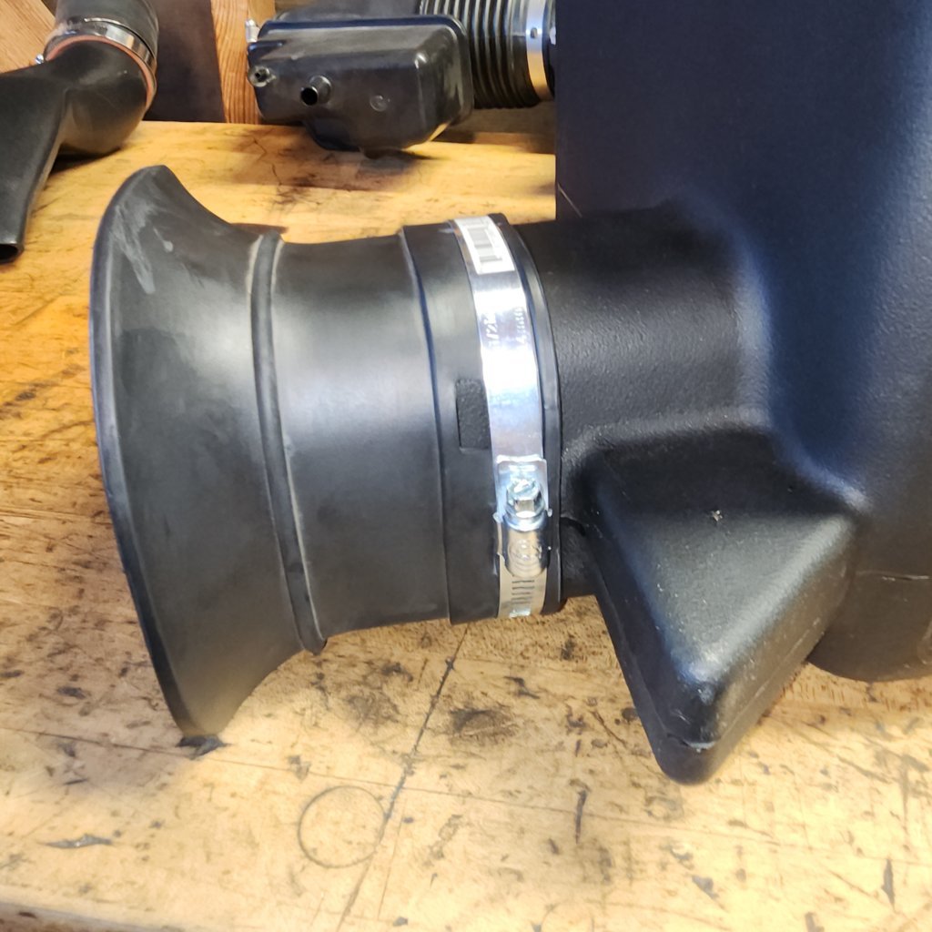

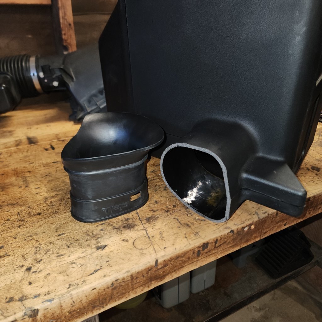

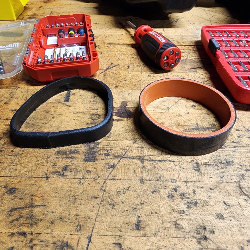

    Finally got around to modifying my Stillen box to allow for using my TRD accelerator with it. Don't really know if there's a huge gain from it but I didn't want it to go to waste. So now I know that it is possible :bananadance:

    How much did you cut off? Used a sawzall? Dremel? Oscillating multi tool?

    I cut about 3/4 inch off the box and 1 inch off the throttle body coupling.
    Yeah I used a sawzall on the box and sanded it down just to get a smooth surface.
    Here's an idea of what I cut...
