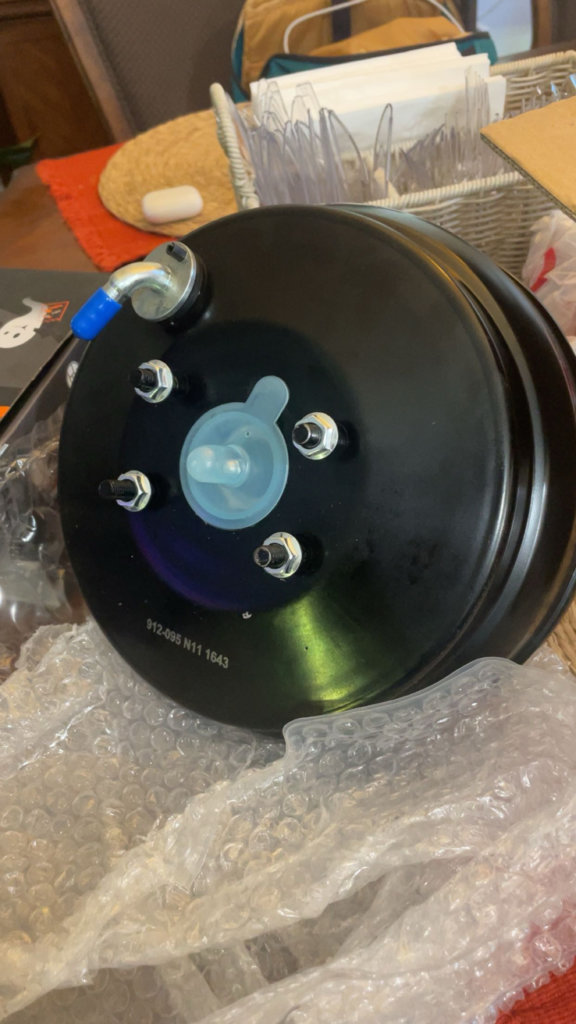

    Another option is to do the T-100 booster/ MC upgrade instead. Can source some of these parts from a junkyard or aftermarket on RockAuto
    https://www.tundras.com/threads/t100-brake-booster-upgrade.86375/
  3. Sep 27, 2024 at 6:57 PM

    Was looking at that and I think I'm going to pull the trigger on that. Knock two birds out with one stone sort of deal with fixing my current problem and fixing the spongy weak brakes problem. It's also a lot more cost effective than buying from Rock Auto.
    Is there a specific MC I need to work with that specific booster or can I just go with an OEM one from EBay? The link to the MC on the writeup doesn't exist anymore. I'm currently getting the Centric MC I listed since they're pretty reputable from what I've read, but if I need to swap them out I'll just return it.
    I might even just return the Centric MC off the bat though and buy off EBay or Junkyard. Not sure exactly what I want to do just yet but need to get the parts shipped since I now have to make some trips to and from college to fix my truck lol

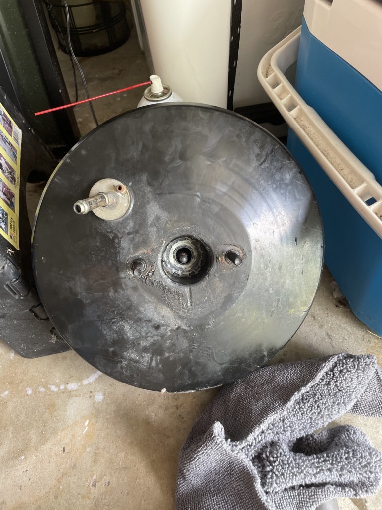

    The Brake Booster wasn’t apart of the problem, but my pedal was pretty unresponsive before I got around to bleeding the brakes and the brake booster might’ve had something to do with it. It looks like it’s rotting a bit from the inside too from probably a little fluid from the MC, but nothing serious enough to be concerned of failure.
    I’m gonna keep the booster and grab a junkyard MC just in case the upgrade doesn’t work out, or just keep the MC I ordered already.

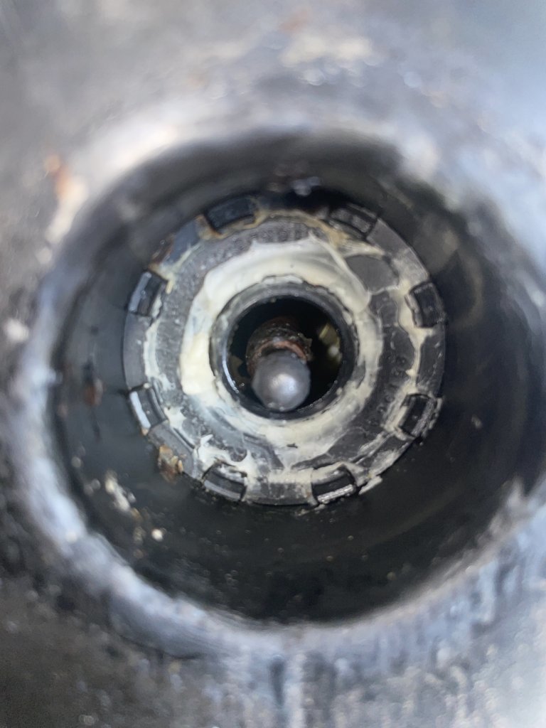

    That looks like the seal for the pushrod with the OEM grease, not necessarily leaking brake fluid? There is a baffle inside that assists the pedal that have found really can't be inspected well without opening them up but not done that if it holds vacuum.

    Not talking about the white grease but the rust around the push rod. Its not really the best picture but there’s rust all over it
    I’ve already ordered the parts, so that brake booster and a junkyard MC will be my backup if I can’t get the T100 upgrade to work. I just need to have multiple options in the table to get the truck working since we don’t have an extra car

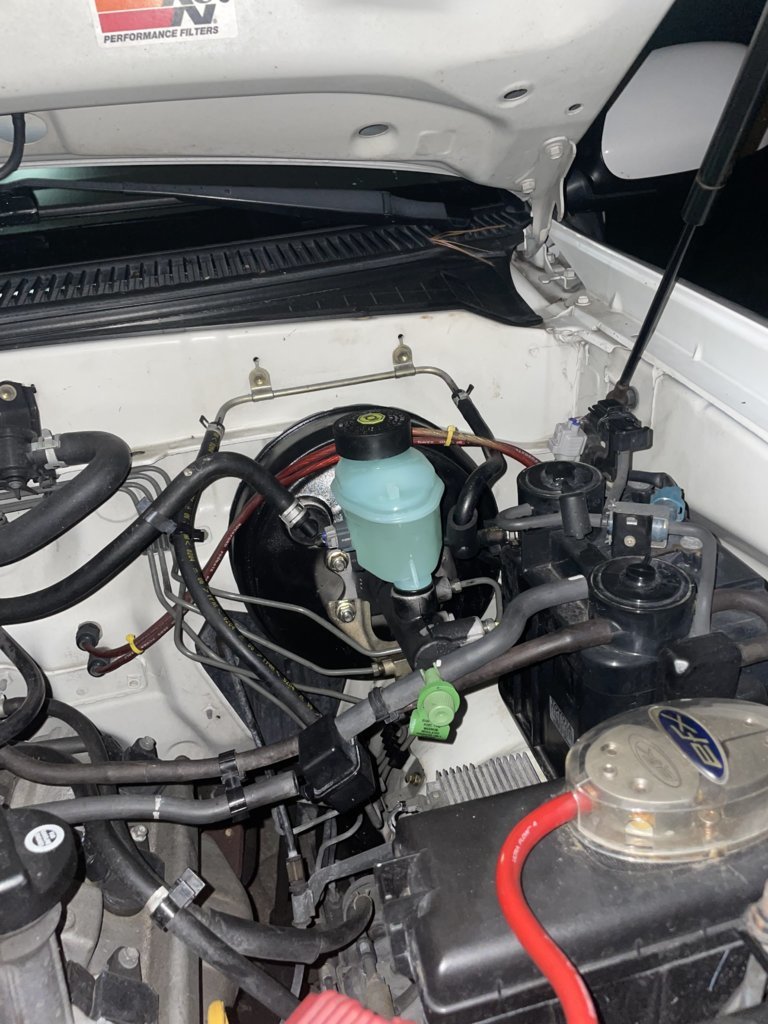

    Yippie, we got braking again! I did the T100 Brake Booster/1 Inch MC Upgrade and it went very well!
    However, my pedal is very stiff, like so stiff that it's very difficult to press down to even shift into different gears. I'm assuming is because I didn't install the master cylinder and brake booster gaskets. Either that, or I have a faulty part or vacuum leak. Let me know if you guys can think of any other ideas of why pedal is stiff or what I can test for, or if this is pretty normal with the upgrade.
    And yes, I do see the disconnected vacuum line to the evap box as I write this post so I'll let you know if that was the issue (UPDATE: This was not the issue)

    Sounds like you have no vaccuum.

    Or insufficient vacuum, maybe because more vacuum is required for that booster design.

    May be, I just did a two of booster tests and its passed them.
    Vehicle off pump the brakes until hard then turn the car on, pedal drops slightly.
    Vehicle on for a couple of minutes, push down on brake and shut the car off, brake assist shouldn’t let the master cylinder kick back and press the pedal back in for at least 30 seconds. Passed that one.
    only thing I noticed that had a vacuum loss was when I pushed down on the check valve it hissed some, but I’m assuming that’s normal since I’m removing gasket seal from the check valve to the brake booster.
    I don’t have any kinks in my brake lines and everything bled fine. I can’t imagine it being anything other than the brake booster which seems good.
    braking power is the exact same as expected, just have a really firm pedal now.
    I hope the insufficient vacuum isn’t the case since I don’t see a solution to that problem (let me know if there is). The OP of the original upgrade forum never stated having this issue, though the conclusion after install wasn’t well documented.
