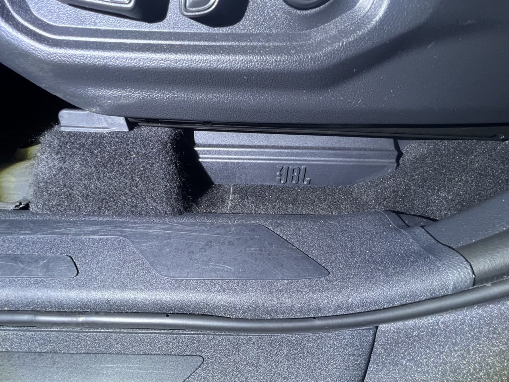

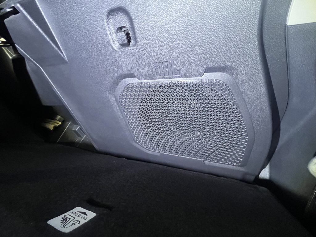

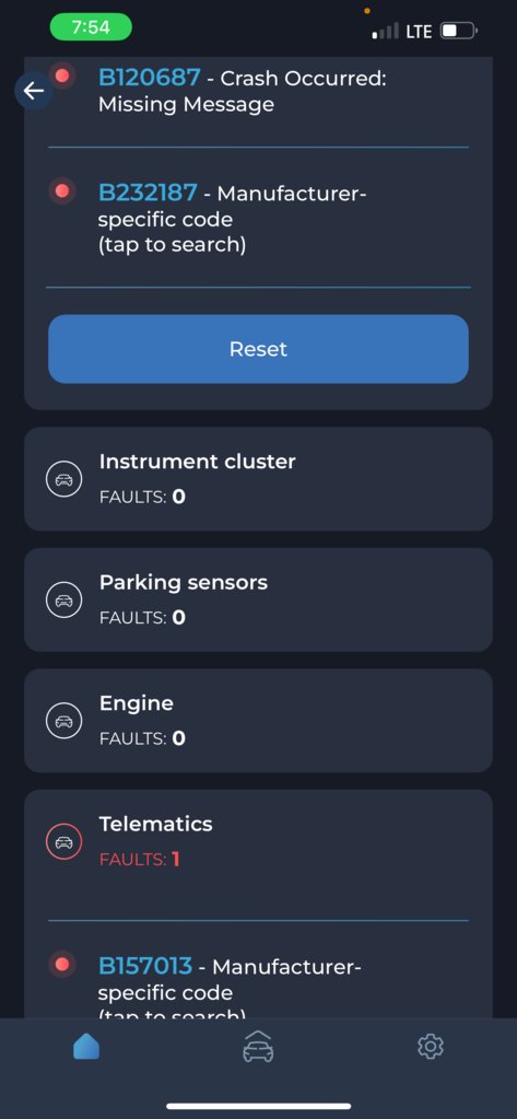

    Nothing there for the sounds. Here it is.

    Probably a long shot, but maybe delete the Carista app and reinstall? Maybe there was a glitch when you originally downloaded it. Also, your dealer can turn it off too, so maybe ask them if the can or can't see the option.

    That’s a good question. I don’t recall selecting a vehicle. I just hit connect. I saw where the seat belt dinger was disabled for all 5 seats. It definitely connects and should know what it is connected to.

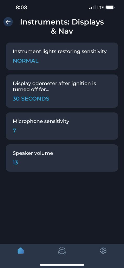

    I didn’t see where to select a vehicle in the Carista app when I just opened it. I did see where to report an issue and just did.

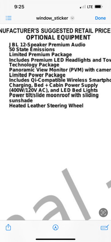

    Here is a snip from my Monroney sheet showing the JBL premium sound system.

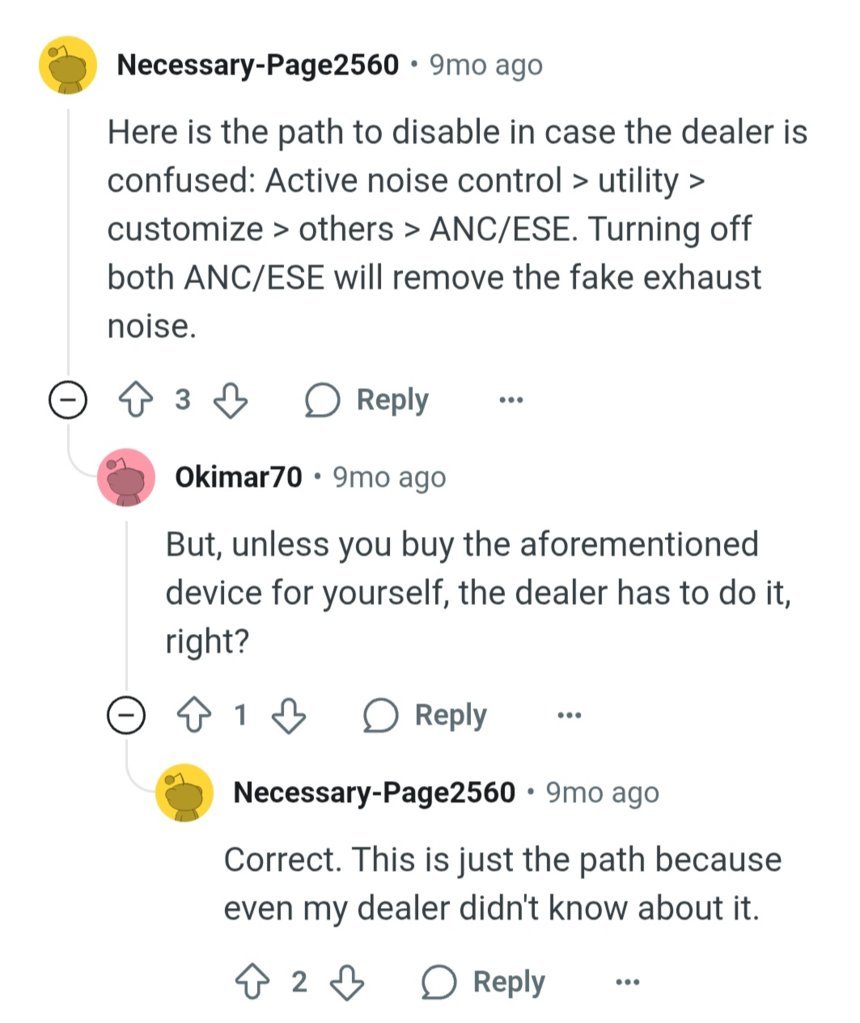

    Quit calling it "fake v8 sounds" because they are right, Toyota doesn't have that. Ask them about enhanced engine soundand see if they know what you are talking about.
    Go use Google, pull up articles from auto mags that talk about it to show them.

    Show them this. Tell them to hook up tech stream and check it.

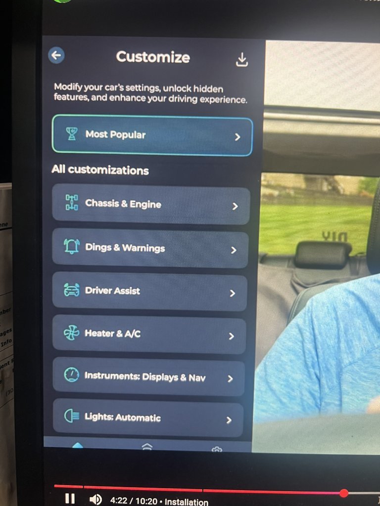

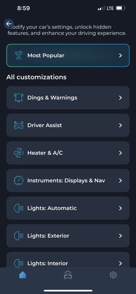

    Look at my options in Carista for customize. From the top is most popular, then dings and warnings etc etc. Now look at the video example, it has most popular, then engine & chassis and then dings & warnings. I AM in the correct area, I just don’t have that option where the ANC and the ESE is at to be controlled.
