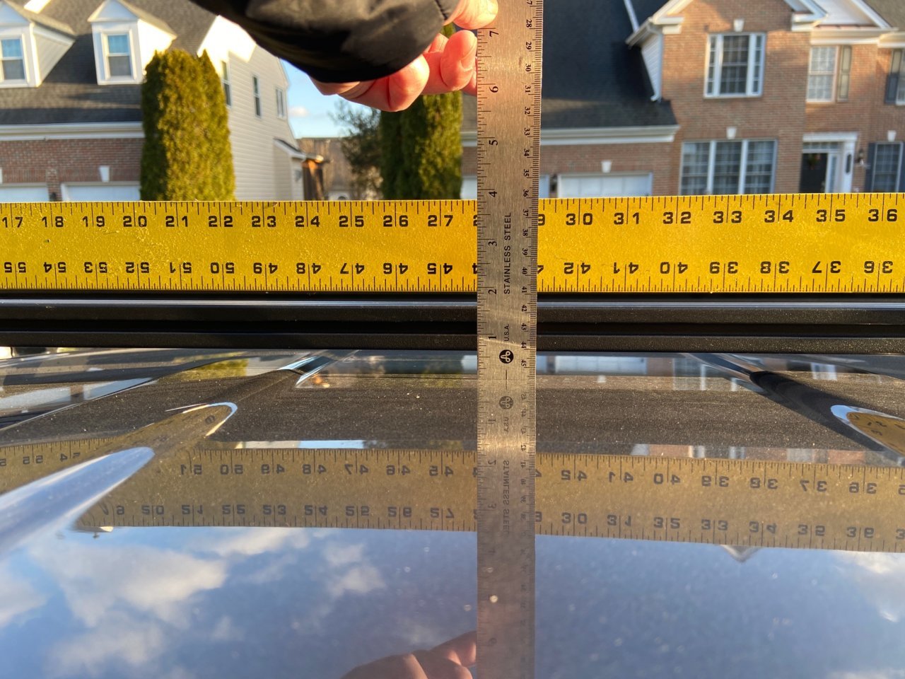

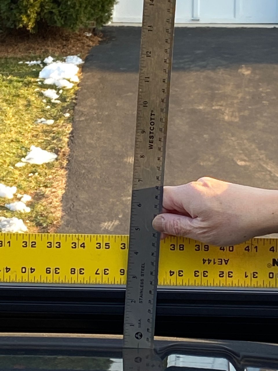

    The cab at the highest point seems to be the rear near the brake light. I have a double cab so it may be different in measurements vs a crew max. The 3 pictures start at the rear and move forward. I took a straight edge and laid it on top of the side panels going across from left to right. Measurements are at the center of the cab. Looks like 2.5" at the rear, 2" inches in the middle and 2.5" at the front.

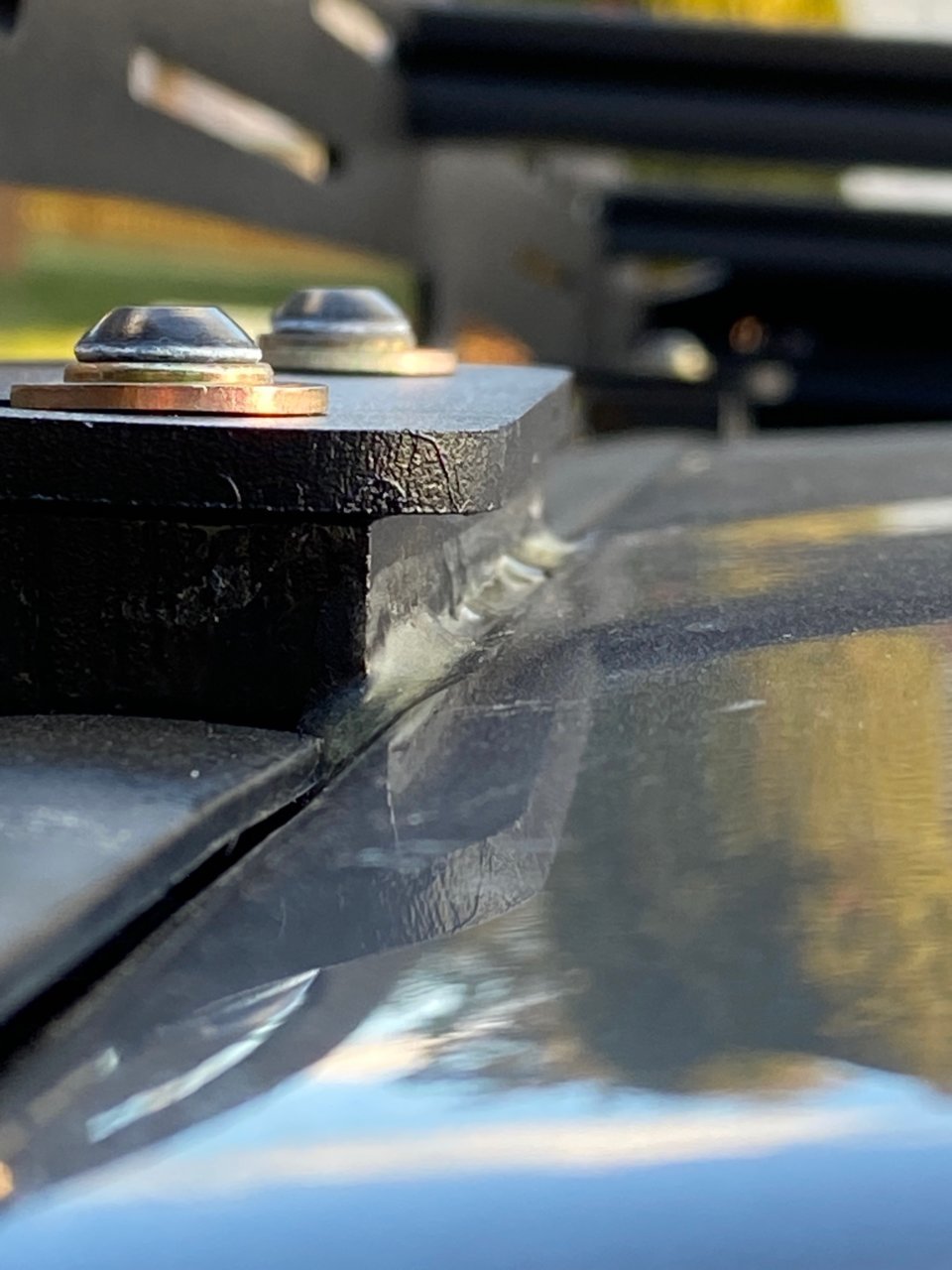

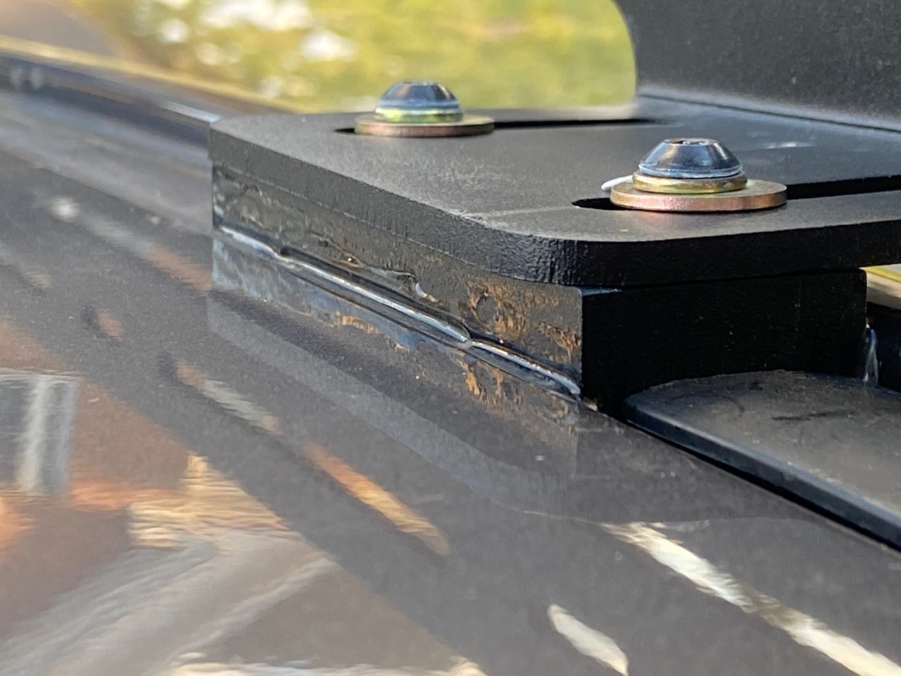

    2. The Devcon 2 ton epoxy is no joke and for those who buy this rack, you have about an 8 - 12 minute working time. By 8 mins, it starts to set. If you've never worked with epoxy, get a lint free towel or shop towels and soak it with alcohol to wipe up the excess. I bought extra epoxy online cuz I went back and created "fillets" to fill in the gaps on the sides/edges. You should definitely watch the video of him installing it as you'll notice how much epoxy he used in the drip well. You can tell he used quite a bit to put in the bottom of the drip well but not as much filling in the edges (at time point 1:43). I attached pix of my blocks with the "fillets" I added afterwards.

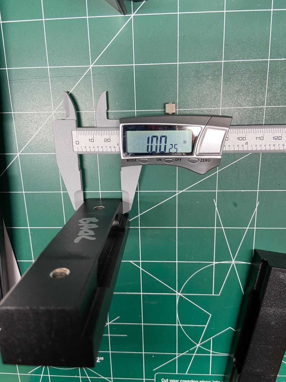

    3. Test fit your blocks. I found that with my 2016 DC, the passenger side drip well was about a solid 1mm wider and the blocks would not work on that side. I was able to lay the blocks into the drip well all the way and then slide them front to back which was not good. I called Tiger and he was happy to resolve the issue and sent me 3 blocks which were wider that he had...all worked fine when I installed them. I'll include some pix of the blocks that were not wide enough compared to the one that were.

    Here are some photos where unfortunately the passenger side drip well was apparently approx 1mm wider than the driver's side. 1st photo is the passenger side where you can see the mount almost dropping in, whereas the second photo on the driver's side where the mount is at a higher angle. On the driver's side, it took like 3 hits with an armorer's mallet to hammer them in each. Like I mentioned above, after many measurements and speaking/texting Tiger on the phone, he was happy to send me new blocks which were wider and all worked out well.

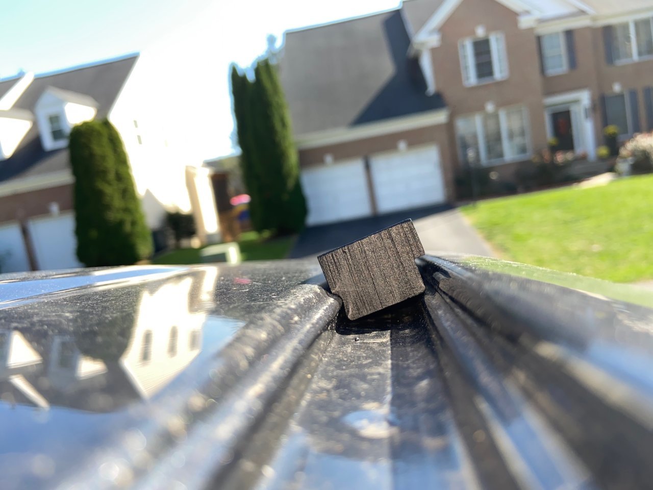

    On another note, if your blocks have a hole drilled all the way through to the bottom and out the other end (3rd picture), be careful...with the epoxy in the drip well...when I hammered it in, the epoxy shot up through the hole. I had to find a pipe cleaner and soaked it with alcohol and swab the threads to dissolve the epoxy.
